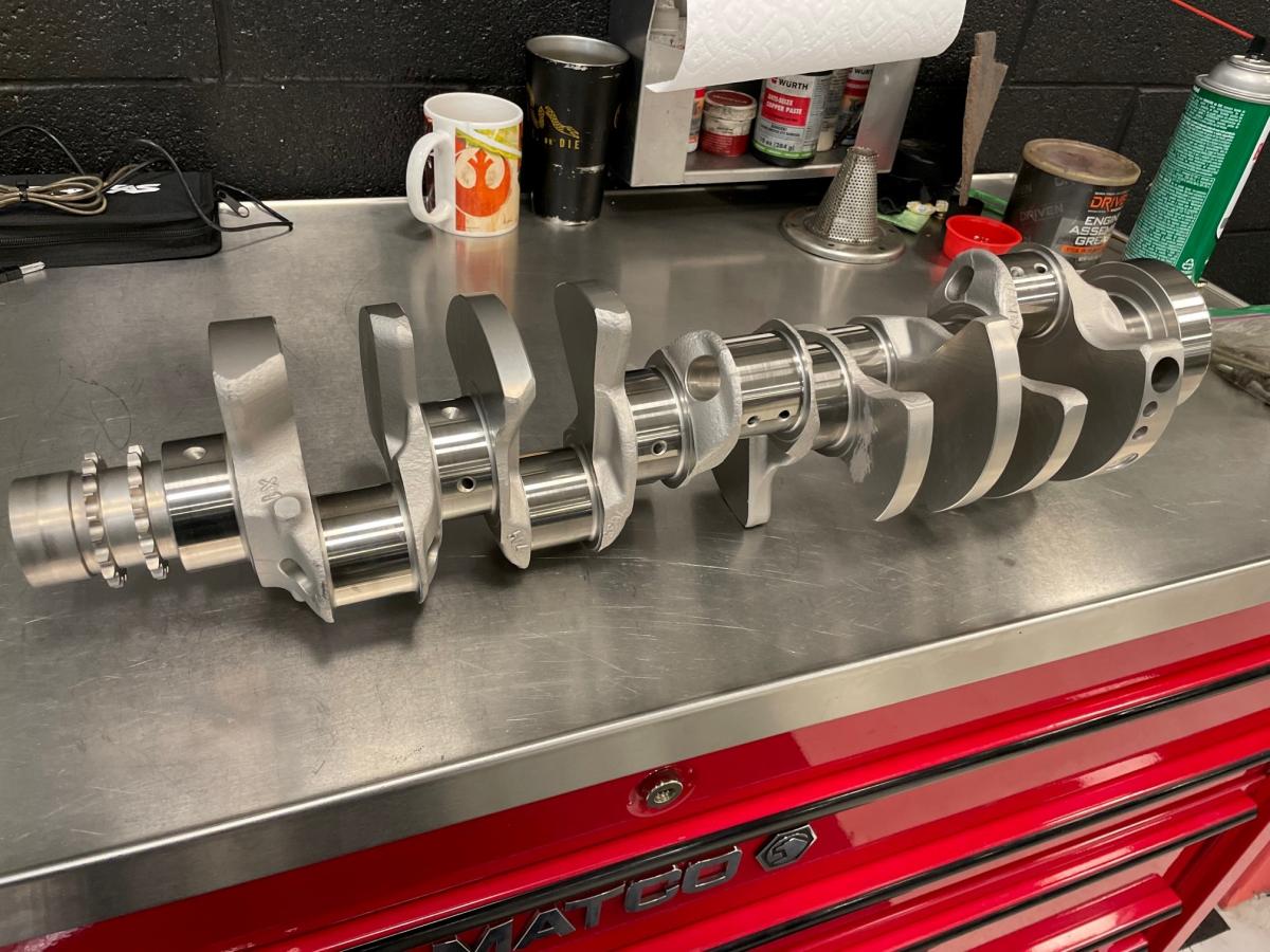

                            I'd inspect and, based on what is found, replace some combination of bearings, crank, and the rod that spun. Personally, I'd just buy a new OE BMW crank (in fact, I recently did, for my s85) if yours in damaged-- regrinds and used are too much of a roll of a dice for the money actually saved.
                            Option 3 is going to result in no meaningful gains and the car being a PITA the rest of the time you own it.
                            My nice, fresh, OE BMW (S85) crank, from when recently presented with the same dilemma:
                              #44
                              They grind the corners at the journal meets the crank throw to a round radius to avoid stress-riser leading to crack. Don't see that on older cars.
