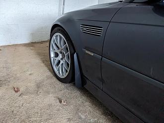

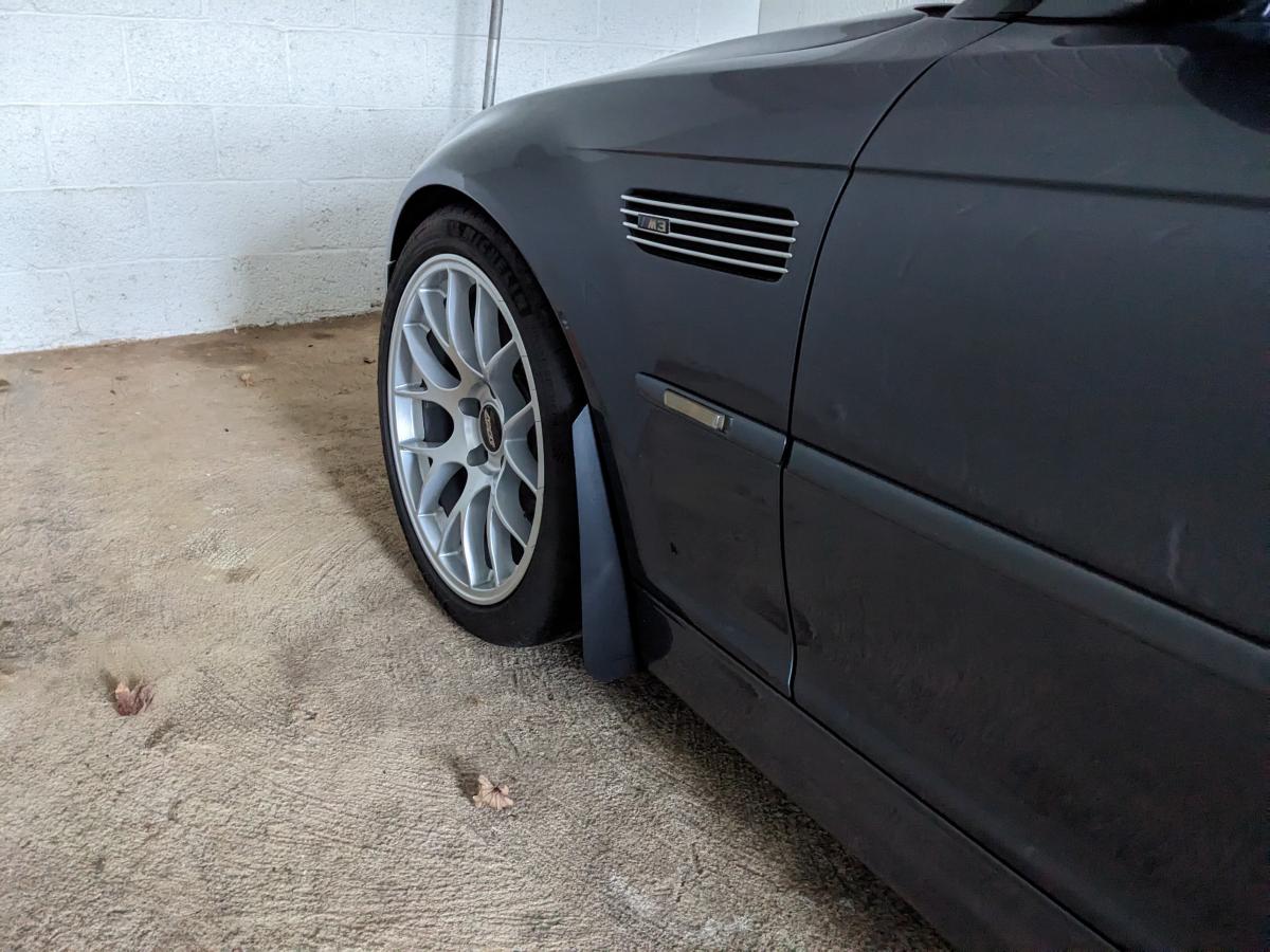

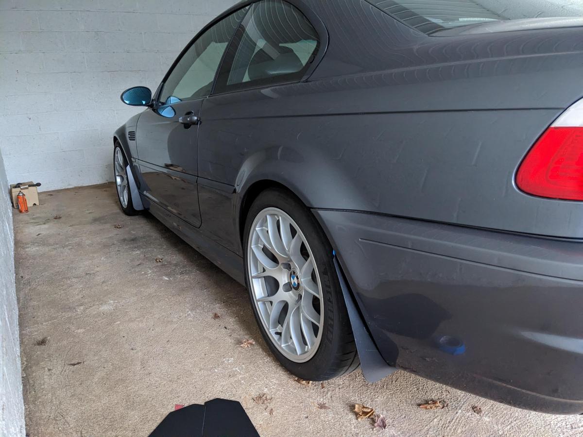

    Also here are some pictures of some generic mud flaps mocked up with masking tape. The lighting is making them appear more gray than they really are, they're black. I could also probably tuck them in more, but I don't know the guidance for how far out they should/shouldn't poke.

            Thanks for the inputs y'all. Honestly it's not even the track day itself that has me concerned, I've just been rocking those naked anyway, but the ideas here are definitely noted.
            I'm more concerned that I'll now be doing long highway drives to the track with stickier tires, and trying to evaluate if there's something cheap I can do to mitigate some of the damage there.
            If the paint was mint I'd be more willing to investigate the PPF route, but I don't want to spend thousands to cover paint that's already got chips in it. The front bumper and hood will need a respray at some point, and maybe then I'll evaluate PPF for those sections. My main areas of concern are below the beltline trim on the doors from the front wheels back. I'm 50/50 on just getting a roll of Scotchgard and attempting a DIY on each side to see how I end up.

                    Yea it's unfortunate that there aren't great mounting points as-is. I was looking at maybe putting plastic rivet nuts into the fender liners as a way to bolt the flaps on.
                      I run Rally Armor on my STI---nothing on the M3. I feel your pain and concern. Way back, BMW did offer a factory mudflap for these cars, but NLA.
                        I bought a pair of small plain plastic mudflaps from a local auto parts and trimmed them to the front distal wheel wells.
                        I used the three pushpin fasteners by inserting the flap between the fender and the inner wheel arch panels.
                        It looks goofy but 265/35/18 on ET 22 9.5 looks naff by itself.
                        I'm looking at Porsche 930 style decals, bmw decals and M2 carbon fiber front flaps.

                            You might consider figuring out a mounting method for these flaps just for track transit that can be easily removed once at the track via zip ties or a small riv nut or plastic clip in the fender liner. Reusable and then you don't have to mess around with films
