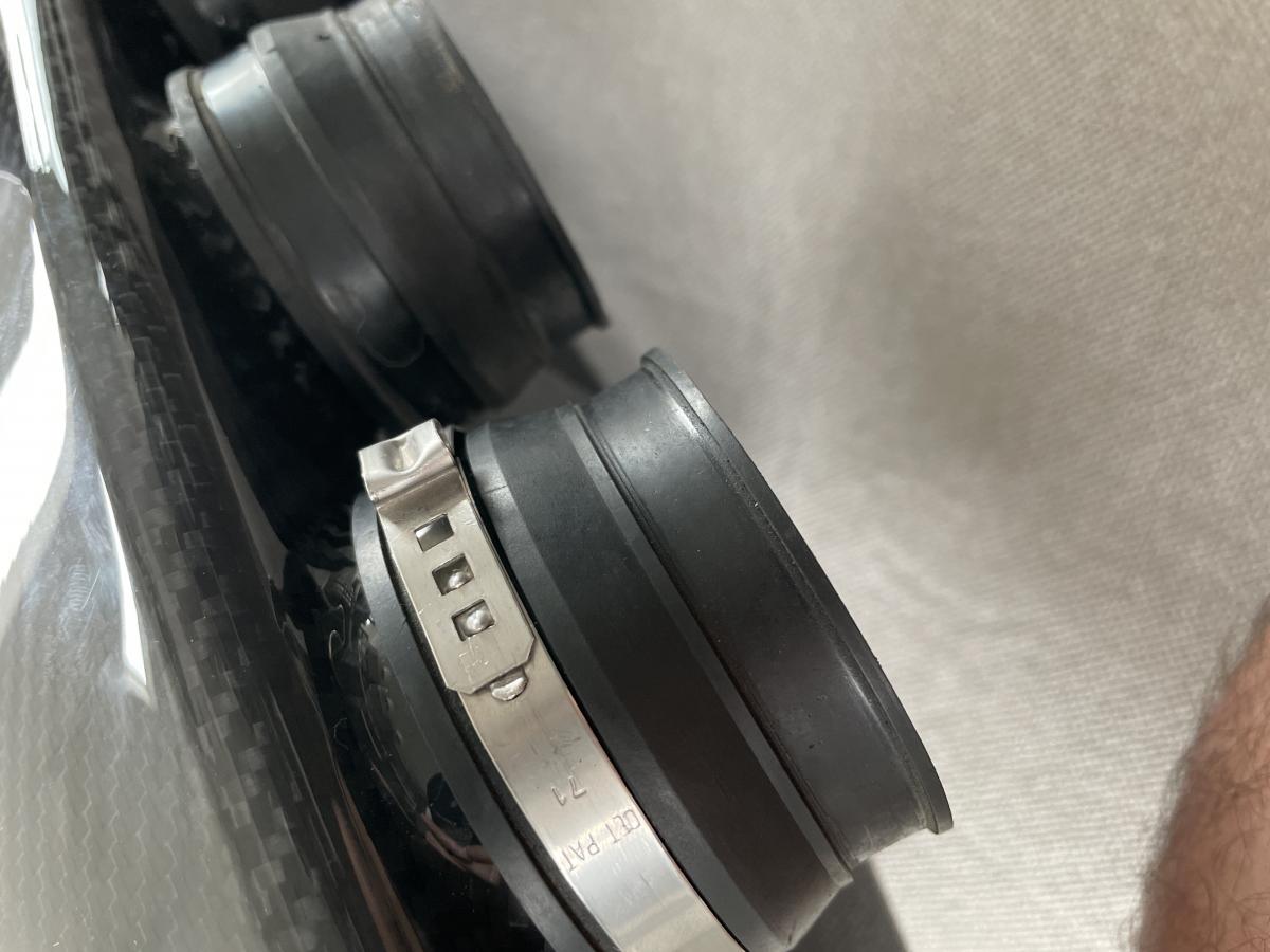

        btw how in the world are the throttle body boots clamps on the airbox side supposed to be reused? Ive tried flattening the ear on them to get them to wrap to their original position with no luck. Are they ok to reuse with the next up position?

          You need the 01-04 boots, or these:
          https://www.turnermotorsport.com/p-5...t-with-clamps/

            Those are one-time use clamps. Aesthetically, the ear of those clamps should be facing downward if you are using an angled ear clamp tool. You'll need to order new ones or you can use NORMA 50-70mm screw clamps which are reusable. Be careful not to overtighten the screw clamps.
              technically they're one-time use clamps but I've been reusing them. I bend them out so they're "square" rather than pinched in at the bottom. I used dikes/diagonal cutters and carefully pinched them to tighten them. Now I bought the proper tool to pinch them .

                technically they're one-time use clamps but I've reused them before. I've bent them out so they're "square" rather than pinched in at the bottom. I then used dikes/diagonal cutters and carefully pinched them to tighten them. I later bought the proper tool to pinch them .

                Have reused them before, used the wrong tool, worked fine. Eventually bought new ones and installed with the right tool

                  Dang- i ended up just ordering new ones- couldnt get them squared up to save my life
                    Those clamps are a giant pain in the dick. There are some alternatives people use that are easier and multi use, but I don't have those handy. It's gotta be a specific size. Maybe someone else can chime in on that.

                      I dont have the patience to try and get those clamps on, I even bought the tool, I'm apparently not qualified. Shit I ran with just zip ties for a while and no noticeable issue....though I'm not advising it
