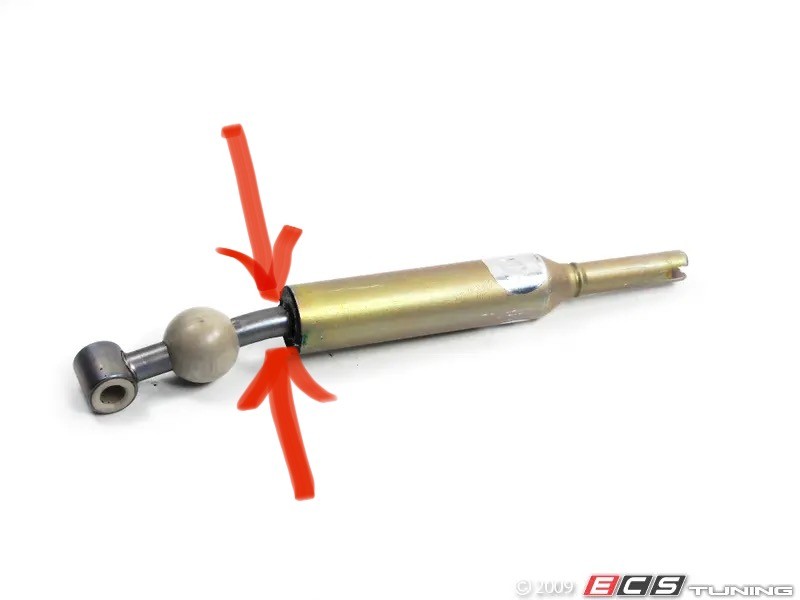

    Background: The OEM shifter is a bit rubbery, as most I’m sure are aware. If you pull your leather shift boot up and grab the base of your shifter, so that your thumb or finger is on the thin metal shaft under the thick shaft, then wiggle your shifter, you’ll feel pretty significant motion between the two major parts of the lever. Most of that rubbery feeling comes from the motion at that joint, as far as I can tell.
    Solution: I like the damped feel of some rubber, and the autosolutions setups are just a bit too ‘direct’ for me, so I thought I might be able to make the stock shifter feel firmer with a simple mod. But I need one dimension before I can do that.
    The ask: Can I get some help to measure this diameter? It appears to be about 10mm, but an actual measurement is what I need.

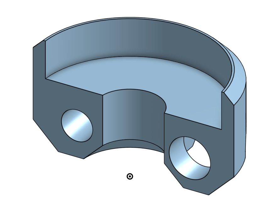

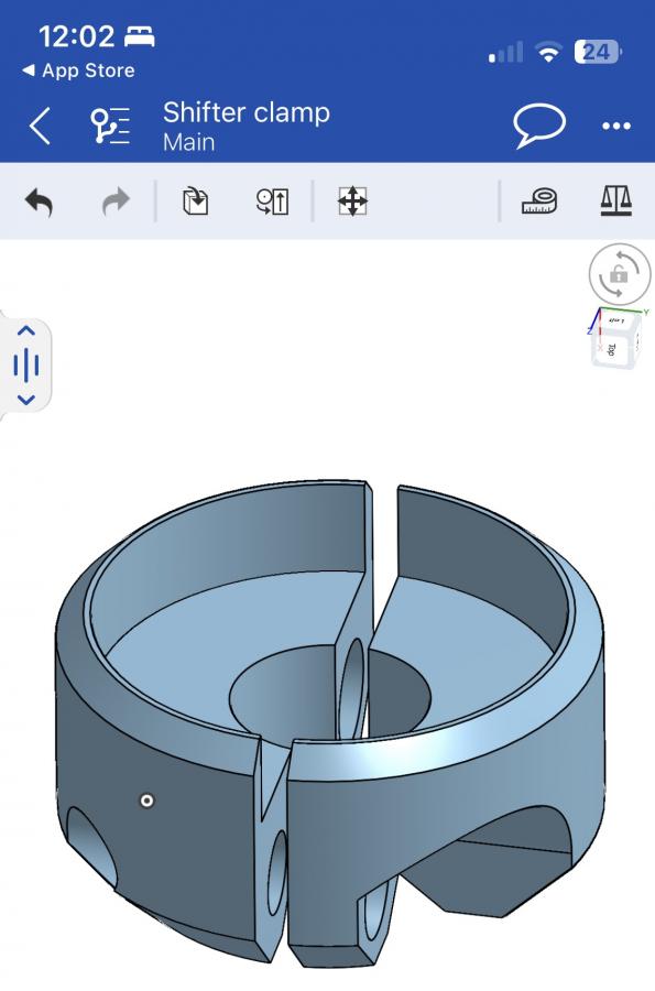

    I’m trying to make a clamp that locks both parts of the shifter together:
    Click image for larger version  Name:	FE927168-9AB3-4358-97D7-AA751A1FFBD4.png Views:	0 Size:	100.4 KB ID:	205235 Click image for larger version  Name:	BAF8A278-CC3F-4331-8E76-5A528FFAA6EA.png Views:	0 Size:	96.1 KB ID:	205236
    11.80 mm for a stock shifter produced in 2002. The diameter above that is 27.75 mm if needed.
      Awesome, thank you. Mine measured 28.13 so it looks like I’ll be going with 28 for the large OD.
      And thanks for that super quick reply!

                          I’ve driven cars with a solid shift lever but otherwise stock mechanism and it’s not extremely direct to the point I imagine autossolutions to be. Not offensive at all in my book and I have a low tolerance to added NVH. I may explore welding an E60 lever together. One of the most irritating characteristics of the stock shifter that will remain with that clamp is the ability to twist and rotate the upper section of the lever with the knob
                            heinzboehmer is the only car I’ve shifted with the autosolutions setup and it was definitely a bit too direct for me. He also mentioned that there is audible vibration noise at certain frequencies, which would irritate me to no end.
                            I’m trying to get this shifter to be a little closer to my old cayman 6-speed (or even the 911 7-speed). It’ll never get there, but removing ~1/2” (1/4”+ in each fwd/aft direction) of basically dead play with very little force input won’t hurt

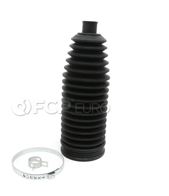

                              Maybe the steering rack boot -- after shorten -- is a good candidate.
