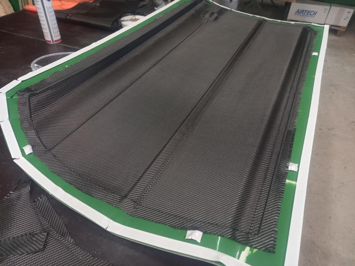

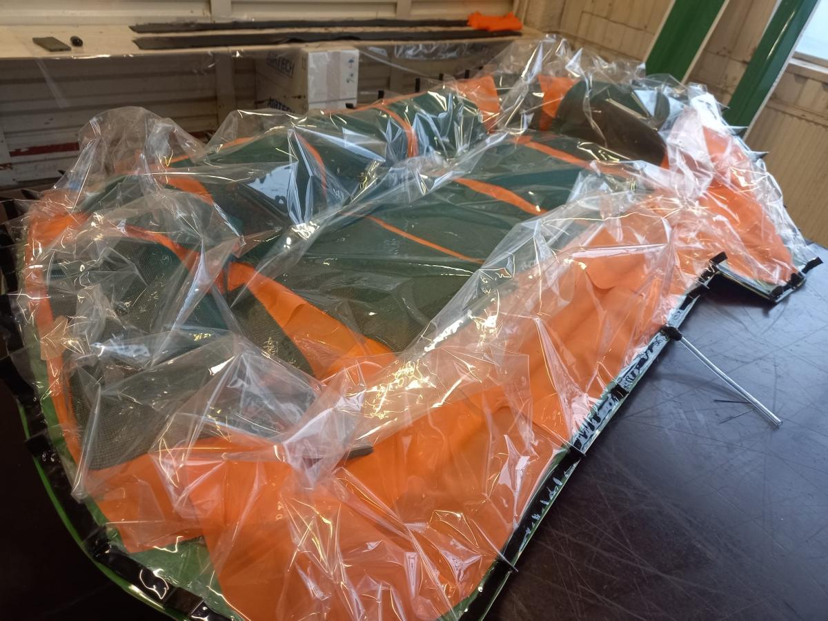

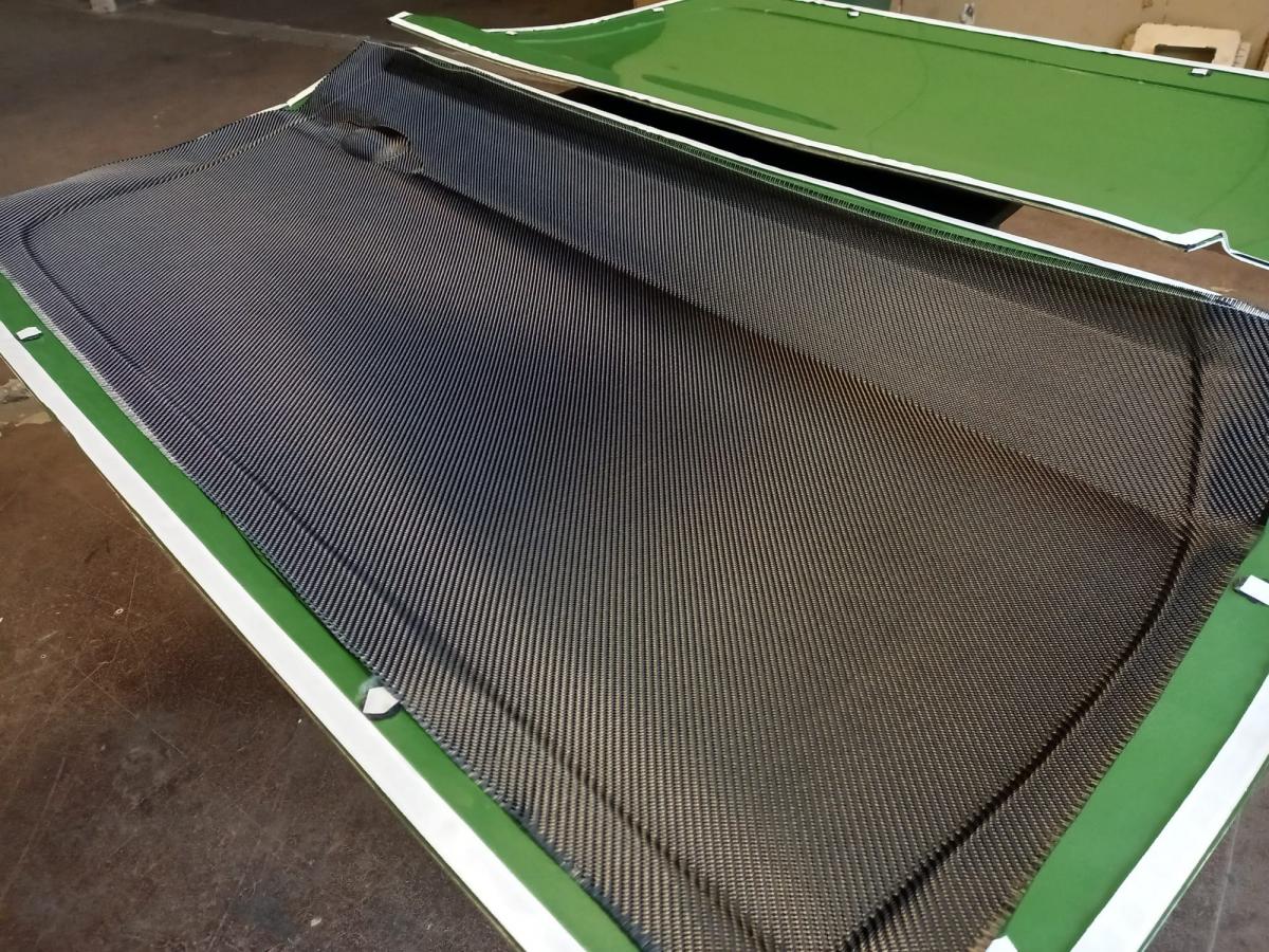

          Some progress on this!
          I'm hoping to receive these within 4 weeks or so.

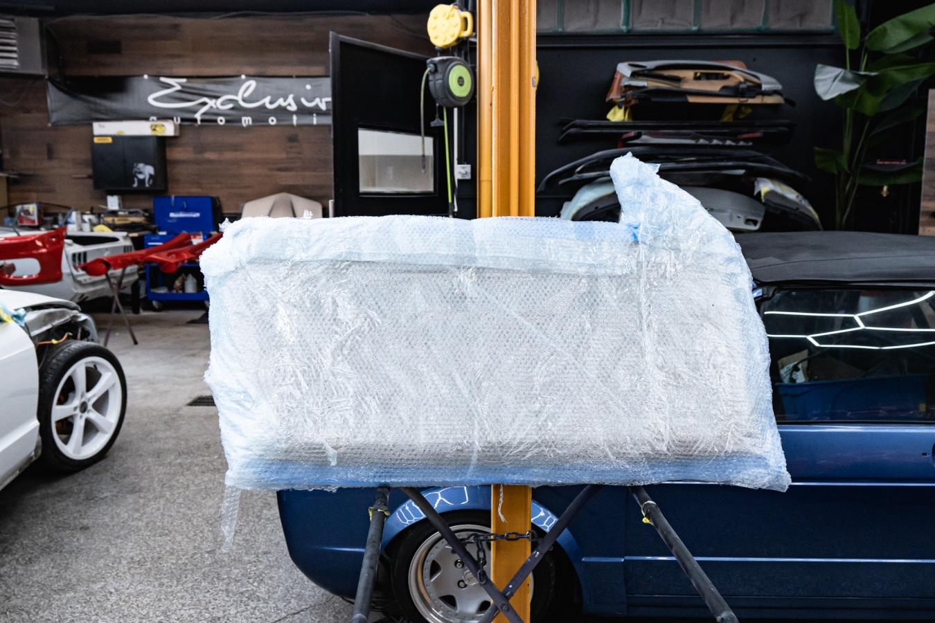

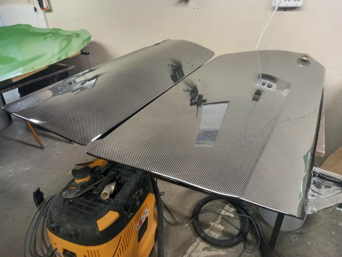

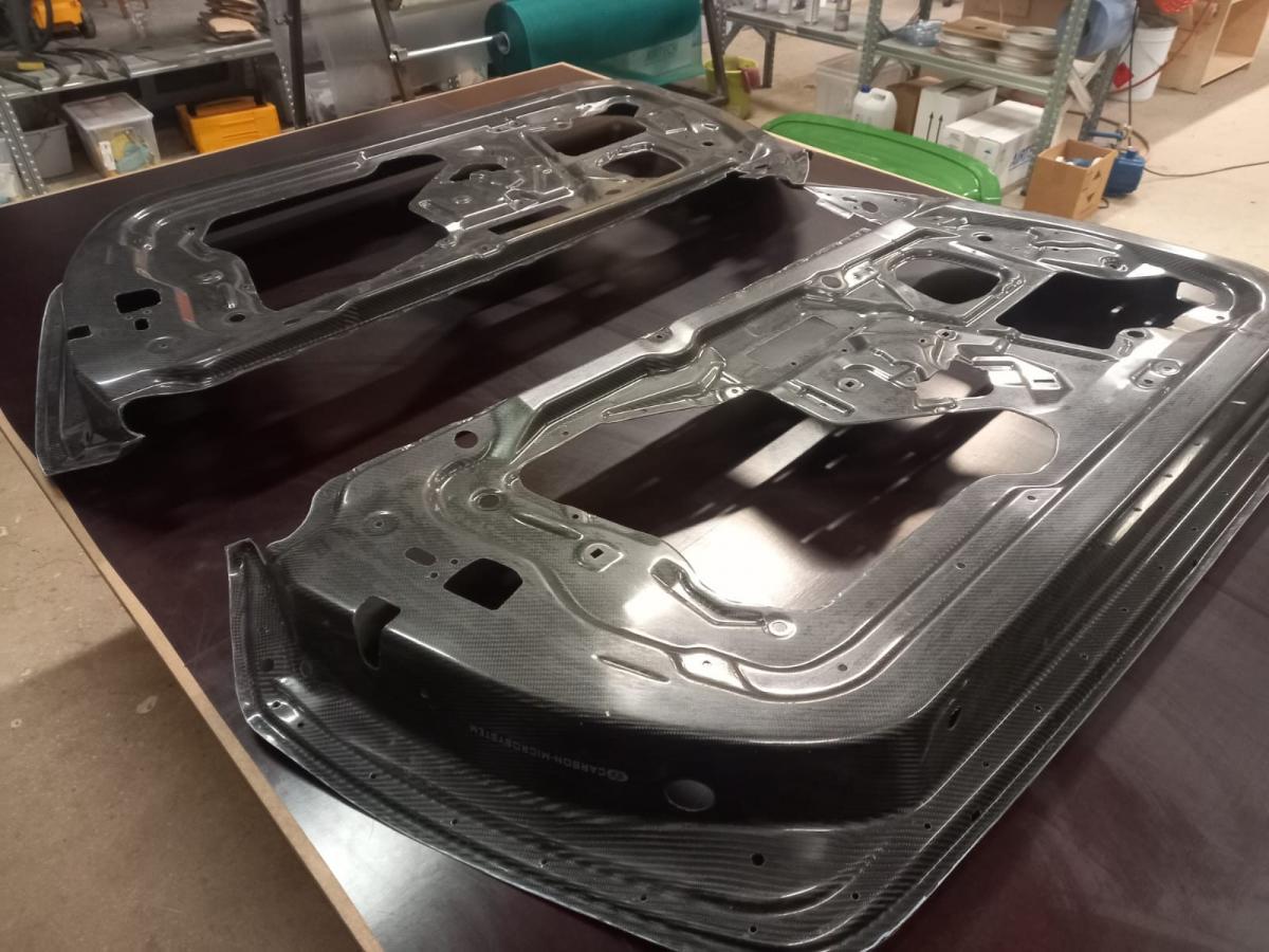

            They're on their way.
Name:	WhatsApp Image 2023-05-16 at 12.11.48 AM (1).jpg
Name:	WhatsApp Image 2023-05-16 at 12.11.48 AM (2).jpg

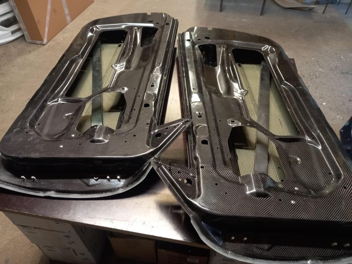

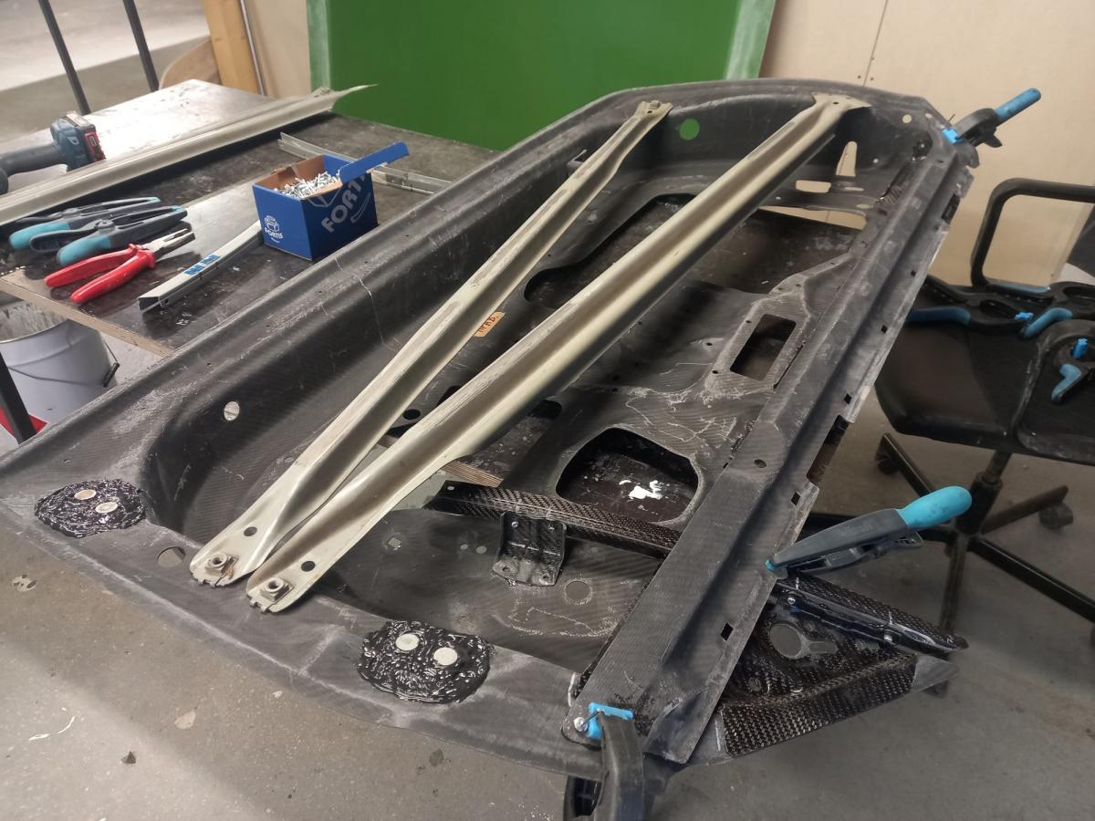

              The pending specs were 5lbs per door, what's the final product weight since they're now in your possession?

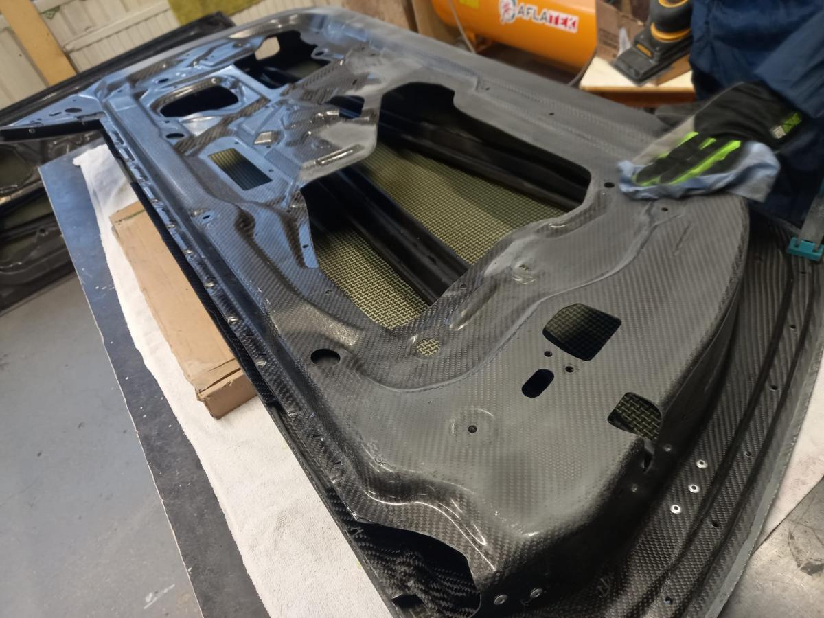

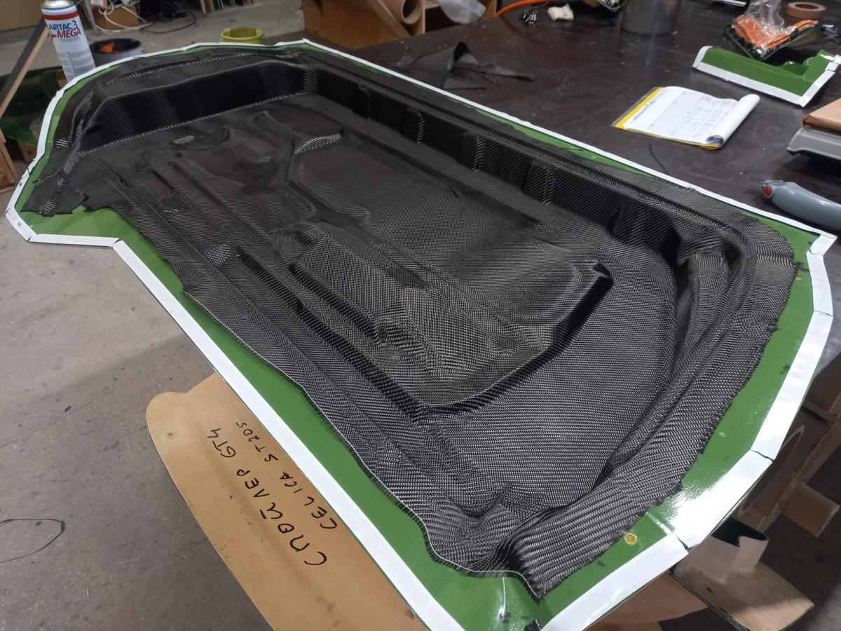

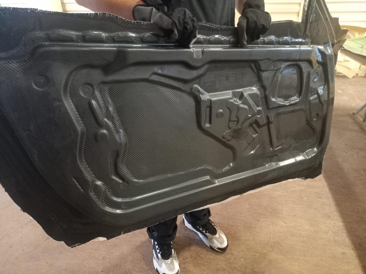

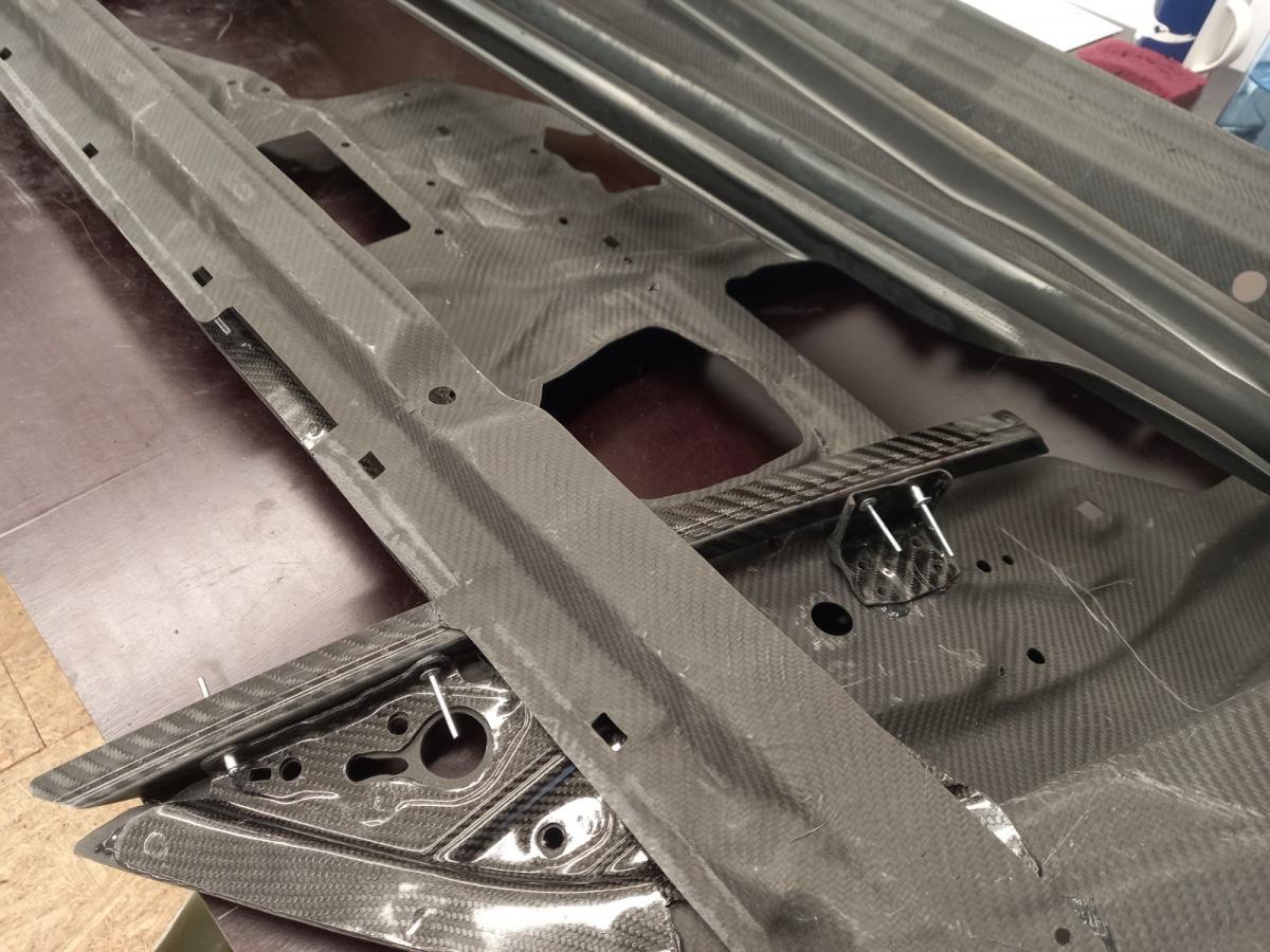

                Interesting. Looks like they used a kevlar/carbon weave on the backside layer. I’m working on a left door mold right now - the concern is carbon shatters and quickly breaks apart once elongated. The kevlar will at least hold the structure together.
                The crash bar is aluminum. Couldn’t your manufacturer make one from kevlar like the OEM front crash bar? That would save a lot of weight and be much thinner.
                The only other comment is the airbag mounting area, carbon or carbon/kevlar? Would it hold up if the airbag deployed? Or would it destroy the mounting area?
                  The door itself is 3.7 kg, the bar adds 1.6 kg. Not yet in my possession!
                  Yes, that is the intention. Ultimately this is all theoretical as the budget to crash test this is not available. It's definitely a buyers beware.
                  They could - but we felt the OEM would be safer considering what you said above. Karbonius went with a carbon crash bar on their E92 doors.
                  Great question, I will document this in detail once I get my hands on the door.
                  We can share notes when done! If it can help you in your project, I'd be glad.
                    Absolutely. If you have any input on the final project, I would recommend integrating some kevlar into the layup and the inner skin. Kevlar is kind of the opposite of carbon. It still maintains most of its strength beyond its yield point so it will still hold its shape, thus not shatter.
                    The crash bar can also be kevlar.
                    Do be aware that Kevlar is difficult to work with - doesn’t cut easily and is a PIA to trim - hence the reason why it has its toughness properties. So there might be some added cost.

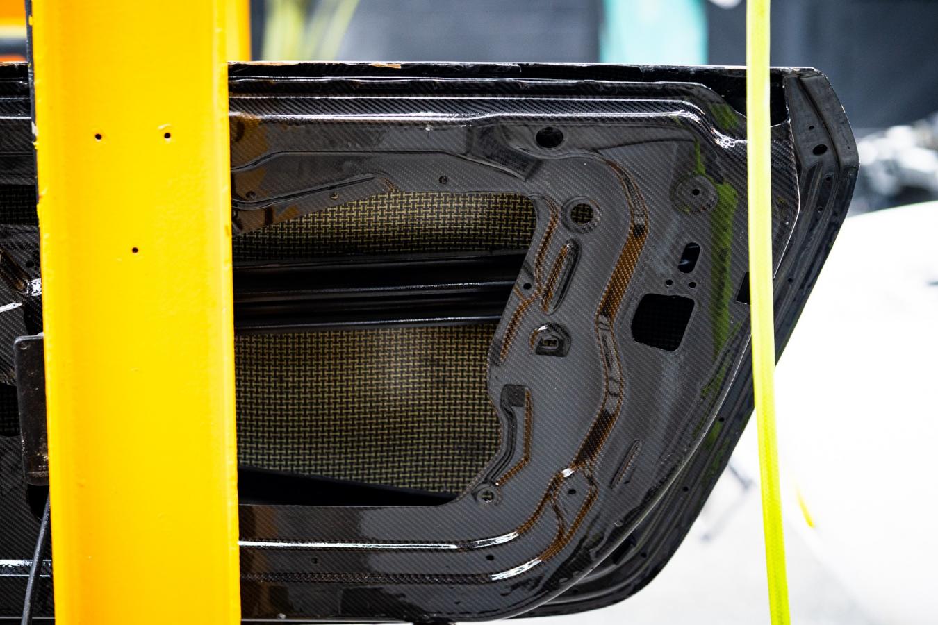

                      For sure, there is kevlar on the inner doors. I will ask how many layers were applied. You are entirely right on it - tensile strength is lower but it absorbs shock better.

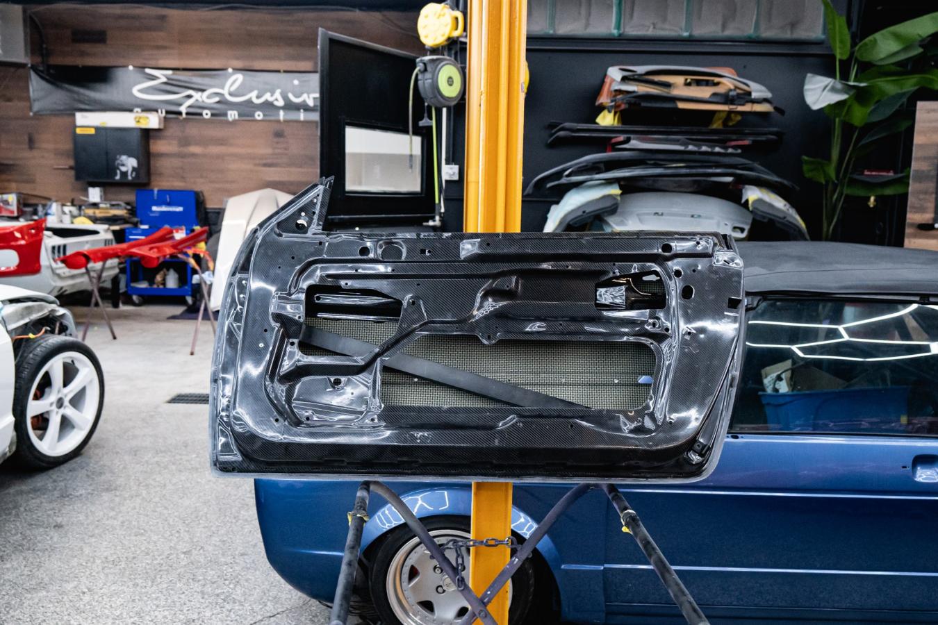

                      It was put on the E92 doors as well. Those were clear coated - which wasn't smart at all. The E46 doors are arriving in raw carbon.
                      Click image for larger version  Name:	_DSC2521.jpg Views:	0 Size:	206.0 KB ID:	218783
                        That should be good. I’d definitely explain that when you make the for sale post.

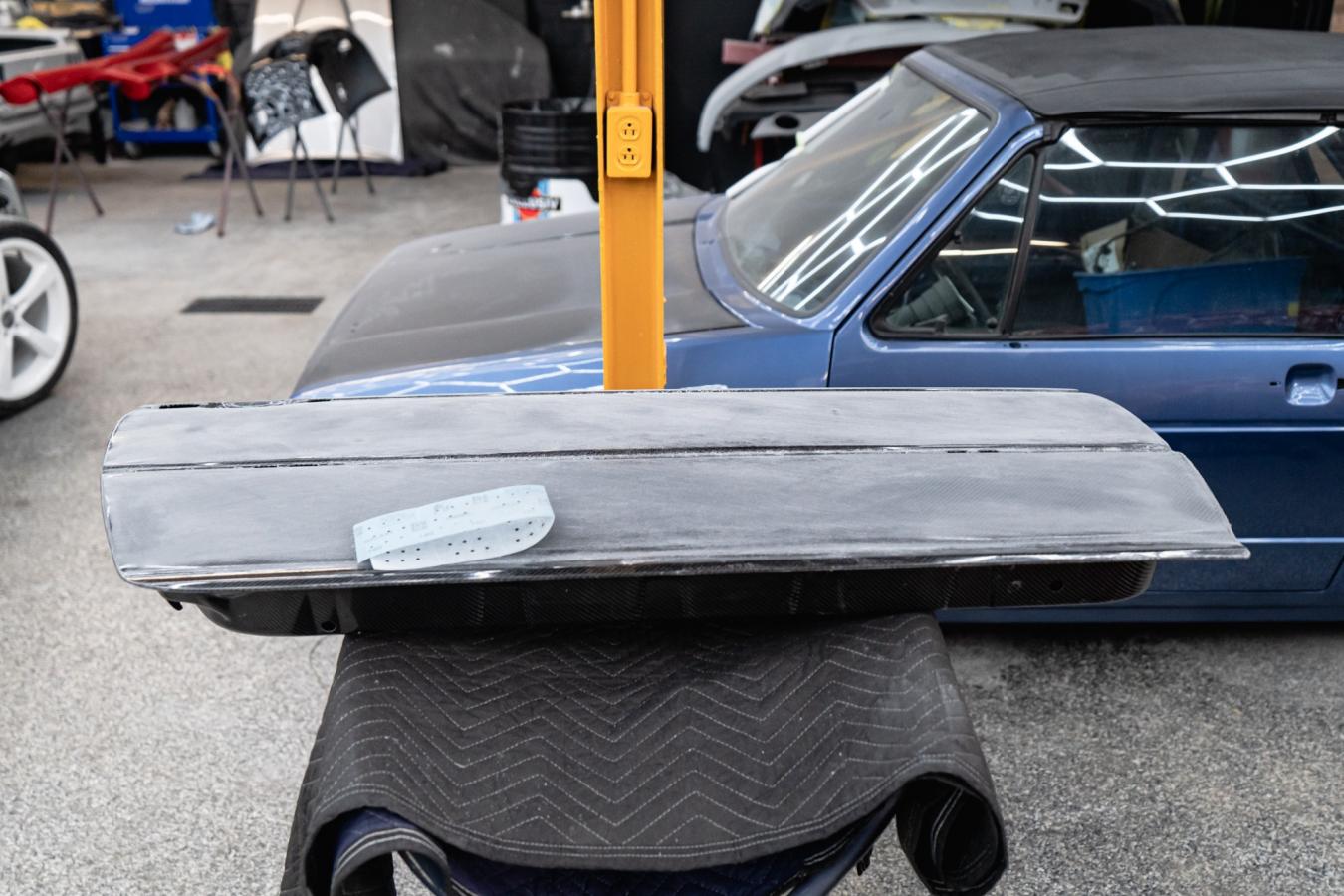

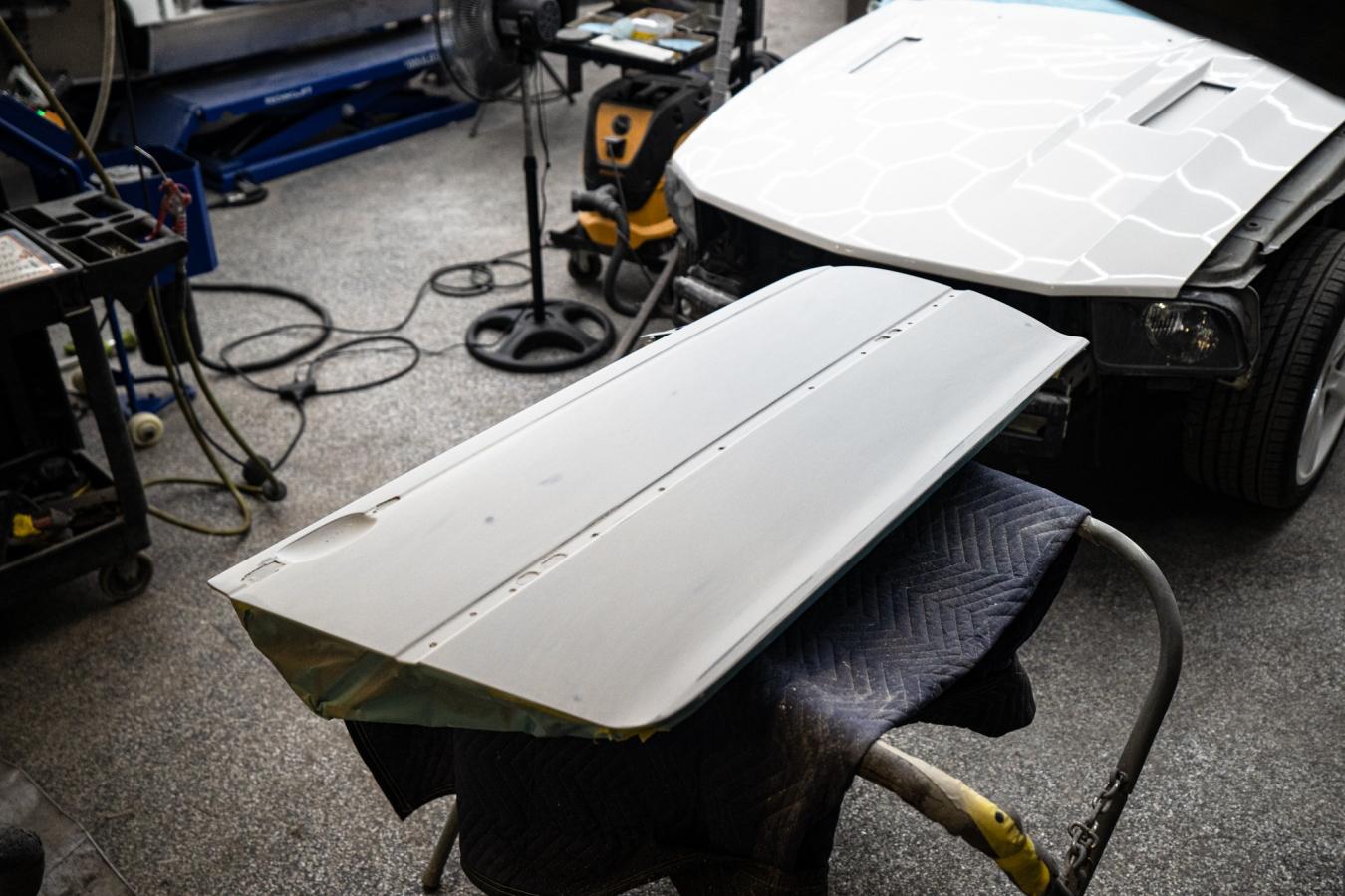

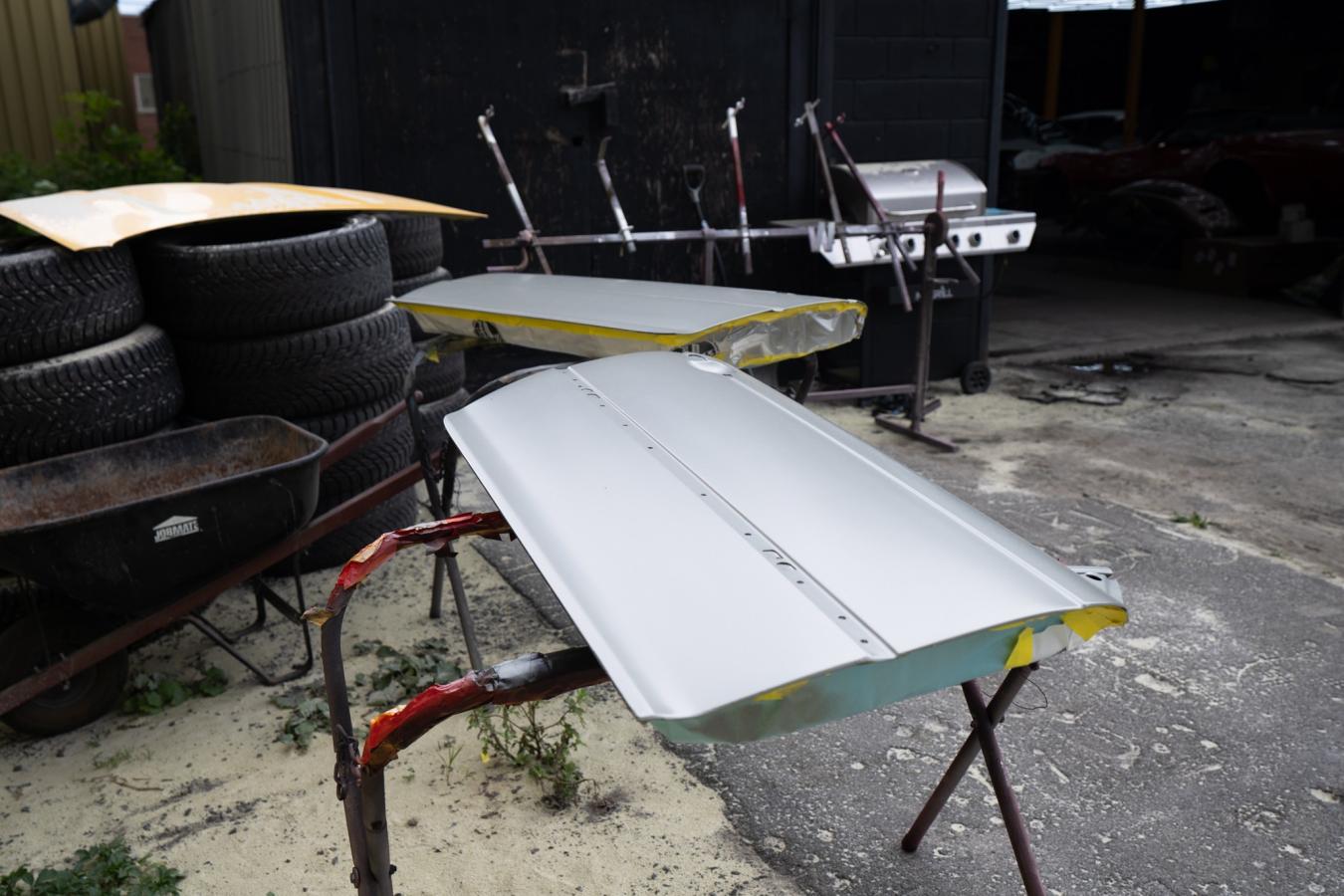

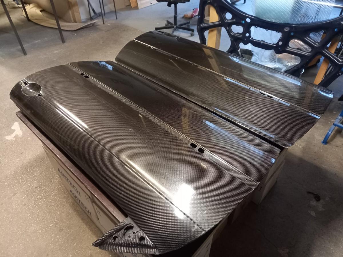

                            They are here: we already sanded them down and primer'ed them to resume the build.
                            Click image for larger version  Name:	_DSC7113.jpg Views:	0 Size:	168.7 KB ID:	223683
                            Click image for larger version  Name:	_DSC7119.jpg Views:	0 Size:	199.4 KB ID:	223684

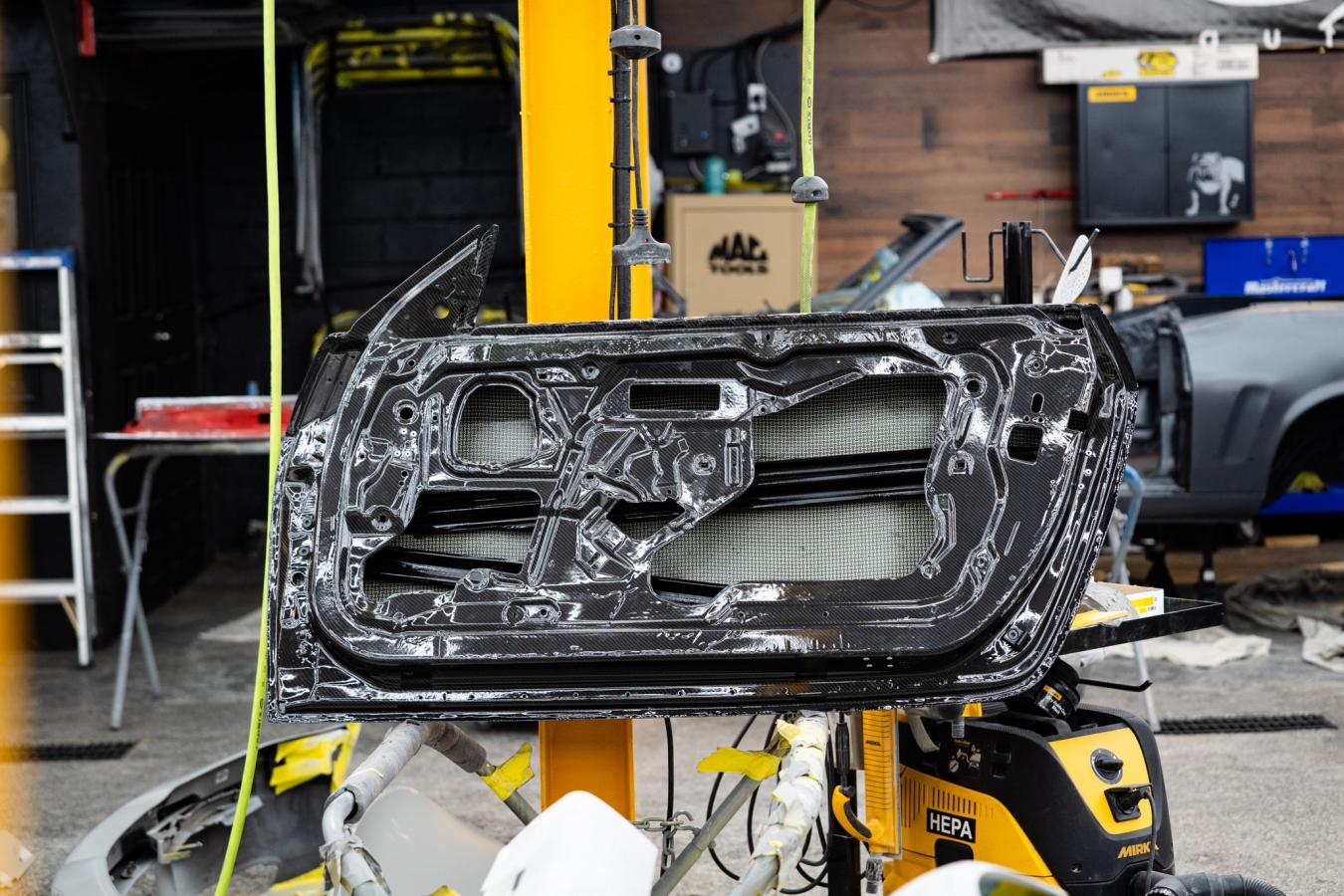

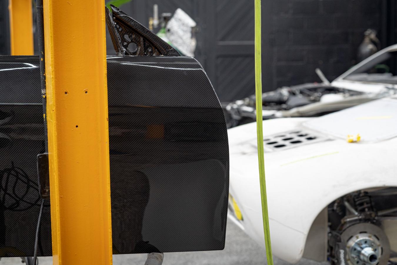

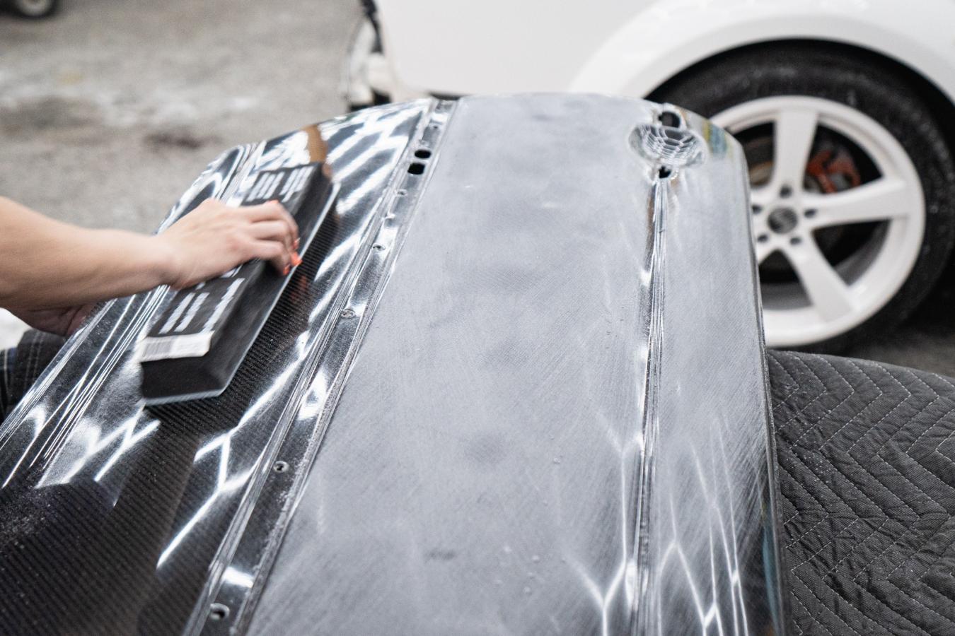

                              We're moving! The door got sanded with block-sanding techniques to isolate uneven spots before primer. We did the first primer and more sanding to flatten it again - another primer session will be needed.
