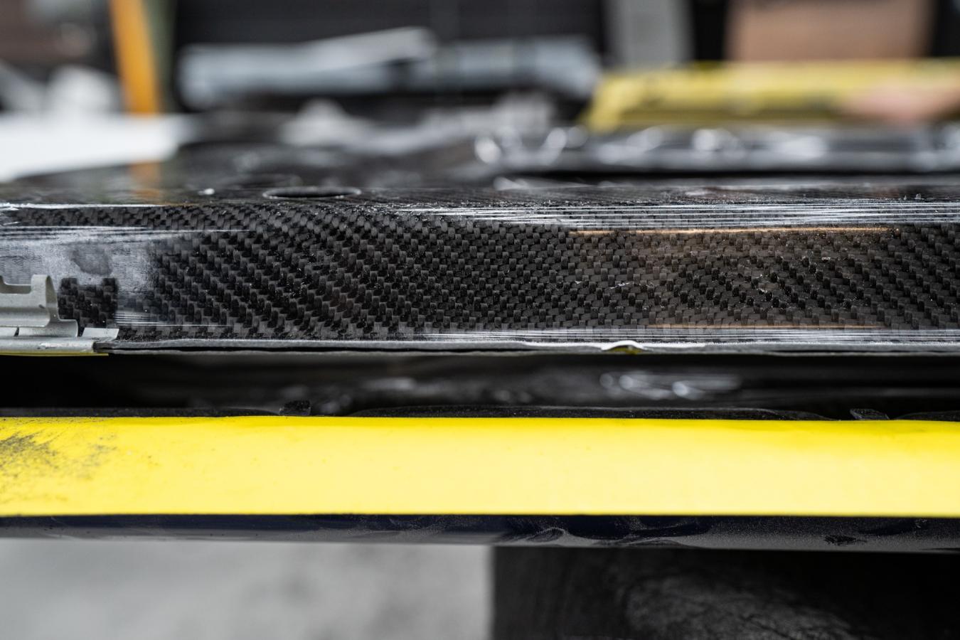

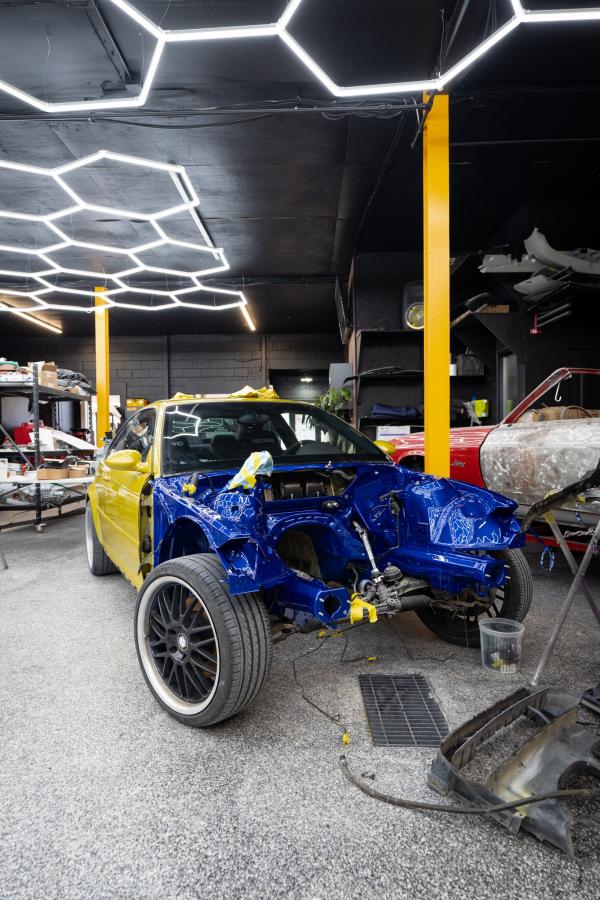

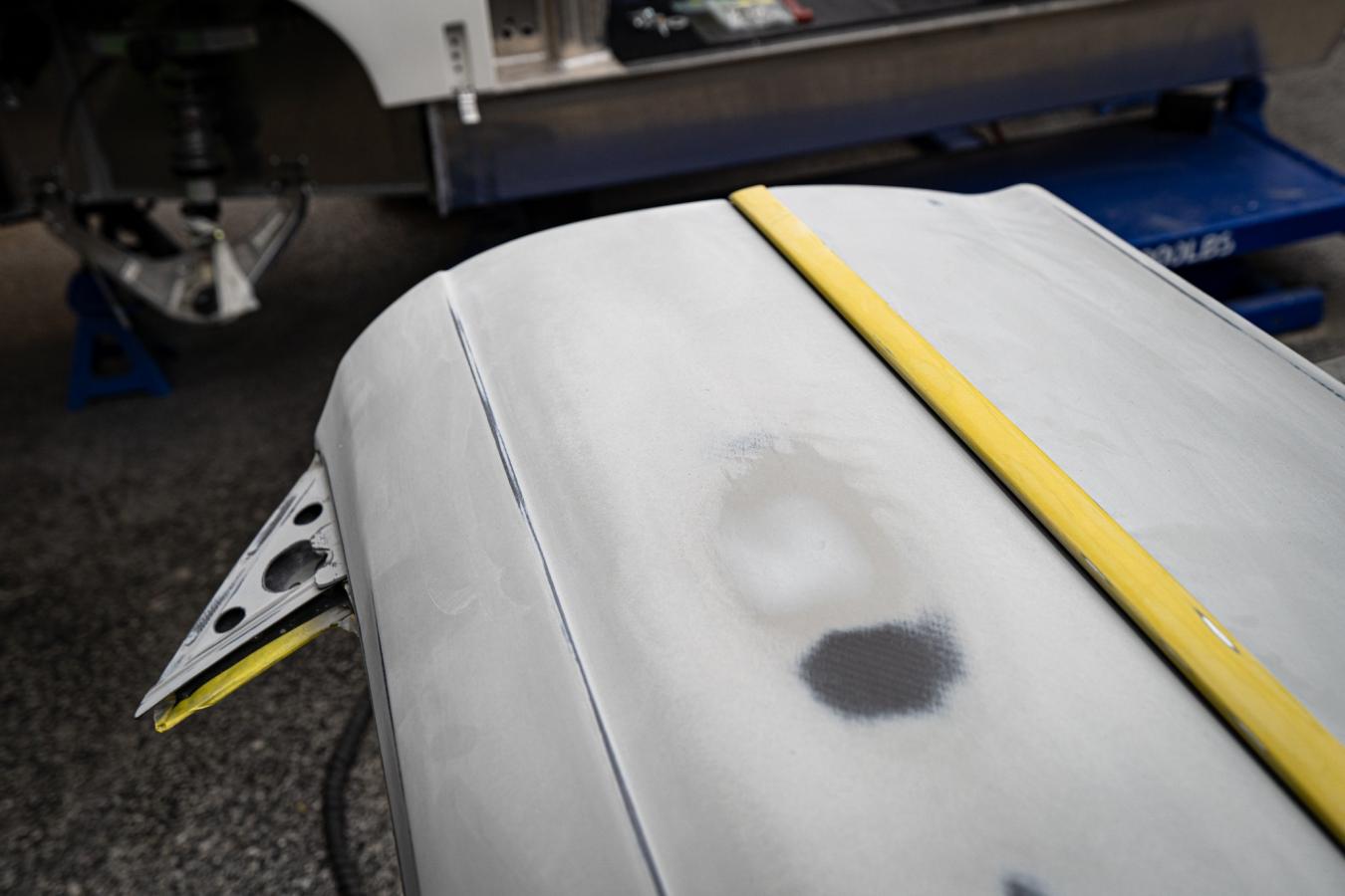

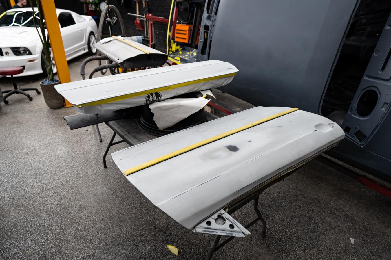

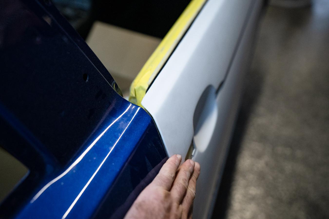

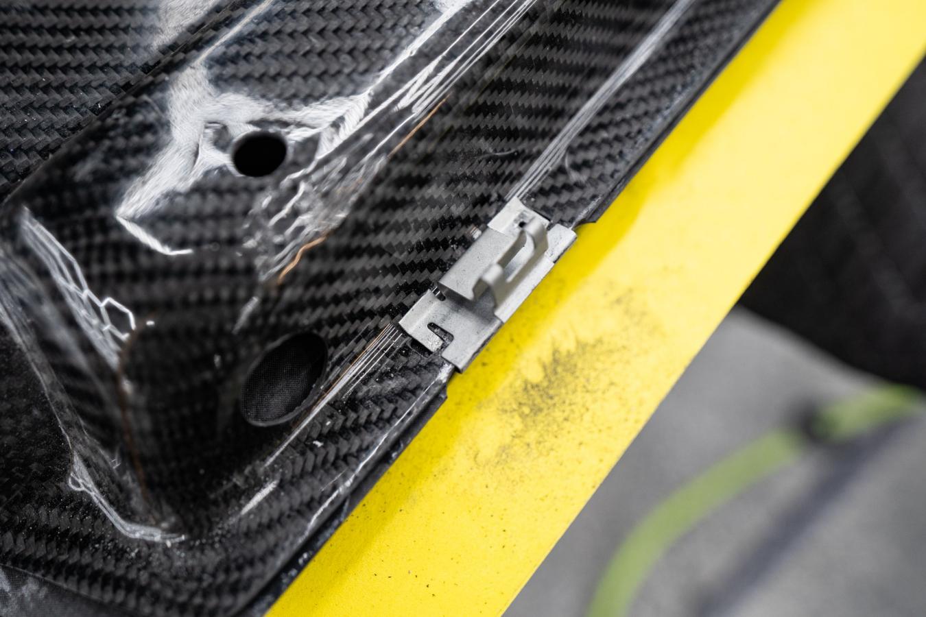

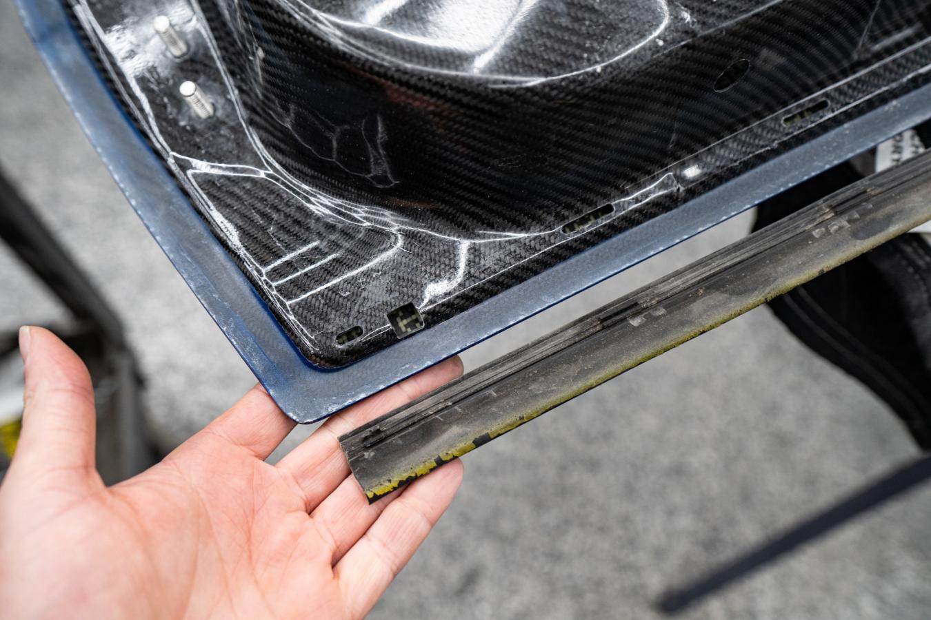

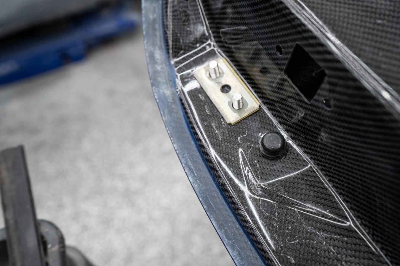

    Making progress, paint preparation is done. Overall, these required some work, but not that much. Carbon doors don't ding, we think the door used for the mold creation had some door dings.
    You can see the flattening on the second picture by the slight bondo we added next to the bare sanded carbon.

        The stock doors without any accessories weight 17.5 kg / 38.5 lbs. The E46 carbon doors came in at 3.6 kg / 7.9 lbs without the crash bars. They add 1.8 kg per door for a complete weight of 5.4 kg / 11.9 lbs.
        We're in for a minimum weight savings of 26.6 lbs per door without deleting any accessories / retaining everything OEM.
        Agreed on the kevlar, I wouldn't feel safe at all without the crash bar. The door skins are relatively thin: they flex.

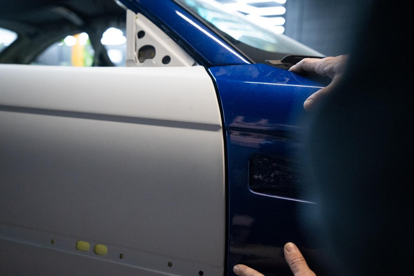

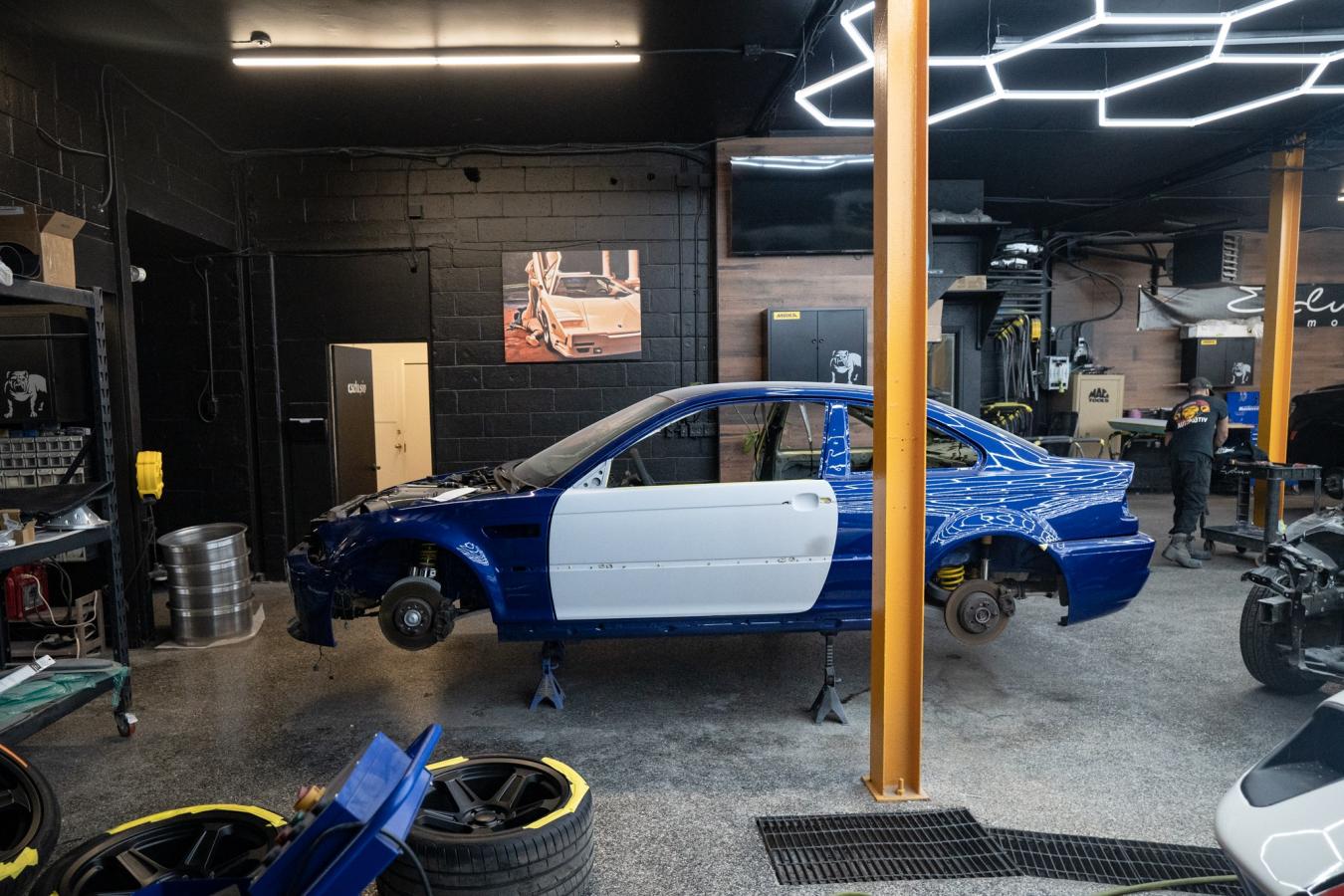

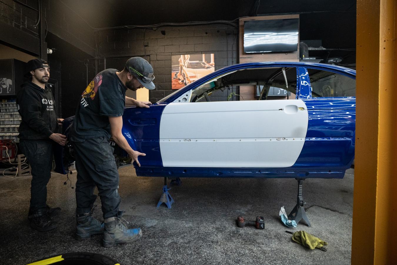

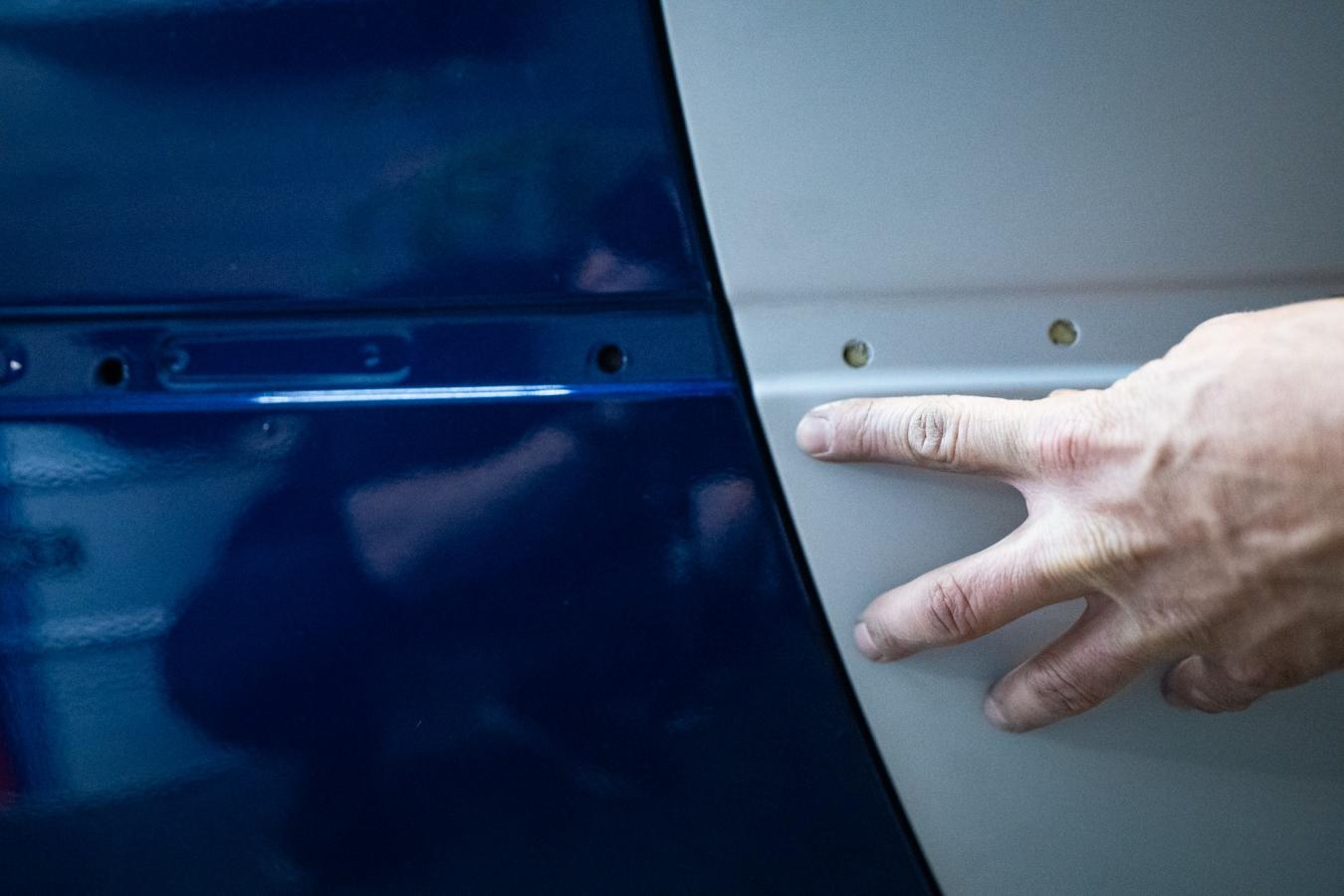

          Progress finally being made. The test fitment went well - all lines... line up, along with the widened fenders. It's looking good for now.

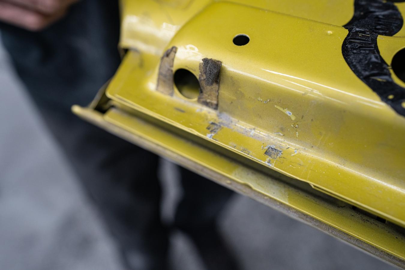

                  Were you able to confirm if the OEM bar is bolted or molded to the carbon door?
                      Bolted!

                              The bigger challenge is fitting the fenders down to OEM gaps. It's to be expected considering it's interlinked with 4x other body panels and the side trims.
                              Here are a few pics until then. As a disclaimer, having a white color panel against a darker color will emphasize the gaps from my experience with the E46 and the M3 V8 carbon panels I fitted.

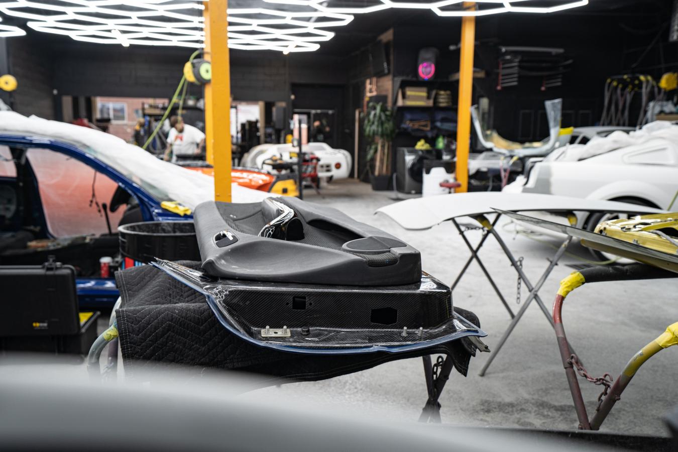

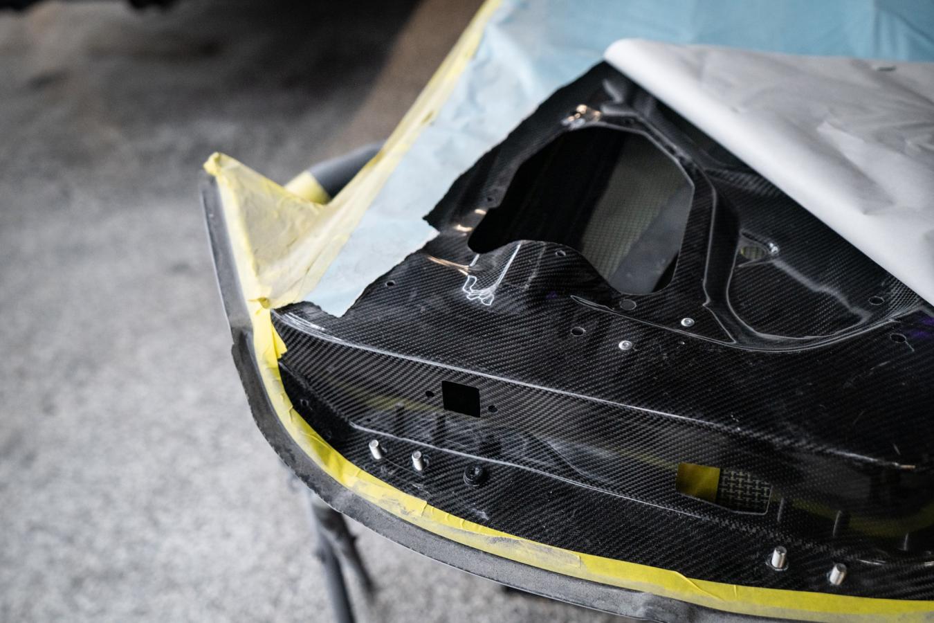

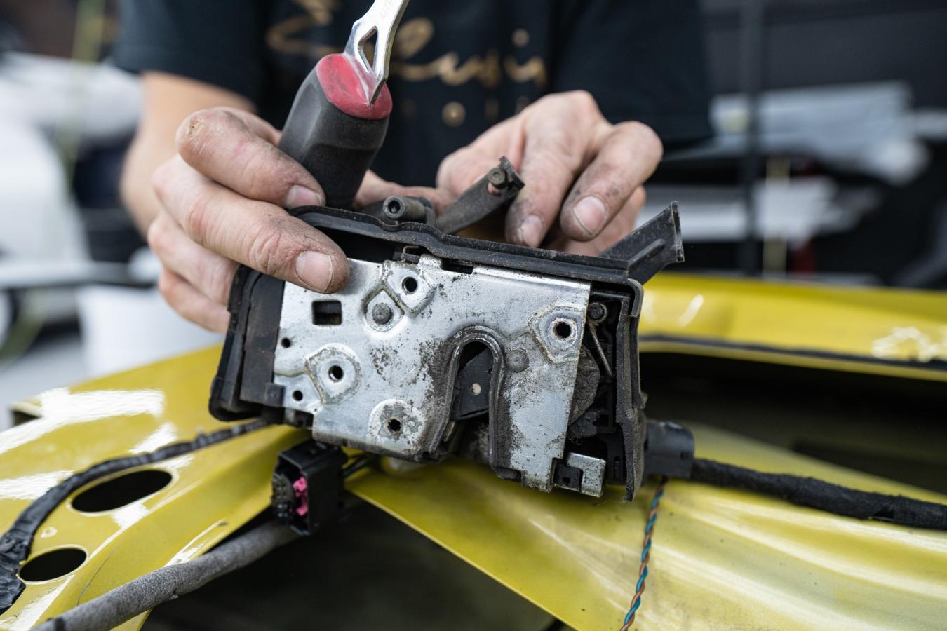

                                We started on the interior fitment work today. Overall it's pretty good in regards to fitment with door cards and door auxiliaries. Slight trimming needed for the door card clips on top.
                                I'll report back with notes in a new Build Journal entry.
                                Of course, my passenger side "ketch" was FUBAR and the lower gasket were oversprayed with PY from the previous owner's low rent respray.
                                Outside of a few small revisions, I'm getting ever closer to feeling confident about officially sourcing the doors for owners. We'll also be offering bespoke paint & fitment program on this.
