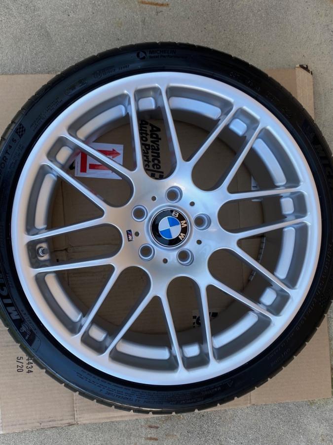

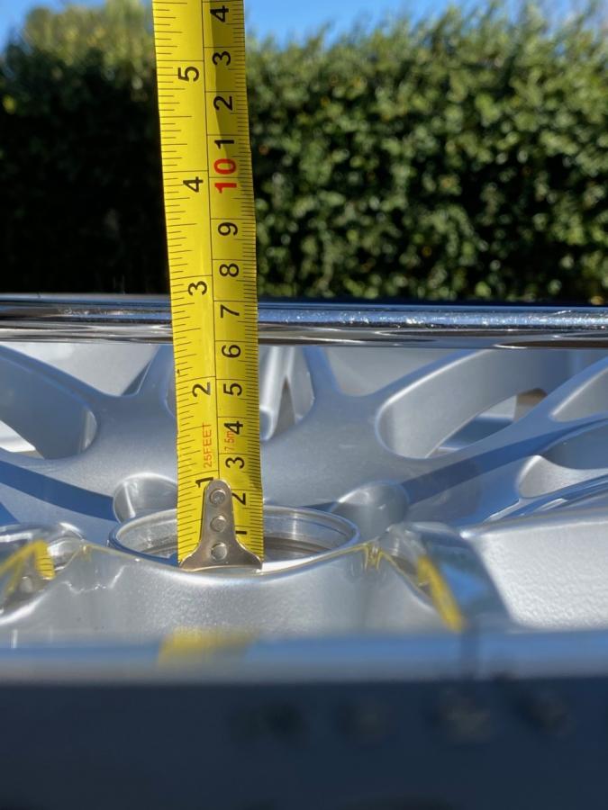

    Would like to know how the V703 style differs from OE ZCP wheels. Aside from the obvious things like the color and stamped letters around the center caps, how do these wheels differ? Some people say the spoker are thinner, they're not as concave etc. Here are my 19x8.5 and 19x9.5. VMR told me the 9.5 is even more concave than OE. I put a flat bar across the face of the rear wheel and measured the concavity at 54-56 mm from the top of the center cap lip. Can anyone compare that to the OE wheels? These wheels are basically 1/3 of the price of OE and I'm thinking to buy a black set from my E46 vs buying a used set of OE and powdercoating them.
    One other visual difference I noticed.... on OE wheels it looks like the area where letters are stamped is flatted out which gives it a ring and makes the look more concave?. I really can't tell how else they differ?
    19x9.5

    19x8.5"

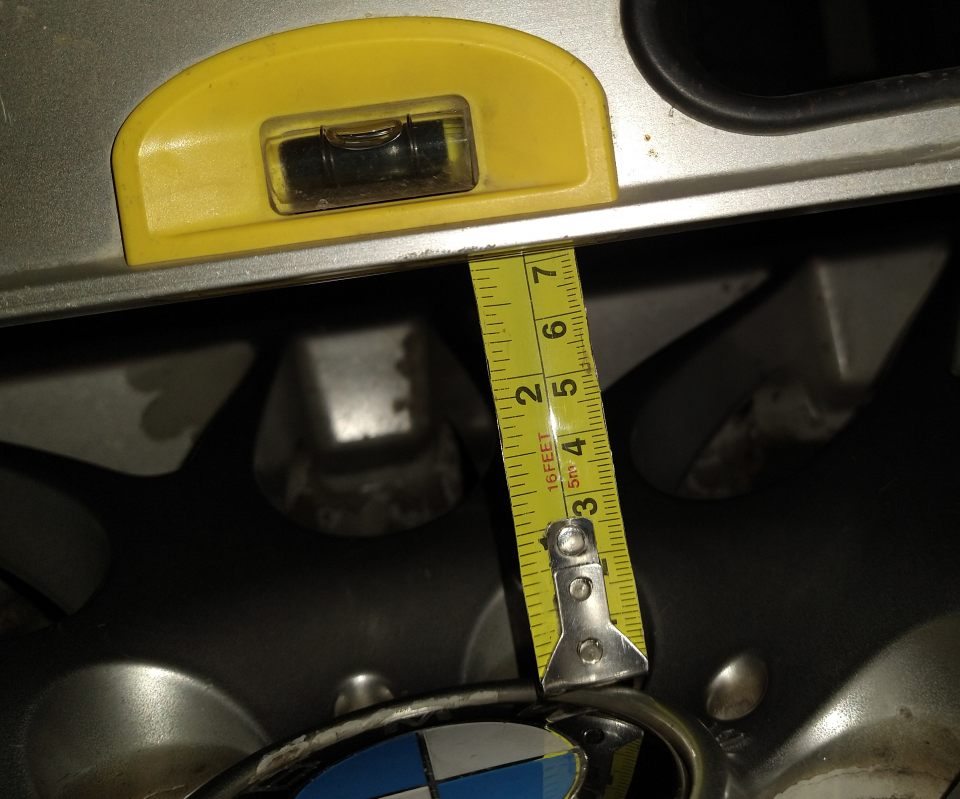

    My ZCP wheels are off the car for winter storage, so was able to do this measurement on the rear wheels. Looks like ZCP are deeper, I measure 71mm. The straight edge was resting on the tire, but that's only about 1-2mm off from the wheel edge so actual distance is going to be right around 70

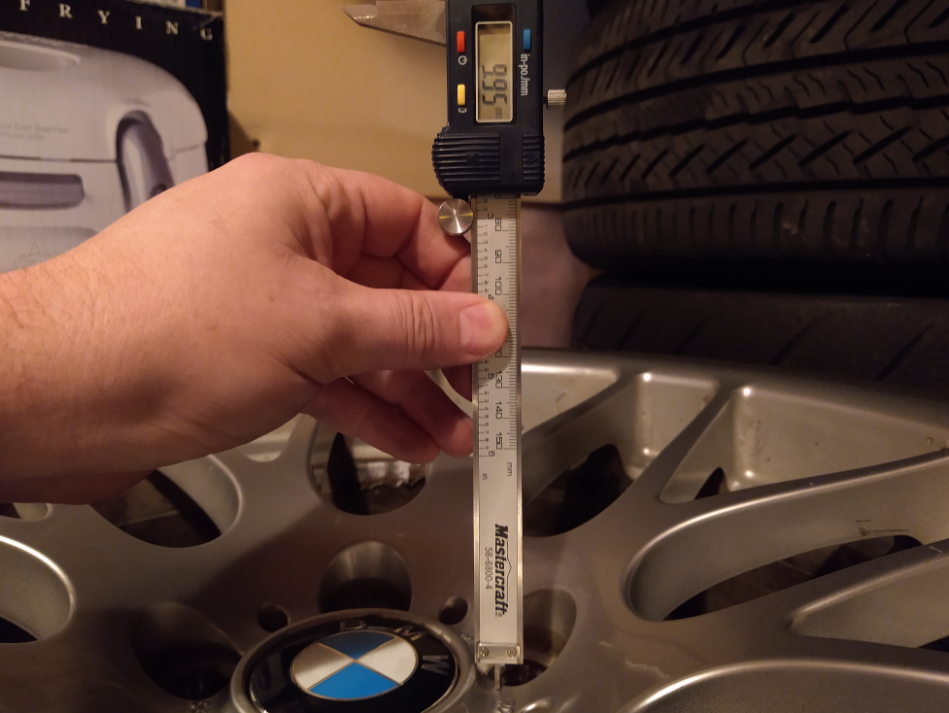

      Thank you. Do you know how height the lip for the center cap is? on the V703 they're about 8mm tall. I went and re-measured the concavity again and its definitely under 60mm and no where near 70 mm if measured from the surface of the tire (275/30 PS4). Perhaps the 19x10 may be as deep as the OE wheels
      2007 Imola Red Z4M Coupe
        About 10mm

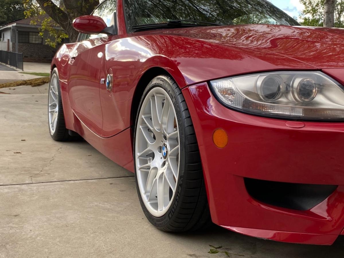

          Ended up installing them on My Z4M that I just lowered on Bilstein B12 pro kit. For anyone that is thinking about buying these wheels, here is how they look ! The rears may not be as concave but the setup still looks very beautiful. I am very happy with the results. My rears are 19x9.5". Perhaps the 19x10 is just as concave as OE ZCP.

              Yeah they are not too bad. For $900 shipped black Friday sale I can’t complaint. I am not sure how they are made but the finish is not the best. There are a couple areas where the clear coat was a little runny and few dust particles below the paint. Also the lug holes are poorly painted. Overall it’s stuff you notice up close. I may get the black ones for the E46 since these are close enough. The AG M359 on the other hand are an exact replica. Side by side they look exactly the same !

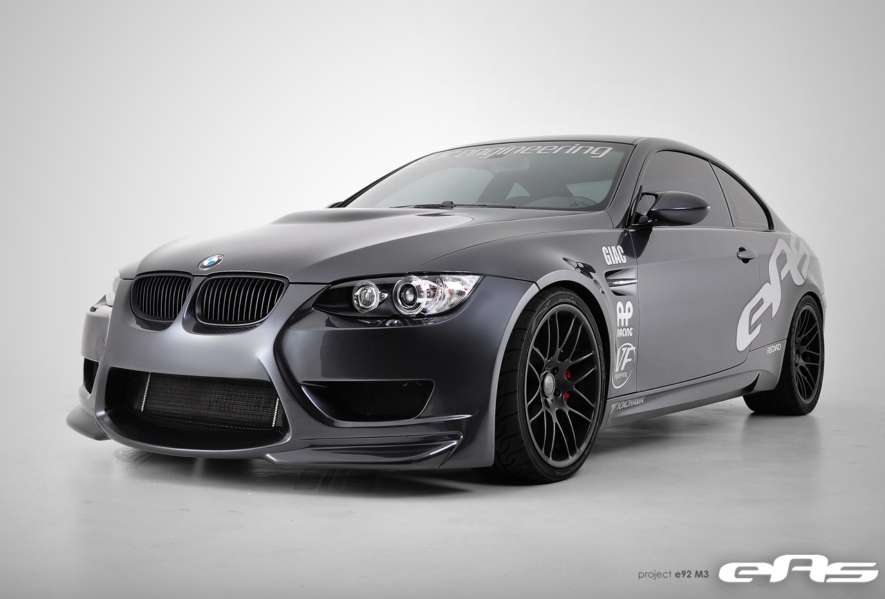

                            19x9.5 and 19x10 both in + 22.
