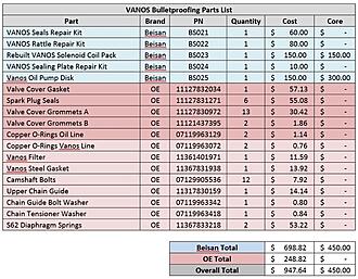

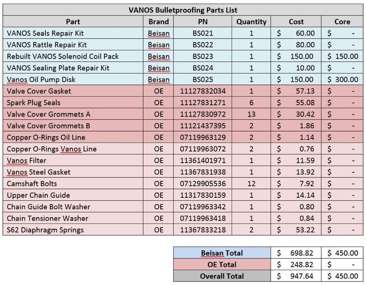

    Is there a handy list of all parts that should be replaced for a full VANOS overhaul?
    Here was my list:
    Build Thread
      Click image for larger version  Name:	image_7428.jpg Views:	19 Size:	161.2 KB ID:	20722
