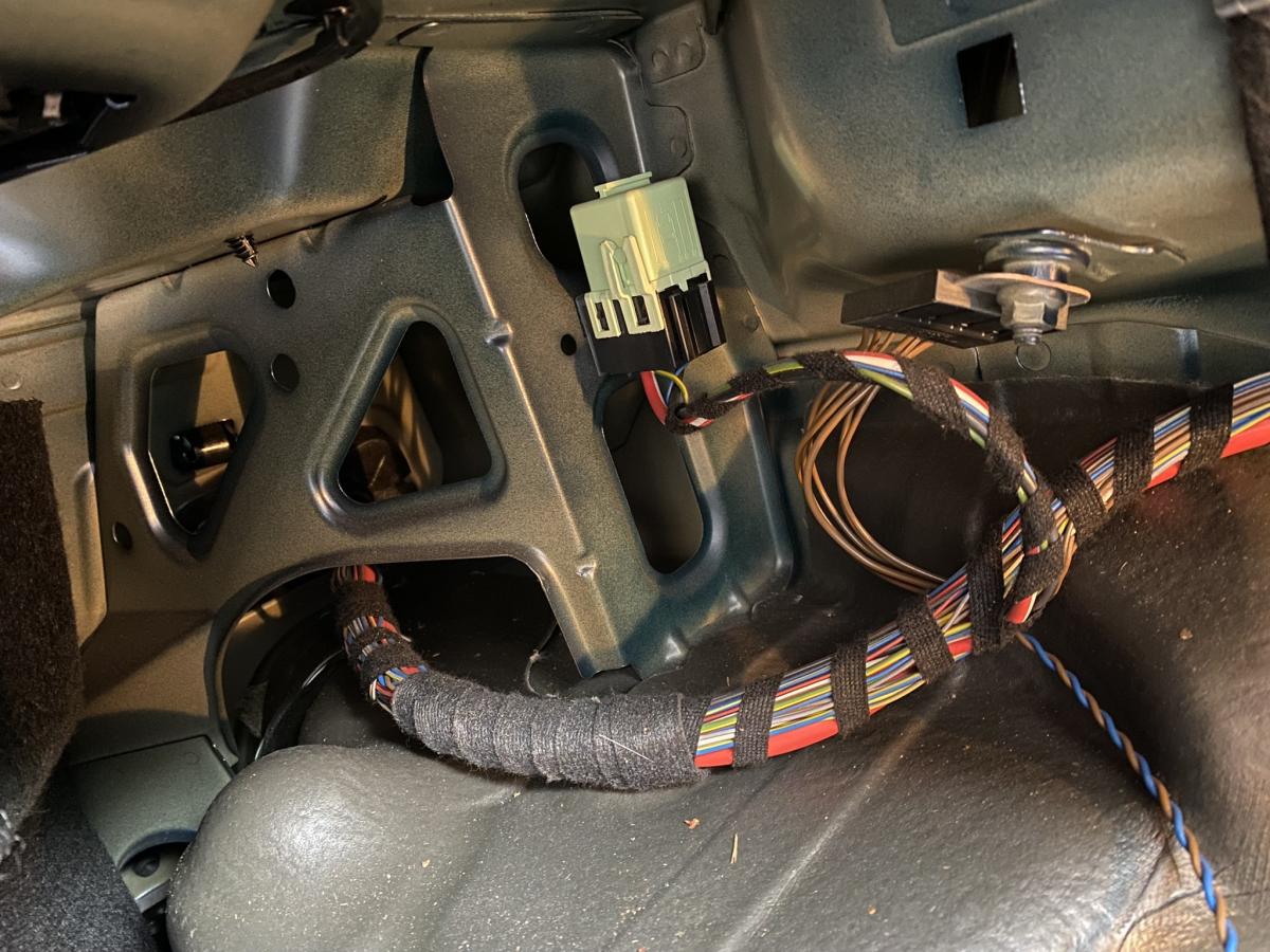

The pump relay is in the trunk. I think it has PWM modulated output signal to control pump voltage at different engine load.Last edited by sapote; 04-01-2023, 01:05 PM.
Today I learned there is another relay for the fuel pump in the trunk...
Just nipped out and removed the boot trim to find this:
You're saying this is also linked to the fuel pump?

Ah, I think these are different between Euro cars and US cars, with Euro cars not having the EKPLast edited by jamesfoley; 04-01-2023, 09:11 AM.
measure directly at the pump two wires.Originally posted by jamesfoley View PostI think what I realistically need is a way to monitor fuel pump voltage as I drive that plots a graph to see what its actually being fed.

I don't know the best way to measure the pump voltage w/o cut off the wire insulation; you could measure the the trunk relay pin that connect to the pump.Originally posted by jamesfoley View Post
How would I go about this without tapping the wires? Not sure I trust myself removing the pump and probing wires that way
