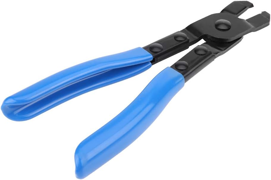

          Oh a side side note, what tool do people use to take off the hose clamps and not break them? Is there a special bmw tool? Couldn’t find one and just saw that people use hooked pliers
            A good pair of needle nose pliers with the jaws that have those small teeth works and it's a tool that most people have in their tool box. The actual tool is probably something like this - Clamp Plier For Oetiker - https://www.zoro.com/beta-clamp-plier-for-oetiker-14730020/i/G1903637/?utm_source=google&utm_medium=surfaces&utm_campaig n=shopping%20feed&utm_content=free%20google%20shop ping%20clicks&campaignid=19717005309&productid=G19 03637&v=&gad_source=1&gclid=EAIaIQobChMIkZSRmtHthQ MVkwOtBh1p7ACbEAQYASABEgKKH_D_BwE&gclsrc=aw.ds

                    I use one of these
                    Click image for larger version  Name:	image.png Views:	0 Size:	246.5 KB ID:	263489​
                    Wasn't really the getting them unclipped that was the problem, its that they stick to the rubber coupler and require some persuasion to free up, at which point they get kind of mangled and need to be replaced. Do wish they were just thinner screw style hose clamps. ​
