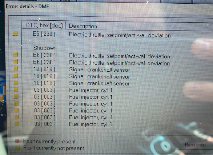

                      Pulled these codes:
                      Click image for larger version  Name:	nSdKrf2.png Views:	0 Size:	709.6 KB ID:	220865
                      I can understand injector and throttle position sensor codes as I had to unplug them to remove the injector harness.
                      The crankshaft sensor code however seems to have come back? I replaced the crankshaft sensor already so not sure why I am seeing this again...
                      Codes cleared and have been replaced with two Internal Fault codes that do not clear 🤷‍♂️

                        E6 DME: Electric throttle: setpoint/actual value deviation
                        ​This should cause the limp mode, and you didn't see the engine light turning on?
                        "Codes cleared and have been replaced with two Internal Fault codes that do not clear 🤷‍♂️"
                        What does this mean?
                        Shadow codes could be just a momentary.
                          Nope, no limp mode or lights on the dash, figured it was just because I removed the plug for the throttle position sensor at the front of the engine.
                          As for faults I’m always left with:
                          63 [099] Internal fault
                          59 [089] Internal fault
                          Went for a 70 mile drive and have the log: https://datazap.me/u/jamesfoley/e46-...0&data=1-2-3-4
                          Looks the same as all the others. It didn’t throw any other codes after that other than the two internal faults.
                            these could be the key to the mystery -- DME program code is corrupted. Try to reflash the code or change to another working DME.
                              For what it’s worth these codes only appear together with no other codes present, and P.A.Soft BMW Scanner is the only tool that shows me these. I get nothing in INPA or DIS/GT1.
