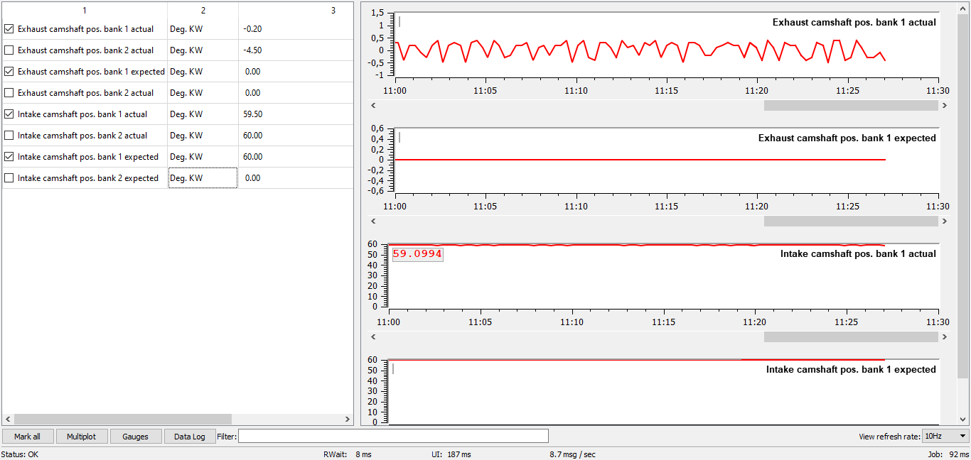

                  Just to follow this up with a bit of data, here is a log of Inlet and Exhaust commanded vs actual positions. Pretty sure the Exhaust graph just looks bad due to scaling but the Exhaust position swings half a degree above and below the commanded, and Inlet swings up to a degree below commanded. TestO is pretty decent when it doesn't crash.
                  My only question is what are the "banks" it is referring to here?
                    MSS54 is near to equal as MSS52 (used for S62) As S62 is V8 engine and has 2 banks and double VANOS these are used.
                      You have TestO, do you also have Tool32?
                      I figured it might have been for engines with multiple inlet/exhaust cams. Only reason I ask is the Exhaust bank 2 has an actual value that changes? Where it gets that reading from I have no idea...
                      I have EDIABAS ToolSet 32, assuming that's the same thing?
