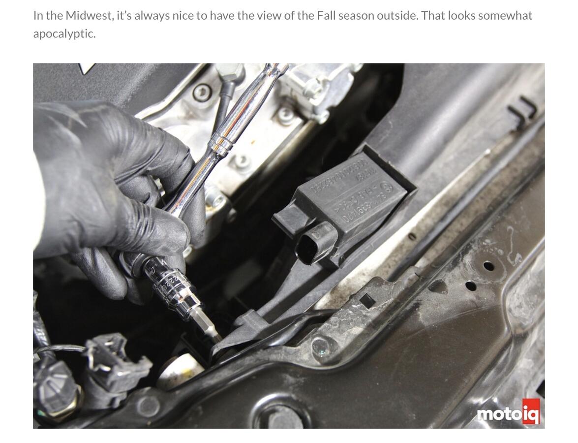

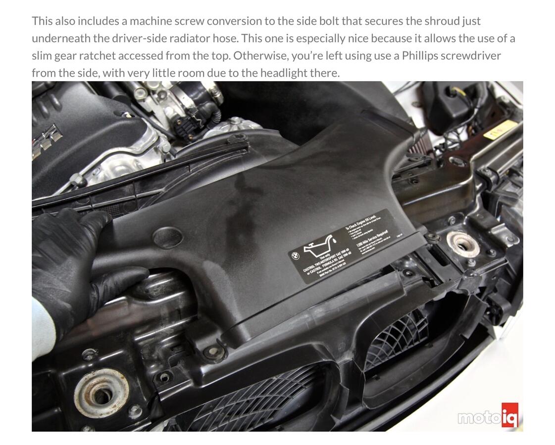

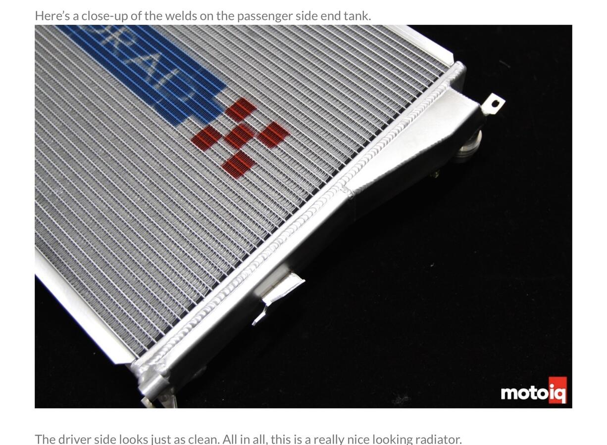

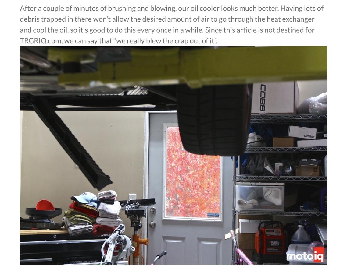

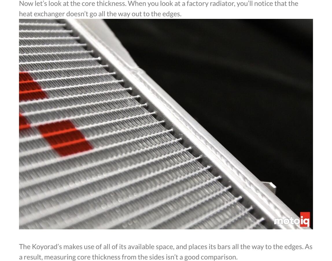

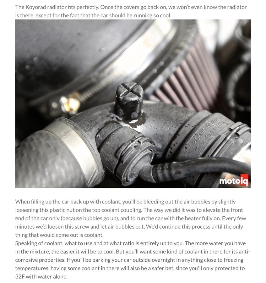

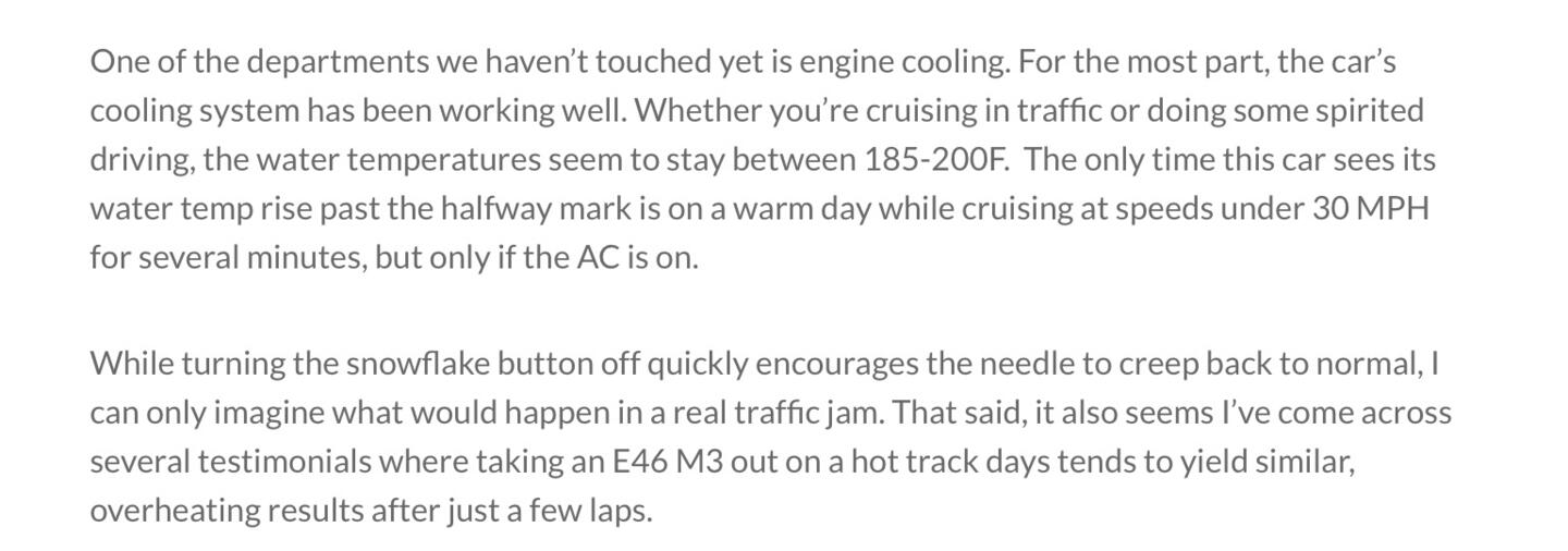

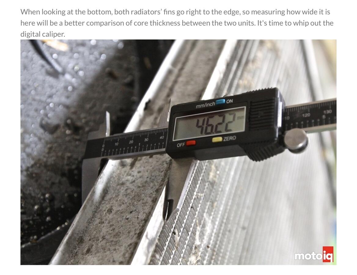

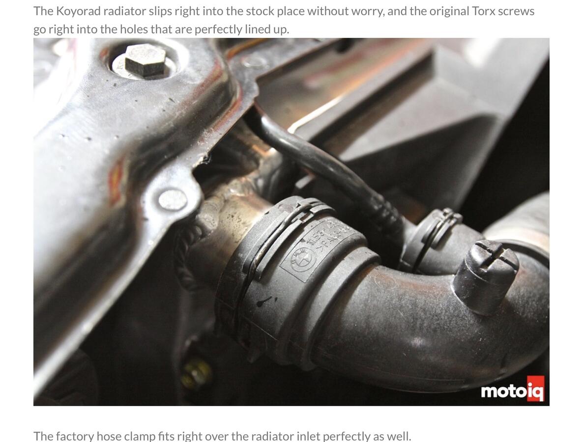

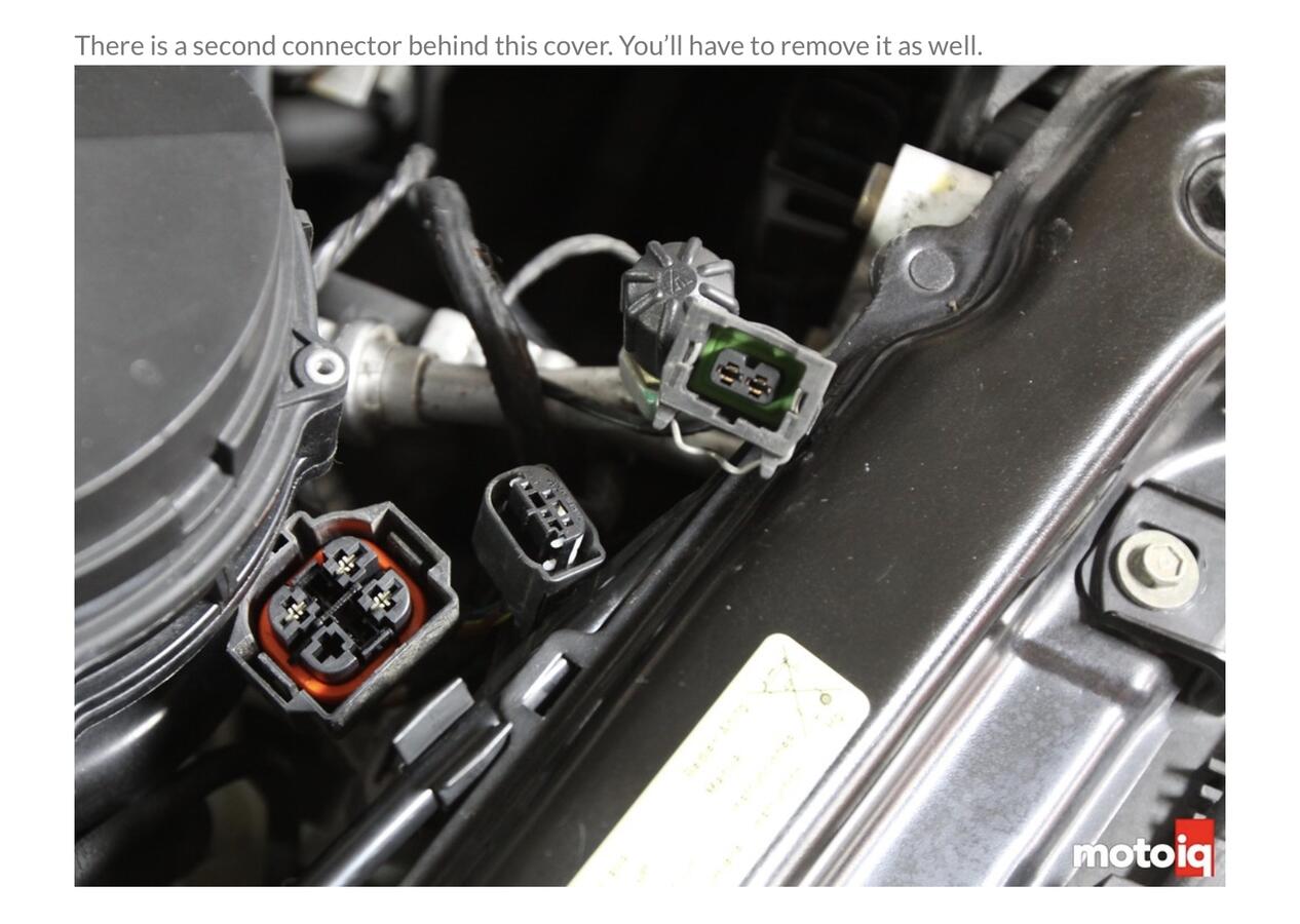

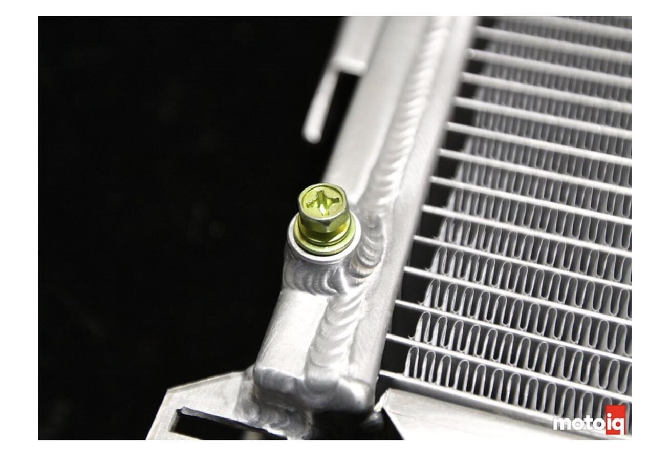

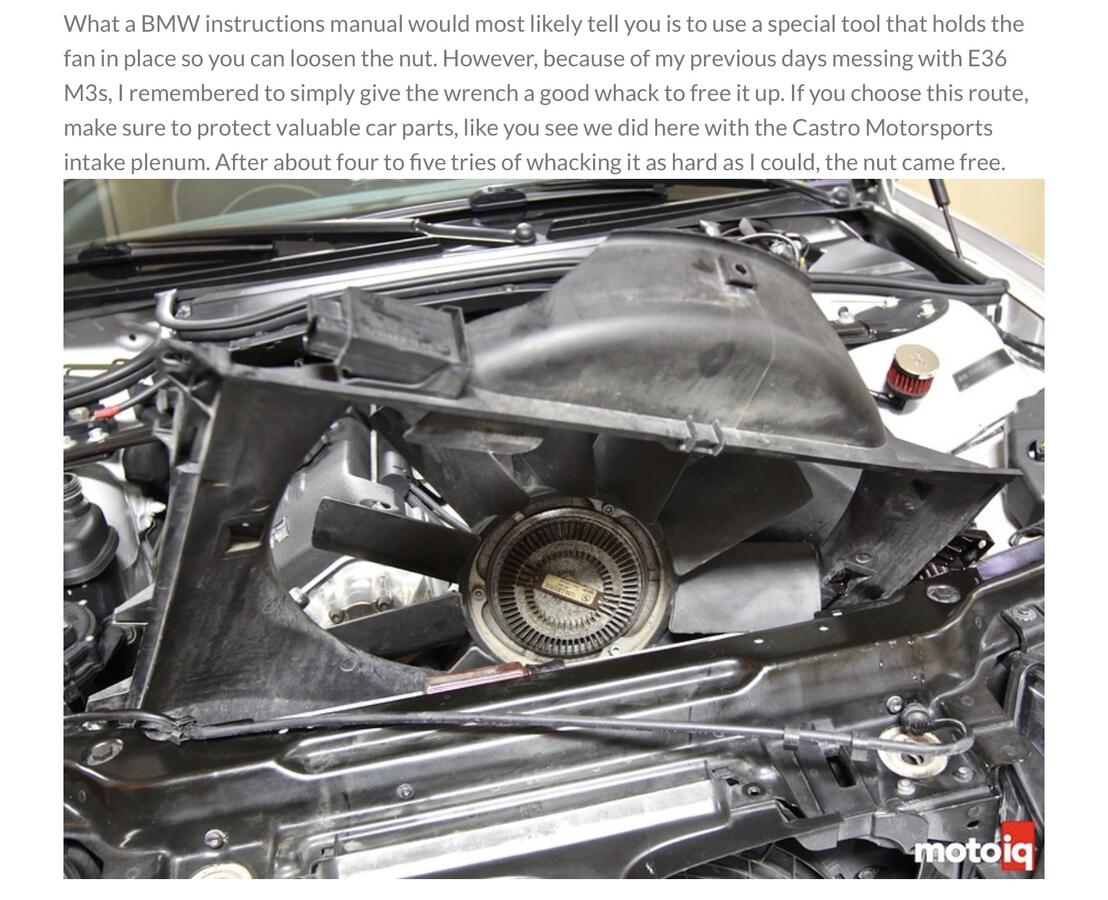

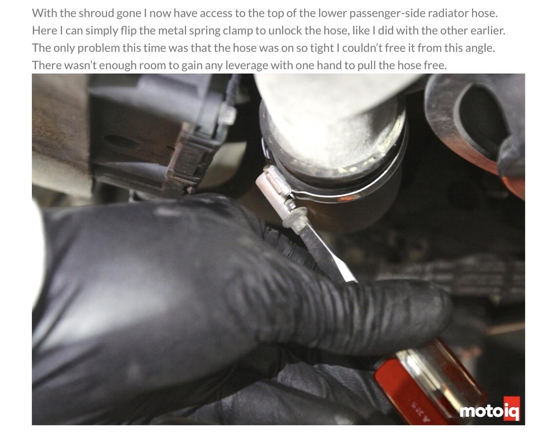

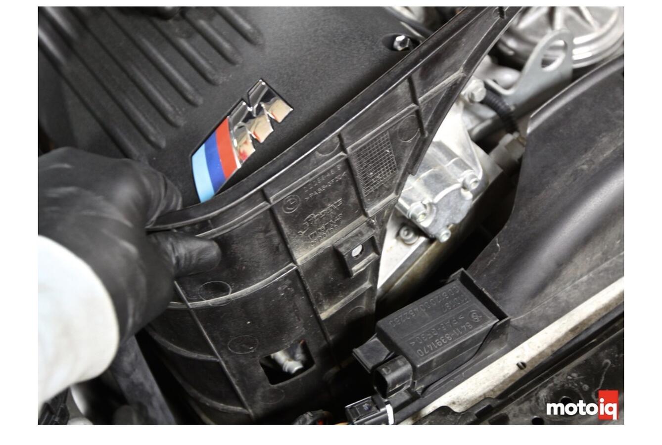

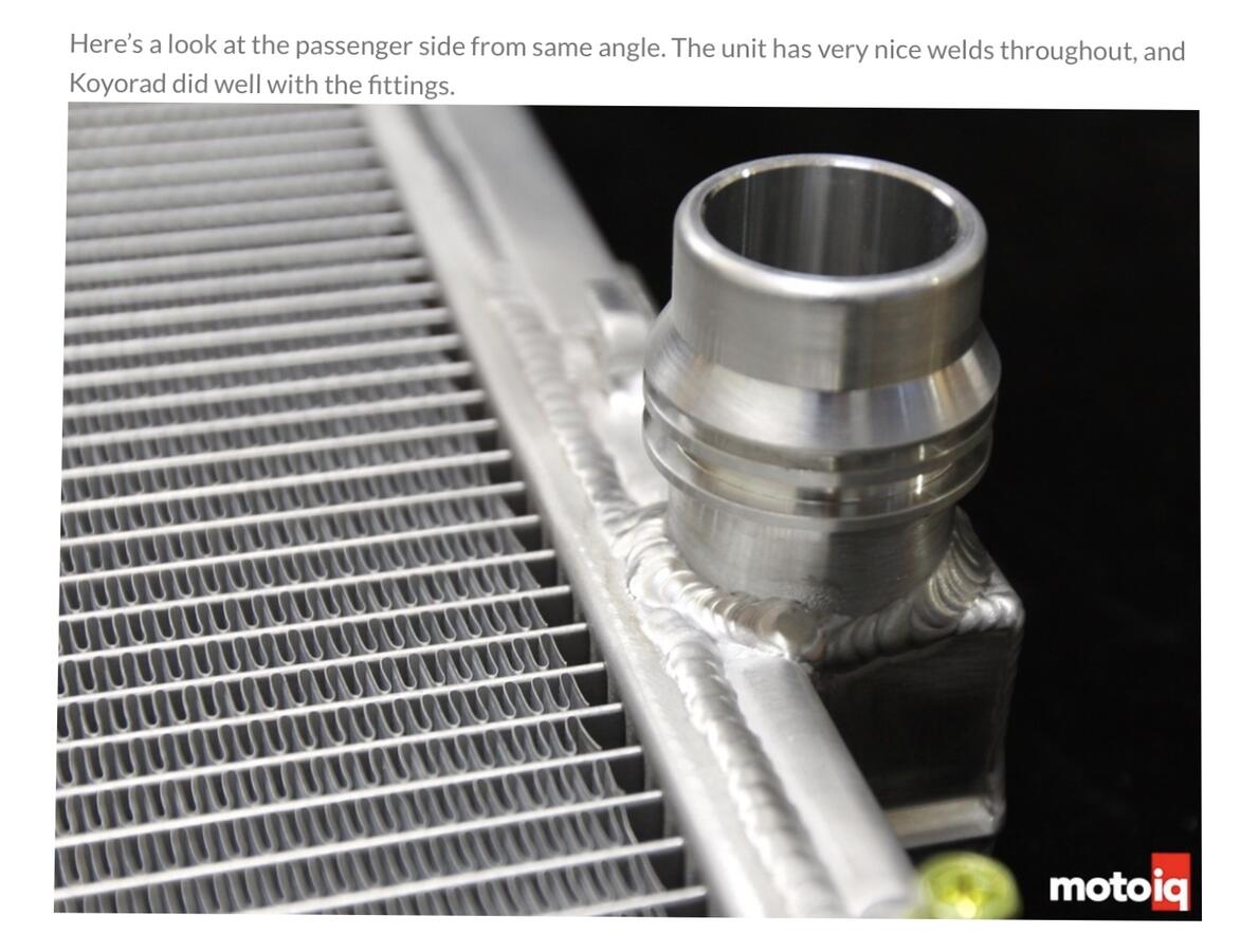

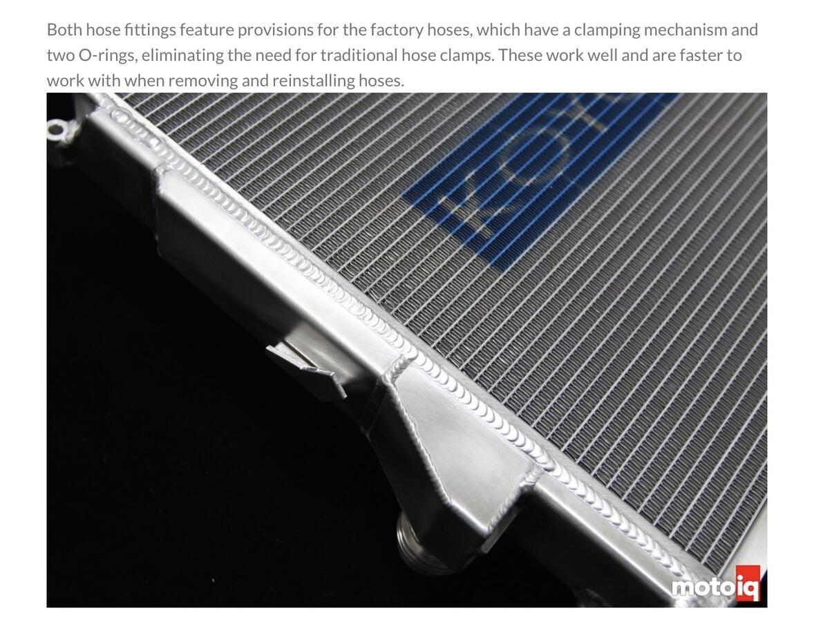

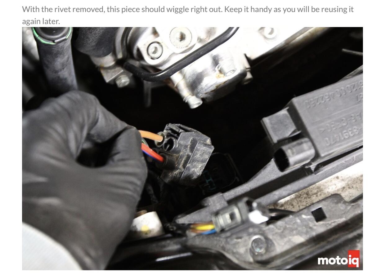

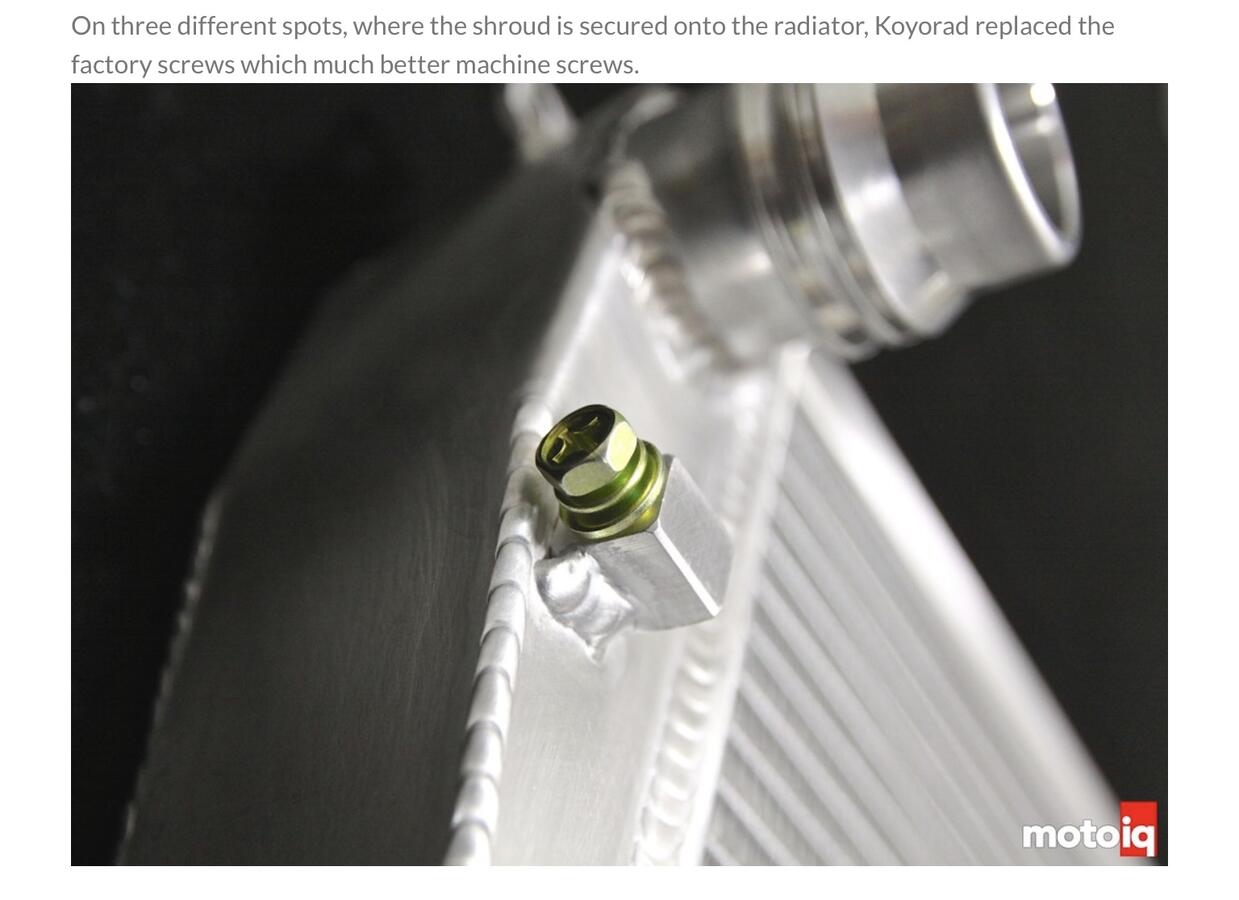

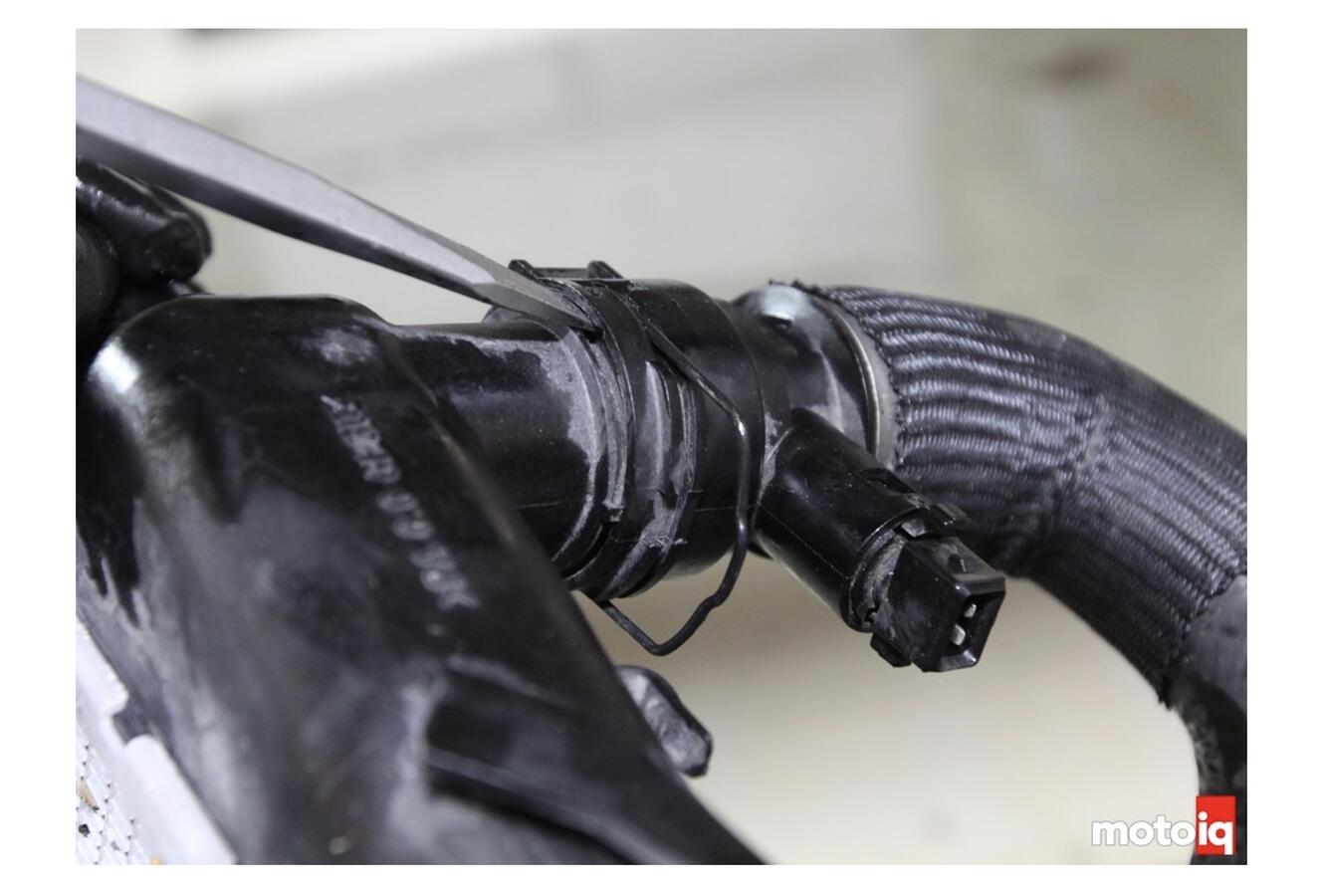

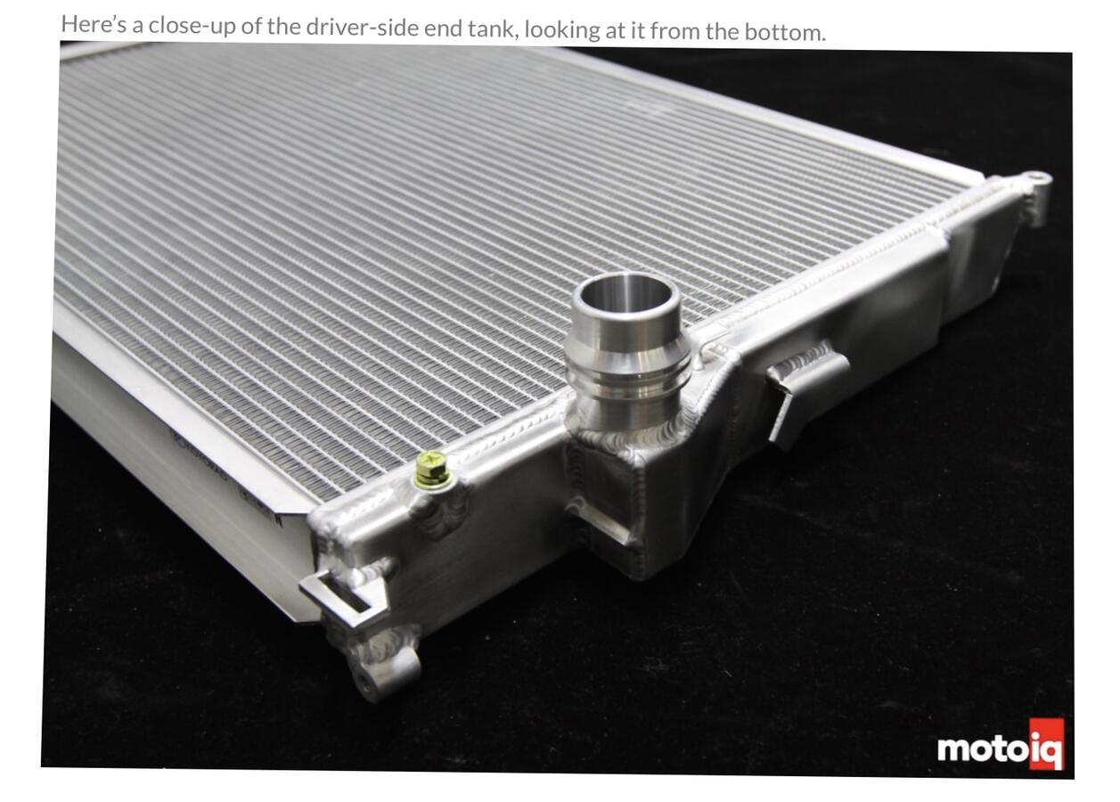

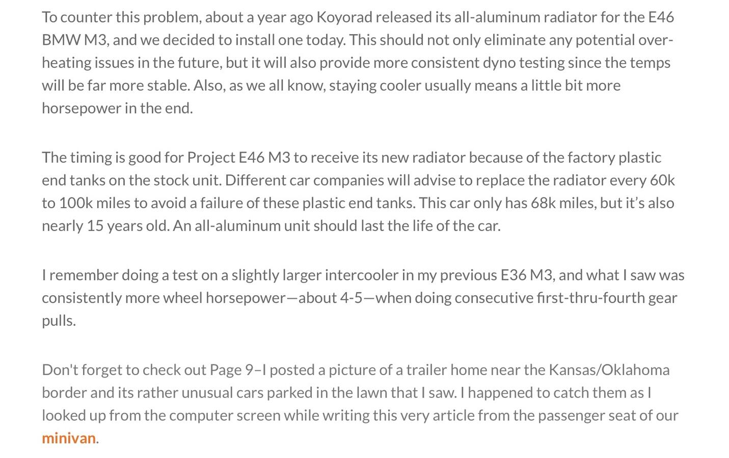

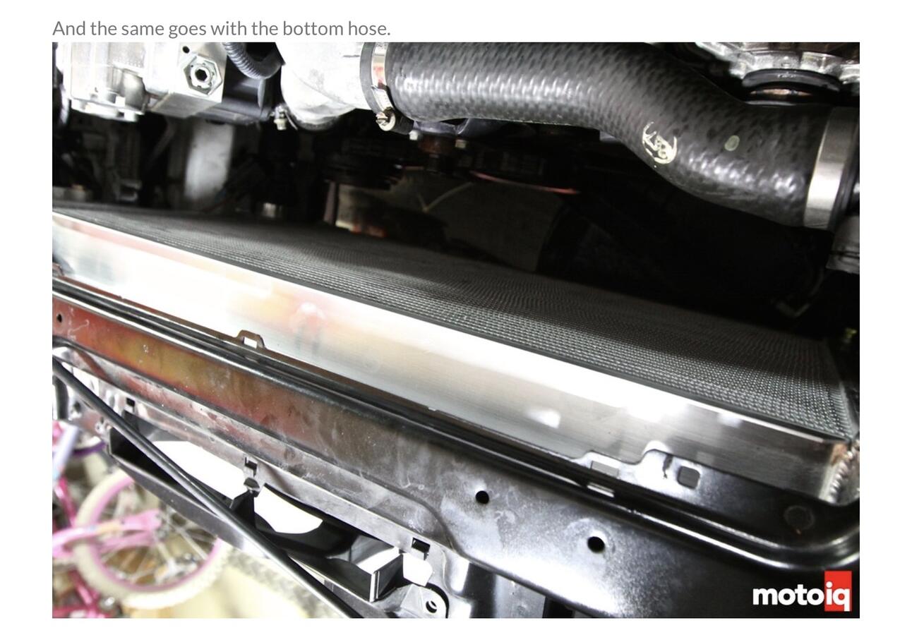

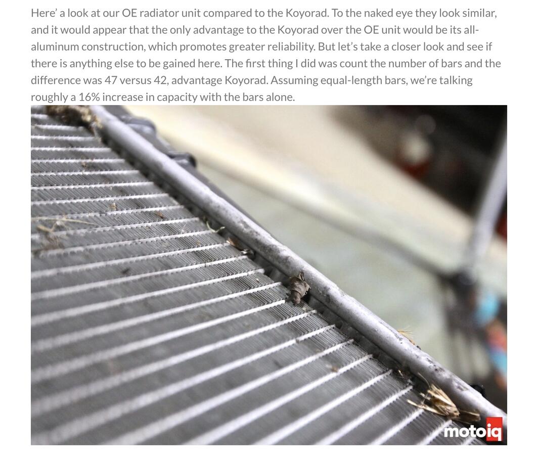

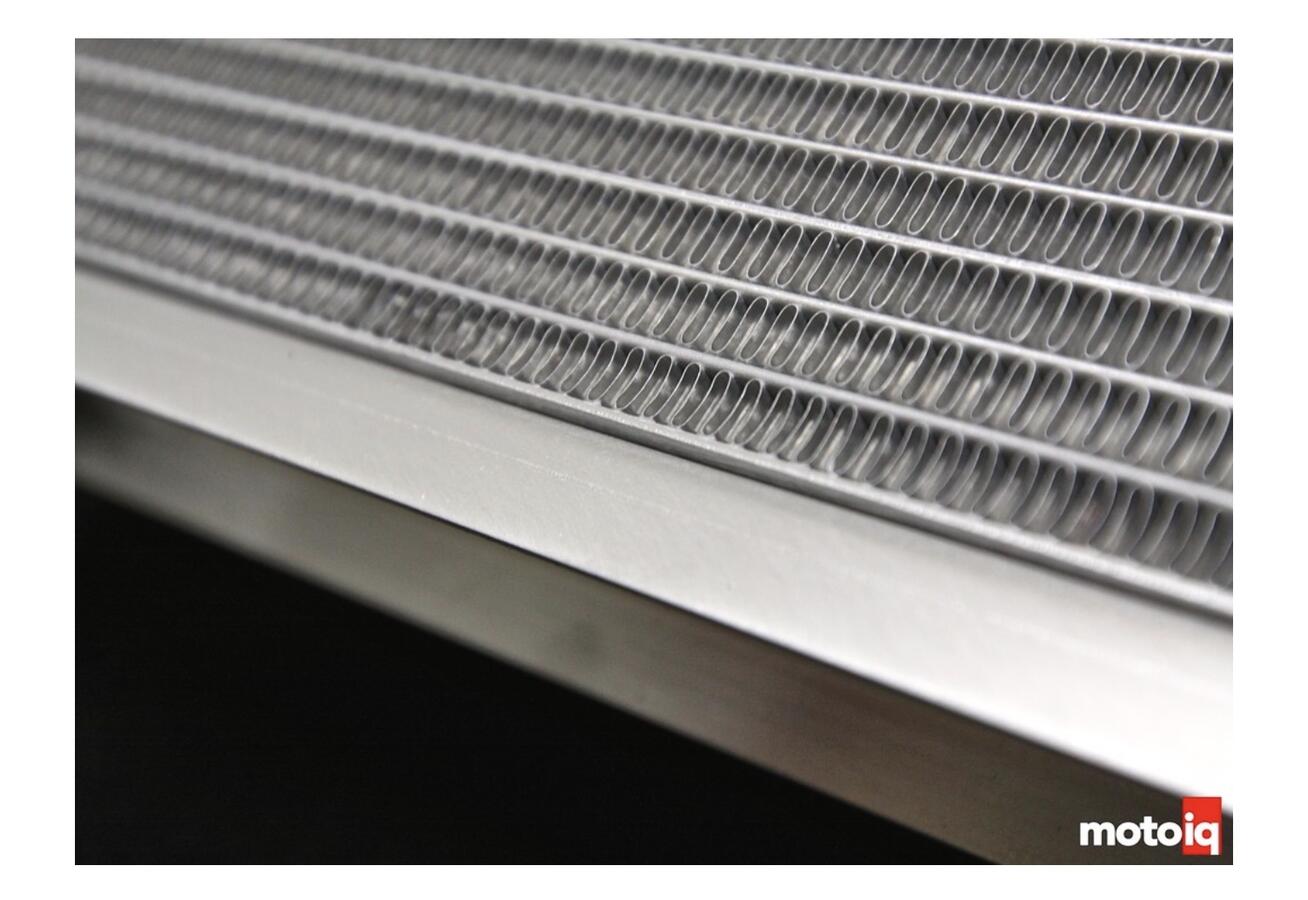

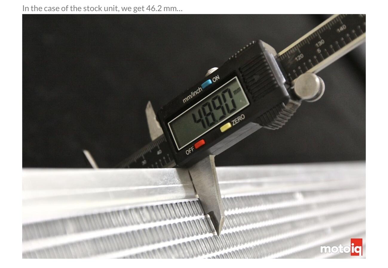

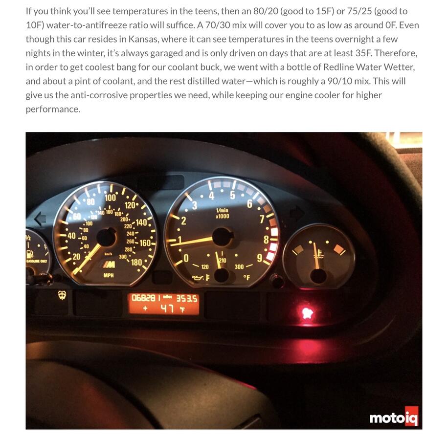

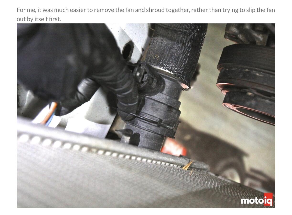

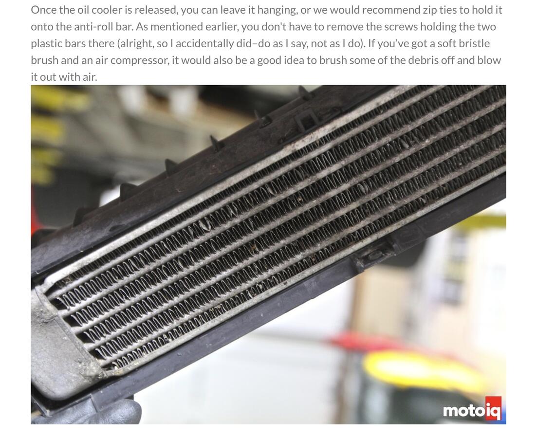

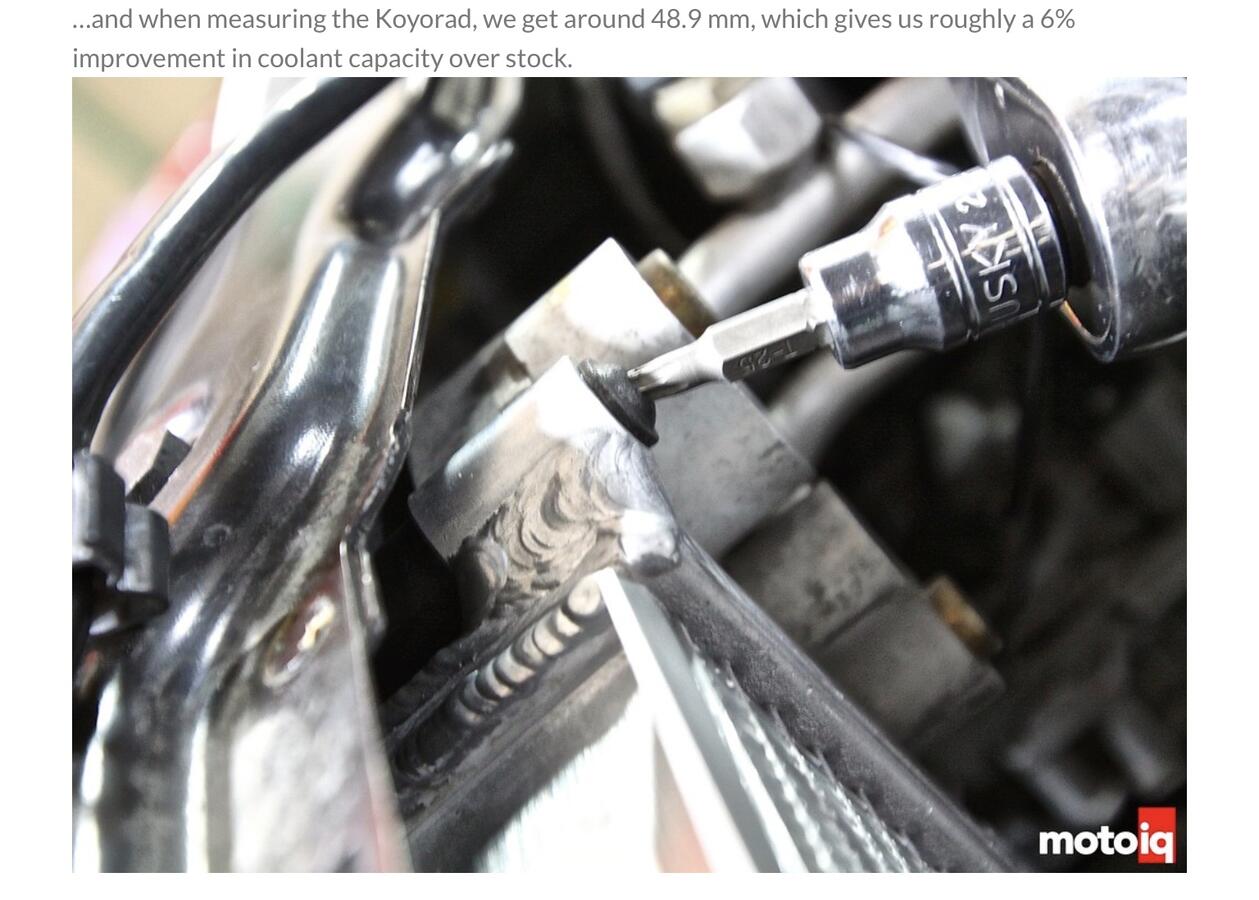

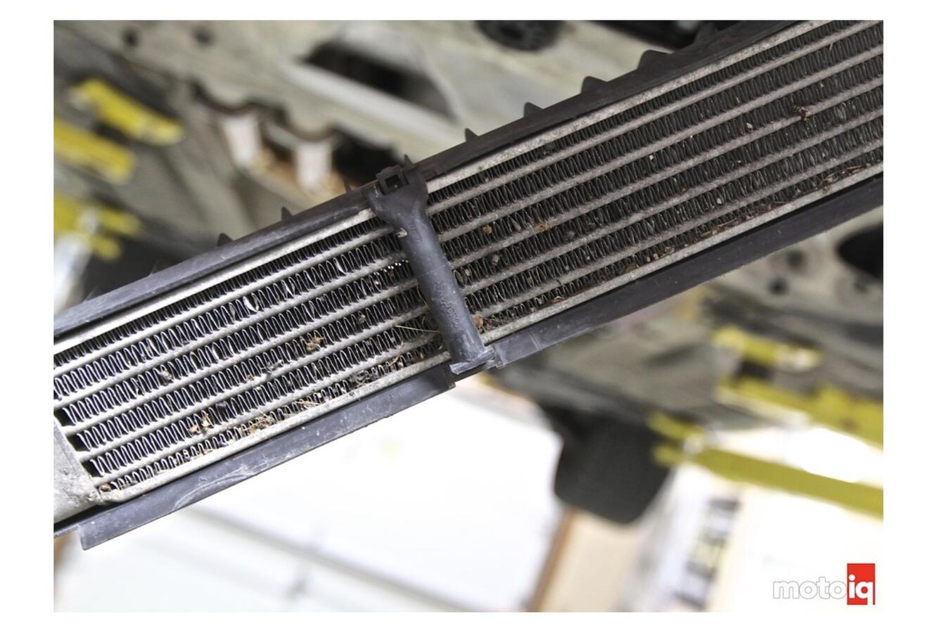

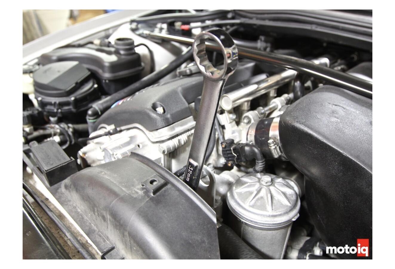

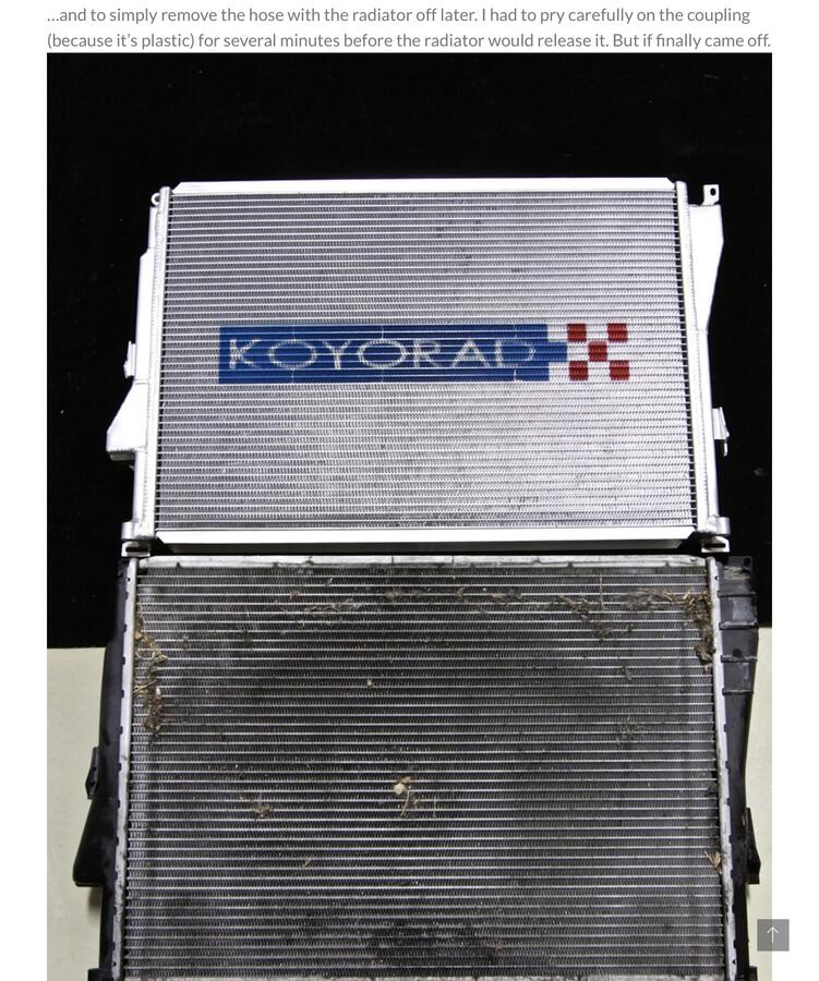

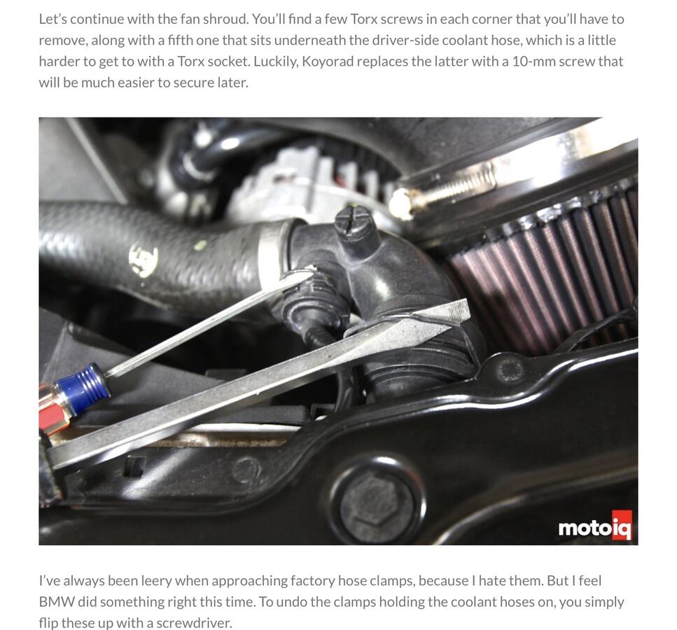

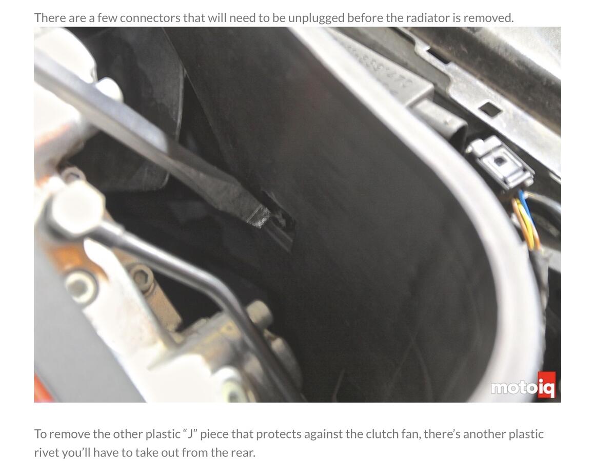

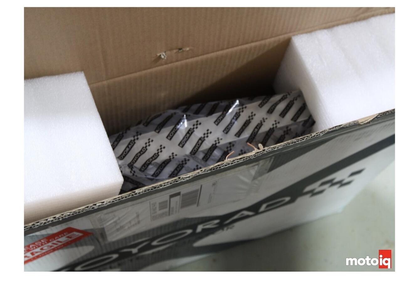

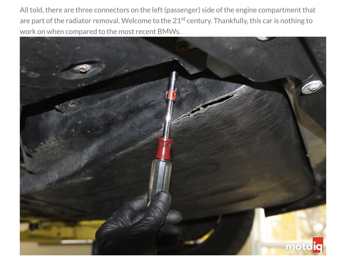

                        From an online magazine called Moto IQ, they some years back, installed a Koyo radiator in their E46M. They produced a good write-up with many pictures. The web address to original article and the article itself is below.
                        Project M3: Part 16 – Koyorad All Aluminum Radiator Installation Cool Runnings by Pablo Mazlumian When it comes to our Project M3, most of its upgrades could be labeled as…
