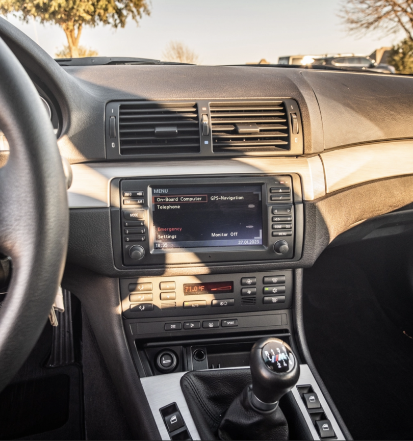

    Here’s my current set up

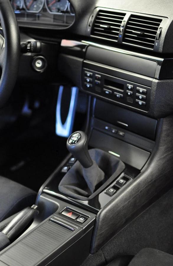

    and below that is what I’m going for​
    I've not done it, but it should be.
      I’ve thought of doing this but keeping the equipment in the trunk to maintain sound capability. I would just leave it on aux input for my Bluetooth adapter and adjust the volume on the steering wheel. I guess I would be somewhat of a radio delete poseur but there is some weight to lose with just the head unit and no more dealing with dead Hyundai ionic 5 sized pixels would be nice
        I have done exactly this before.
        Yes, it’s just that simple. From what I recall you will need the radio-frame mounting bracket to move the HVAC control panel upwards. I remember the job being super straight forward, and taking less than an hour—albeit I was removing one of those massive android tablet units instead of the OE nav so YMMV.

                        You are correct on all parts needed. I just did this exact modification. I find it cool that bmw made radio delete plates.

                              I think it's because some CSLs came with no radio specc'd. Comes in CF and plastic.
