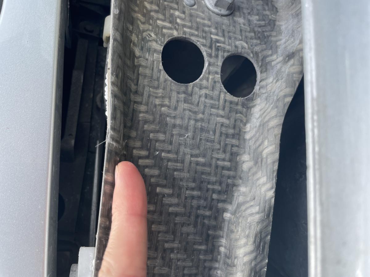

        My insurance adjuster said the crash bar neesed to be replaced which i initially thought was just her racking up the estimate but i do however now see that it in fact it does have some damage but im neither sure if it was related to the accident nor whether it has any impact at all on the structural soundness of the crash bar- if it was steel obviously nor but not sure if this basically could compromise the composite material

            not sure but hopefully so. i did a horrible job capturing it above, but if you were to rotate the pic 90 degrees clockwise, youd see a small bit of fiber peeled/delaminated near the top of the crash bar. fairly confident it can be reused but idk its a composite so maybe not?
              #51
              I wouldn't be too concerned about that minor defect. Take a better photo, you can usually see a break, but it's great with point impact resistance, so I'd just reuse if it's not very apparent. **I'm no engineer***

                Little bit better

                  It‘s replaceable. 2k or so new

                    I'd say it depends...that's an additional $2k closer to totaling it out... but if you're intending to keep it, I dont see why you'd need to replace that unless its visibly compromised once you remove and inspect the other side

                      Insurance is going to want to fix it, I know it seems trivial but their goal is to return the car to the condition it was before the accident.
                      With that said, that one is in waaaaaay better shape than the one on my car...
