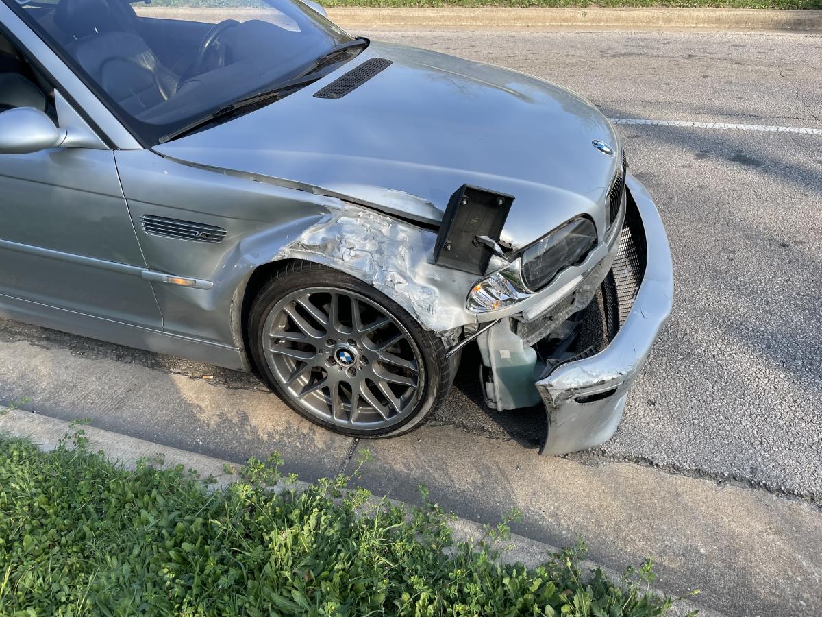

    Well just a little over a week of enjoying the new airbox i manage to get hit. What do yall think the possible outcome from this is?
    Shouldnt be totaled based on that pic alone. But need to check the frame rail to see if its bent or damaged first.
      Looks fine
        The apron is certainly damaged, would that mean frame rail damage?
          You just need some milk, and the car needs duct tape. Joke aside glad you're ok, but as long as the frames straight should be good.
            Should be repairable from the photo, get yourself a new radiator and front clip refresh!

                Im sure the car is structurally sound but my worry is their appraisal process which will throw in verts and SMGs into the market valuation and based off the cost to repair vs replacement value call it a total

                      I'll tell you how I think this will play out. On the surface, you need a new hood, new bumper, new fender, new corner lamp. Then the shop is going to quote you to paint the entire front end to blend it into the driver fender and both doors. Before you know it a $10,000 estimate is generated. Total loss. If the suspension or the shock tower is damaged too then forget it.Is it fixable? easily with some used parts as long as there is no suspension or shock tower damage. You gotta find a shop that isn't going to quote you some insane number to repaint half the car. Stick with whatever needs to be replaced/repainted. Otherwise, with the crazy cost of parts/labor and bodyshop greed nowadays you're looking at some ridiculous repair cost.

                        Exactly what im bracing for especially when their insurance comes back and says theres an smg vert locally i can buy for 15k. I think the shock tower should be fine but the strut support piece is definitely busted
