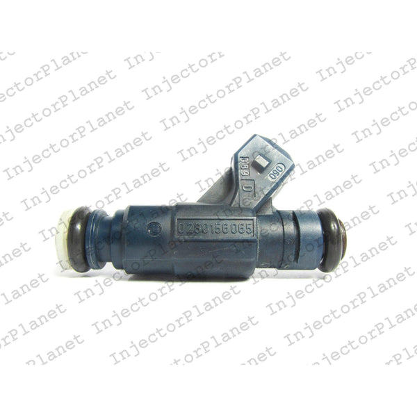

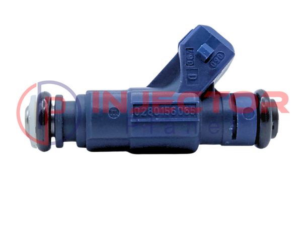

                    Doing some more digging, found these injectors
                    Bosch Part # 0280156065
                    Seller stated they are a direct plug and play for S54, looks like it is also used on VWs and Audis. Not sure if anyone has had any experience running these.

                      And found them here, both same part numbers. One is blue and the OEM Bosch for our cars is black.
                      Could this be a direct replacement indeed?
                        They are not exact but very close. 263.8 cc per minute where as ours are 268.4 cc per minute.

                          Damn that's the best lead we've had yet, would they actually fit? o-ring looks to be lower down? Who's gonna take one for the team

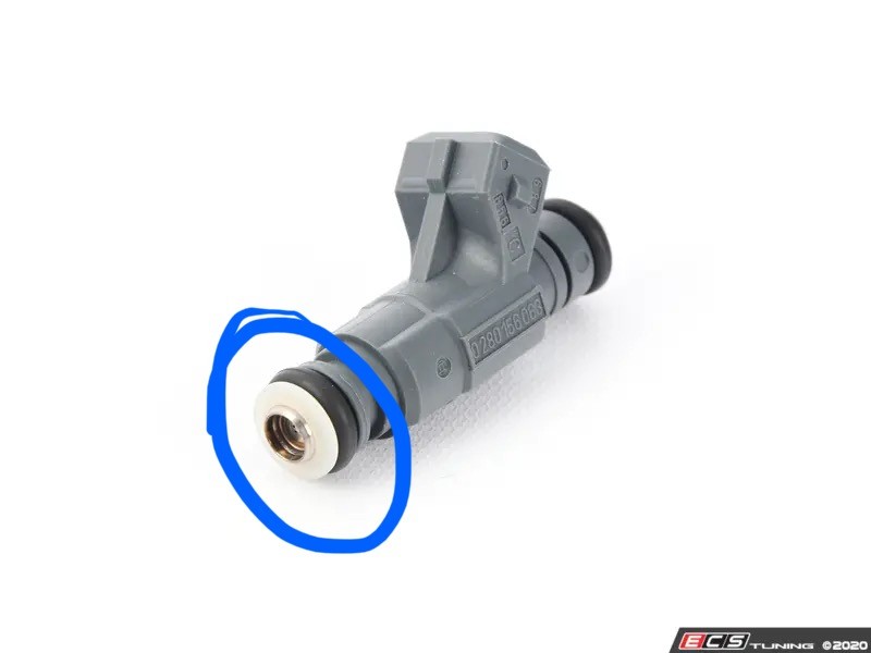

                              dl.m3 ZiMMie Just received the 62431 injectors. Did y’all remove the white plastic ring and o-ring, and install an OE o-ring in the OE injector location? That was my plan, but I’m worried I’ll damage the injector if I try to remove the plastic ring. It’s on there pretty tight.
