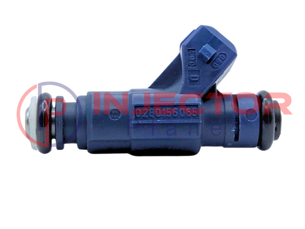

                    Doing some more digging, found these injectors
                    Bosch Part # 0280156065
                    Seller stated they are a direct plug and play for S54, looks like it is also used on VWs and Audis. Not sure if anyone has had any experience running these.
                    Current:
                      And found them here, both same part numbers. One is blue and the OEM Bosch for our cars is black.
                      Could this be a direct replacement indeed?
                        They are not exact but very close. 263.8 cc per minute where as ours are 268.4 cc per minute.
                          Damn that's the best lead we've had yet, would they actually fit? o-ring looks to be lower down? Who's gonna take one for the team
                            OE injectors are close to maxing with bolt ons.
                            189,7 g/min.(VW) vs 193g/min S54
                            Yea it will run a bit lean at WOT.
                            its better to go over the OE flow rate rather than under.
                            My personal preference is the BOSCH 62431 (06A906031BC/0280156063).
                            they are rated @ 269 g/min, and have your tuner dial them in.
