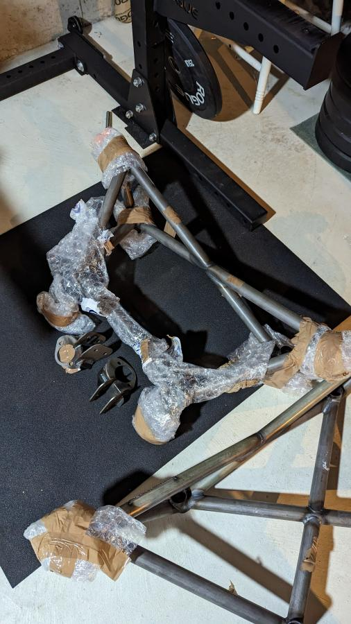

                  Here are some pics of the kits I was selling.
                  On my ZCP track car, I cutted/removed the rear speaker shelf and I was able to fit 4x 275/35/18 18x10 track weels inside the car to go to the track.
                  I can make the main hoop larger or narrower depending if you keep rear panels and B-pillars covers or not.
                  My LSB has the interior completely removed now so I would be able to do custom stuff / take measures / use the car as a jig! I can add a diagonal from main hoop to rear shock tower, make an X-brace between rear shock tower instead of straight tube, make B-pillars gussets, make 2 diagonals/X between rear shock tower with same kind of gussets as main hoop but on vertical tube vs horizontal, make difference base plates to get the main hoop shift rearward, …

                        That looks great, if you could make a kit that's feasible to ship and have someone else weld, you'd probably sell a lot of those.
                        '01 M3, Imola/black
                          Sold a bunch of those kits shipped all over USA back than. Shipped main hoop wrapped in bubbles wrap and packaging tape and a box for everything else.
                            If I had known about this like 6 months ago I would have been all over it. Just for posterity's sake, how much are you asking for a kit like that with all the options?
                            '01 M3, Imola/black
                              Not sure yet, will have to check how much cost DOM 1.75’’x0.095’’ these days. It will be more expensive than what I was asking 6 years ago.
