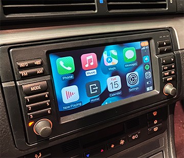

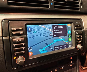

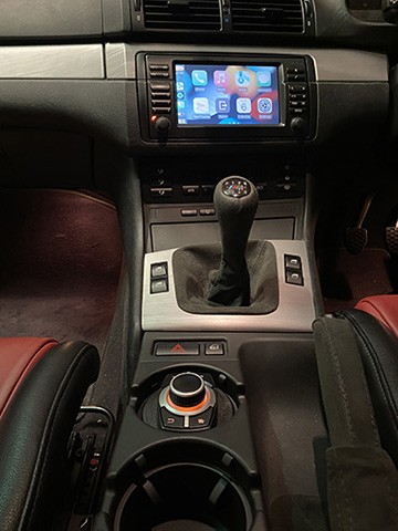

    Can't believe I didn't see this until now! Retrains all original functionality, adds THE critical missing thing (at least, for me).
    Carphonics is a great company that has been solidly supporting the BMW (including e46/e39) community for years. I've been running their upgraded BM53 for probably a decade, with no issues.
    Looks like they have two ways it can be controlled-- either with a iDrive looking controller thing, or with a retrofitted touch screen!

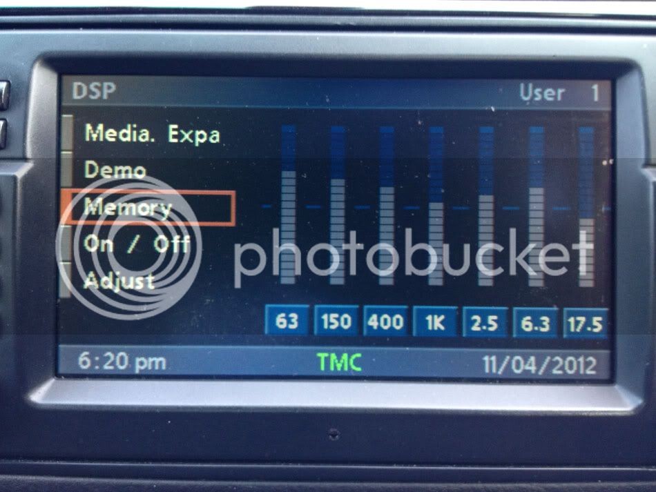

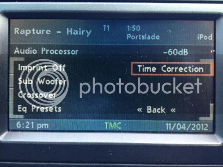

      That said, if you really do care about sound shaping and subwoofer controls, you actually can do it on the stock unit with the intravee/breakout box/alpine sound processor. I had that setup in my M3 back in the day. It could be combined with this carplay unit.

          That said, if you really do care about sound shaping and subwoofer controls, you actually can do it with the intravee/breakout box/alpine sound processor. I had that setup in my M3 back in the day. It could be combined with this carplay unit.
