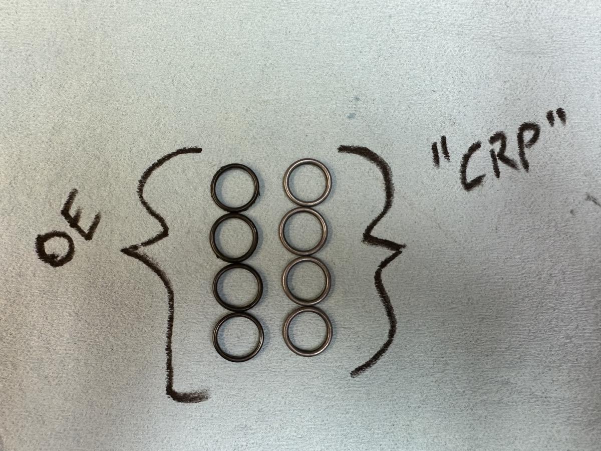

            Can you post a pic?

              I agree, they might hhave put the wrong ones in the baggie. When I compared the new vs. old, there wasn't much difference other than some compression. Aren't they a grey color? Got a pic of the new ones you received?

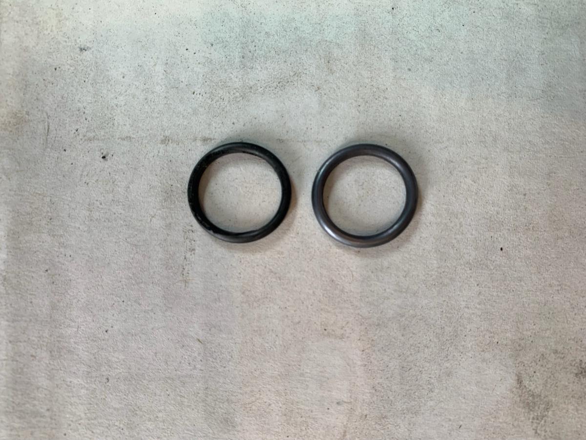

                not sure this pic does it justice, but here they are.
                  Did you have to use the bolt to draw them in or did they just go in by hand pressing them?
                  yes, grey, see above pic

                    Hard to say for sure in the pic, but if you have time to wait probably ordering another set is a good first step.

                      I think the originals just look darker from heat/staining maybe.
                        I looked and had some CRPs in stock, used BMW vs new CRP. Maybe its your technique, IDK hard to say without being there after the info we have now.
