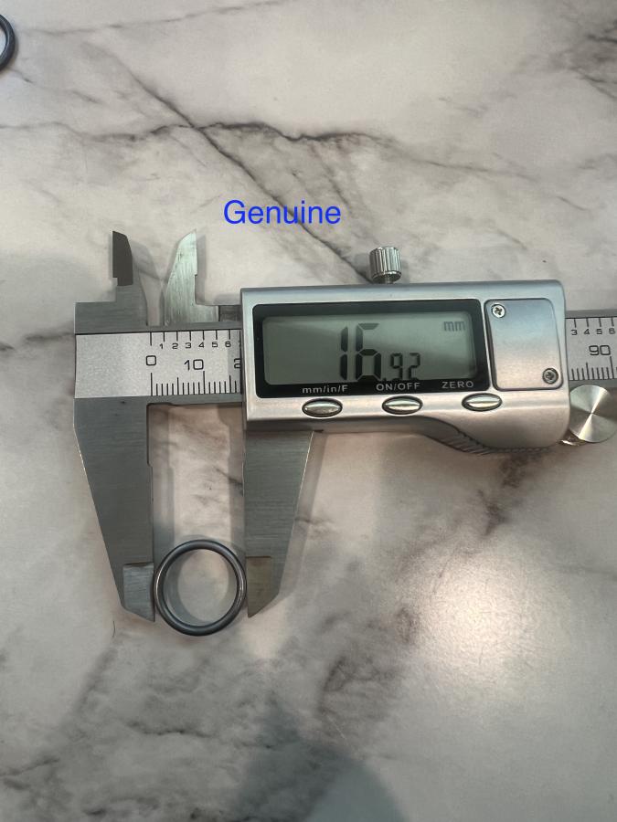

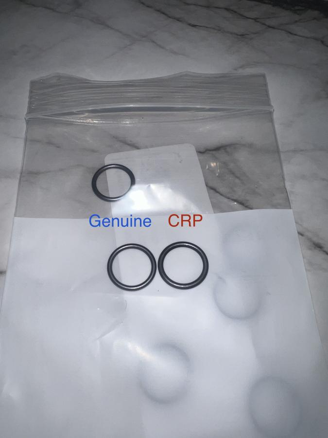

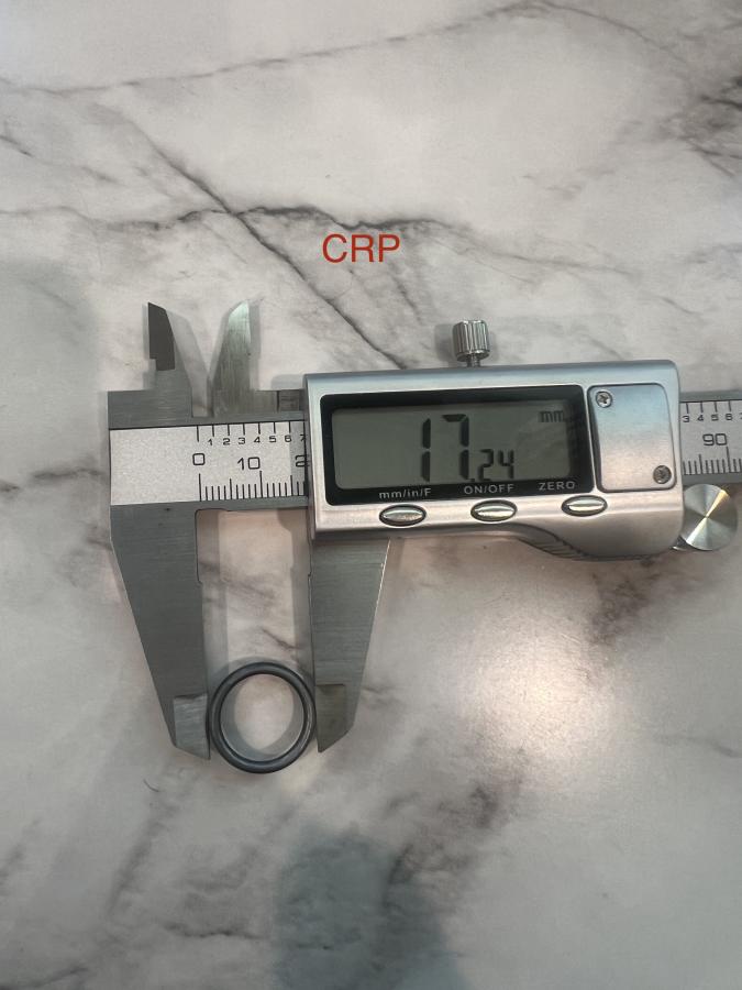

    I thought I would add to this as I had the same issue with the CRP rings.
    Ordered some genuine ones instead and compared.
    CRP's are thicker to the eye.
    I carefully used the caliper on em'
