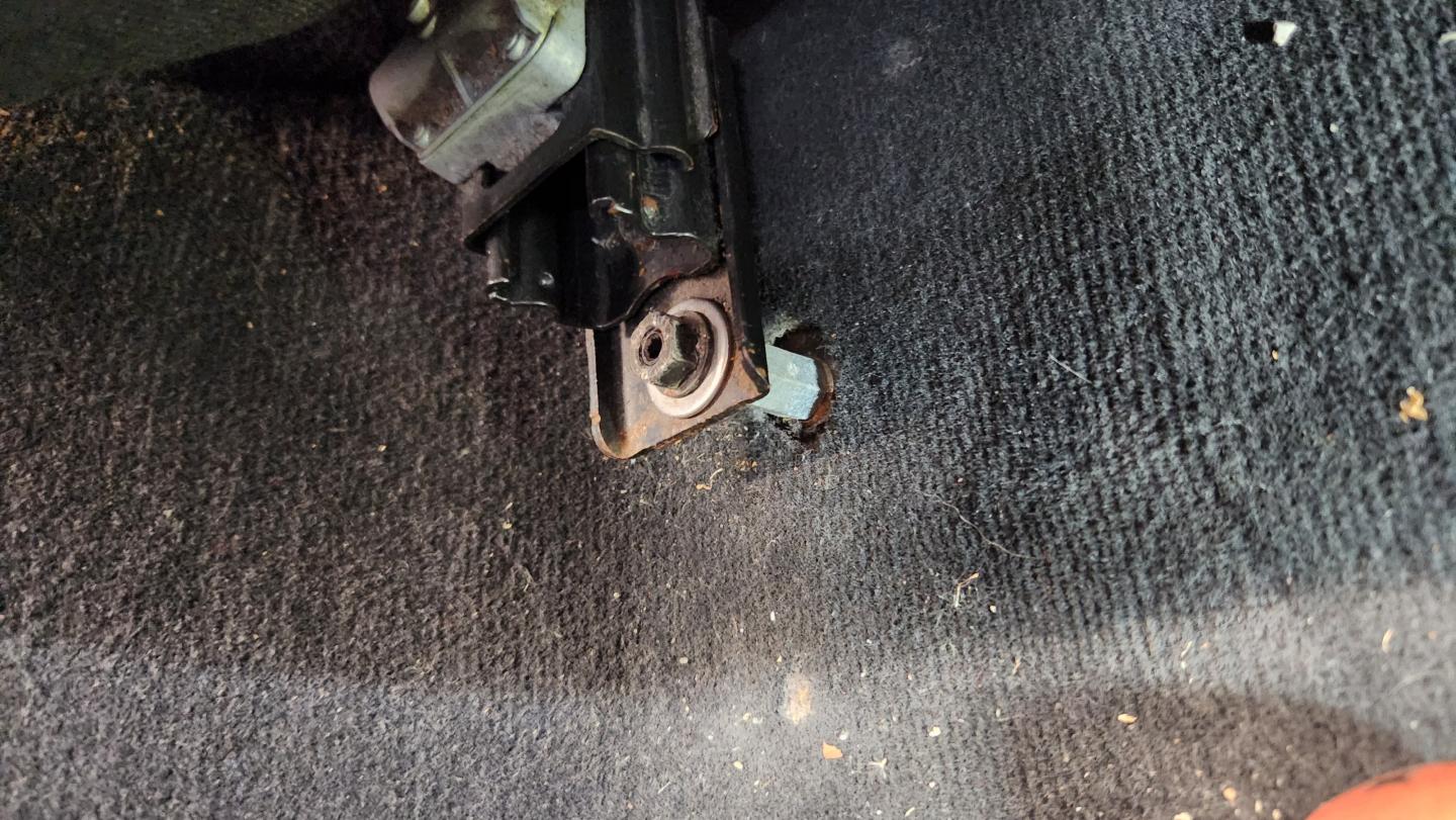

                    I ended up installing these. They work for me, but even at the highest setting are too reclined and for my wife they are still a bit low . We will be custom machining some spacers to raise the whole assembly up a couple inches for her.

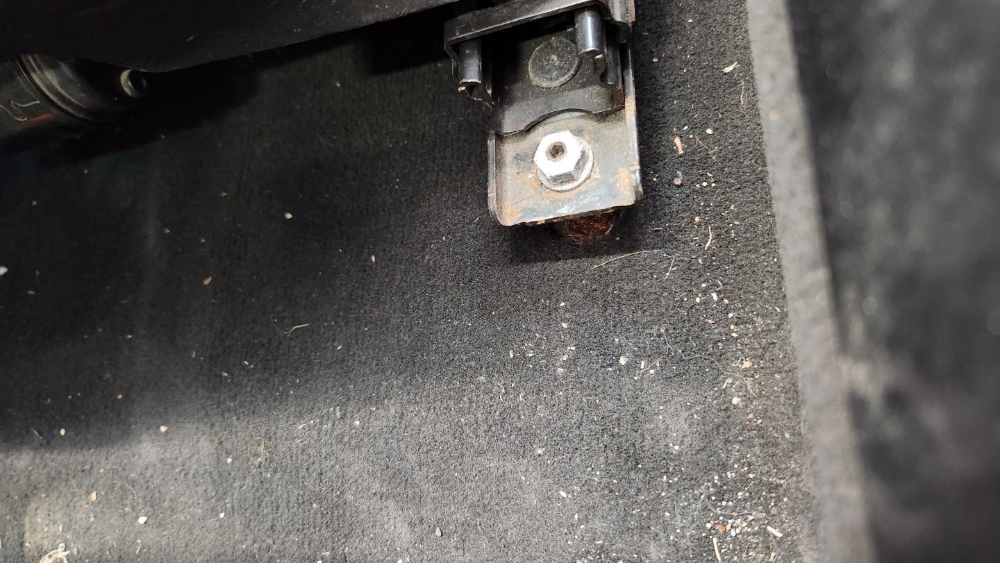

                          I may try something like this 2000 Z3 has (spacers), not sure if they are factory, they are only on the front. This will get my aftermarket seats up a bit more like I want them.
                          Click image for larger version  Name:	20230905_161230.jpg Views:	0 Size:	195.1 KB ID:	232852 Click image for larger version  Name:	20230905_161223.jpg Views:	0 Size:	236.8 KB ID:	232853
