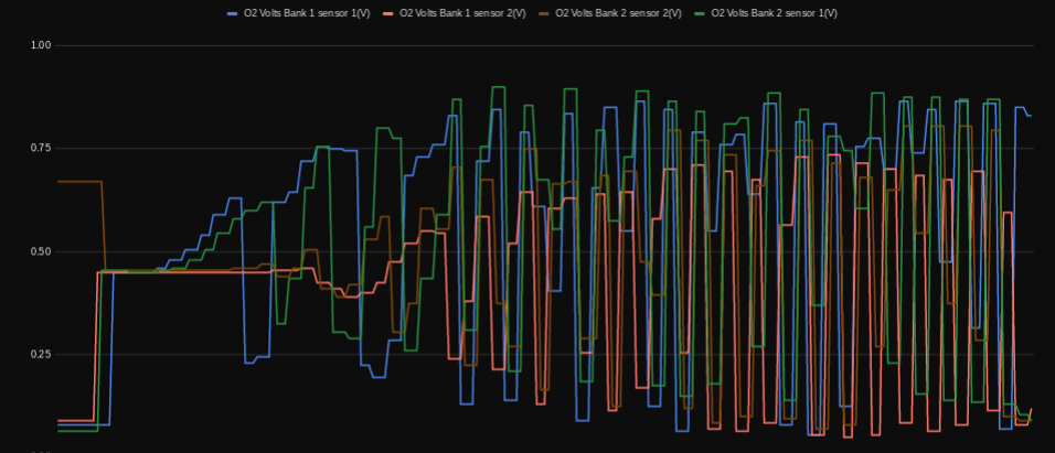

                With the torque app you can log activity and then graph it in google drive or excel. Might be easy to tell if they are going bad from there. However, I graphed mine before I replaced the post cat o2 and they looked fine. Replaced them anyways and it completed evreything but catalyst so I clearly dont know what im looking at. If you replace them and pass I will likely do the same. Wont be able to do another drive cycle till this weekend.
                Edit: looking at it agian it almost looks like bank 1 sensor 2 is lazy. That could be post cat, but like I said I really dont know what to look for.
                Click image for larger version  Name:	Screenshot 2023-04-25 10.35.12 AM.png Views:	1 Size:	104.4 KB ID:	215204

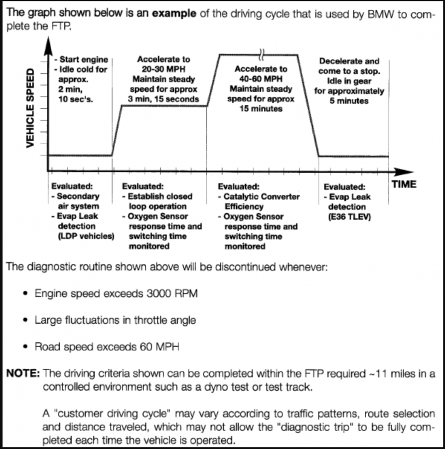

                            Exact steps for how to complete a drive cycle and activate all emissions monitors.
                            EU cats will pass provided the OEM O2 sensors have been properly installed and extended (there is a loom that can be unraveled an extended) Only difference between EU and US cats is the cold start emissions filtering. This only matters if you're getting a sniffer test, which our cars are not subject to. If the car is hot, the sniffer test shouldn't be negatively impacted.
                            Do this drive cycle and activate all of your monitors (check with a cheap monitor scanner that can be bought on Amazon for 15-30 bucks) and you should be good to go.

                              That drive cycle is so ridiculous in terms of practicality executing it on any city streets. Tried it so many times and it’s basically impossible to do during any reasonable hour of the day.
