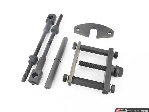

                      I tried the soap method. Either I need to hit the gym or the control arm was too big. Struggled with soap for hours. Got the tool and job was done in 20 min.
                      I've since used the tool for about a dozen other tasks and loaned it out locally. Its pricey but has been worth it. If you're in the Maryland area hit me up.
                        You guys must be better than me, after the dozens and dozens that I have done I have very very infrequently been able to hammer M3 bushings on even when lubed. I usually use two ratchet straps and cups and that works but just takes some time. Awhile back I finally bit the bullet and bought the tool from ECS/BavAuto and it works great:
                        And if you don't want to buy that one, here's one that I've been looking at for awhile. Obviously I don't need two, but I might buy it anyways as it does look like the factory tool and I have an affliction for factory tools. If its still there in a week or two I probably will get it. LOL
