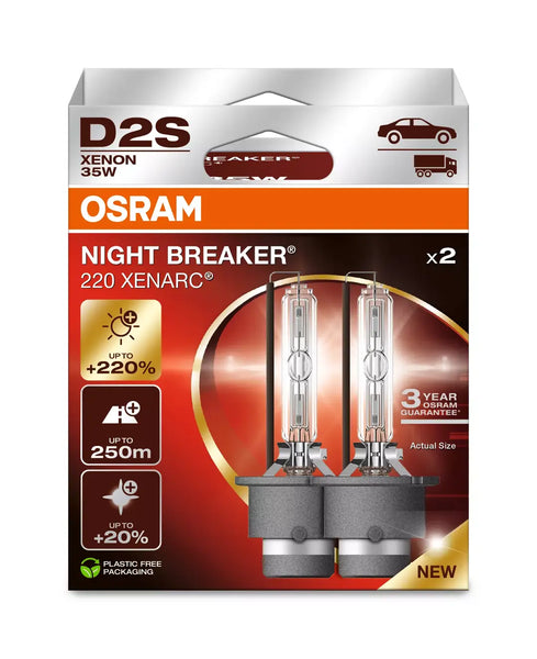

                Fix whatever is broken and get these bulbs:
                The King: It wasn't long ago that the XV2 from Philips was the brightest bulb on the market. No More! Osram's all-new Night Breaker Laser has taken the rank and recently tested to be the BRIGHTEST HID bulb currently on the market. "220 Xenarc" - What makes them so amazing? The original Osram XNB (standard Night Breaker
                I imagine he'll have a Memorial Day sale.
                Then make sure the lights are aimed correctly.
                If you still have some money left over, make sure the headlight lenses are clean and clear.
