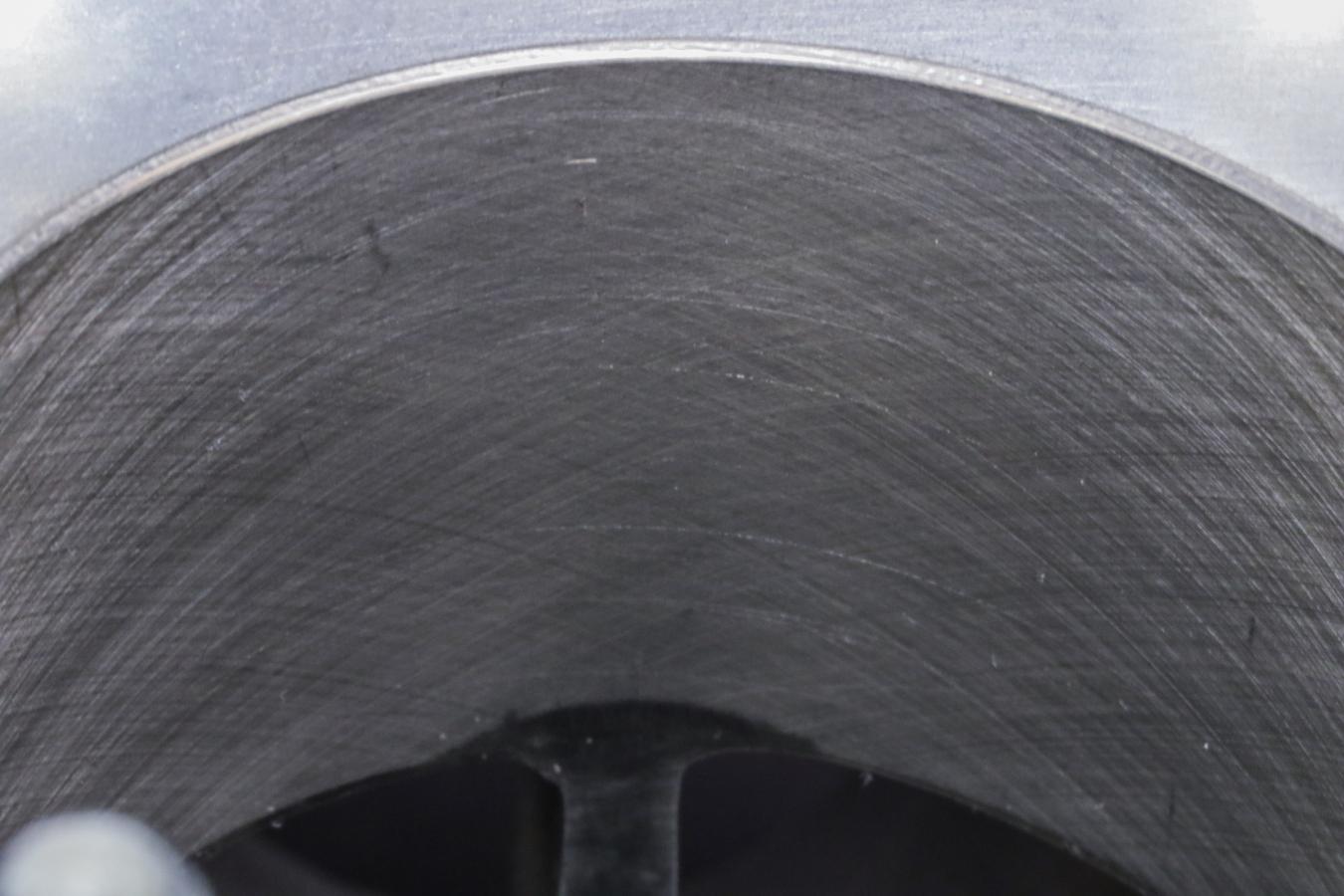

    Are you able to bore scope the cylinders? That way you can get an idea of how everything looks. Hopefully the crosshatching is still there from the machining; otherwise, you're looking for glazing or scoring.
      yes! I’m actually about to pick up a bore scope rental from autozone as soon as I’m done with dinner, hopefully it will be good enough quality to see. What kinds of things should I look for? Tbh I’m not sure what “normal” cylinder wall wear looks like. Obviously a score would be very clear of something wrong, but what else should I look for?
        Crosshatching from the machining process.
