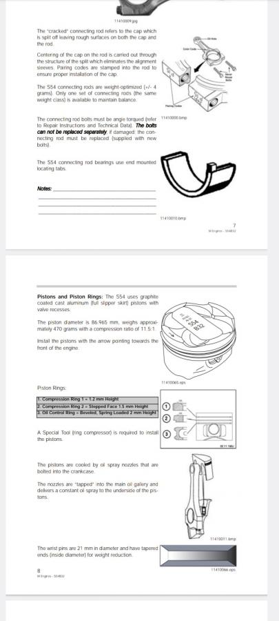

        The bore is 87mm and the stock pistons are 86.965mm. I'm still looking for the spec sheet but I have this so far.

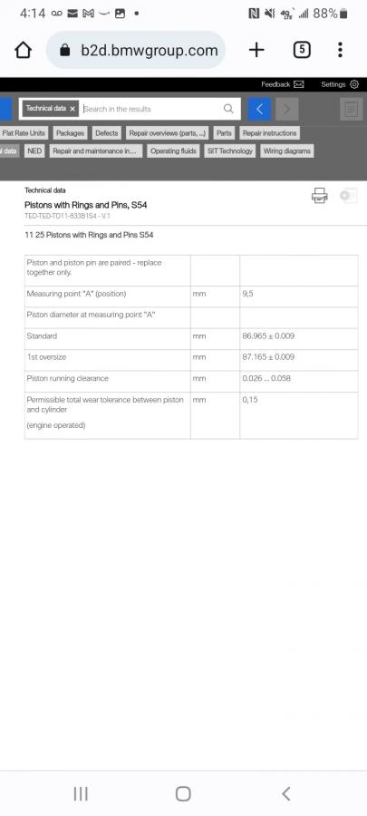

            Found the specs

                Thanks for that info, I do have a question about it though bc I’m confused.
                According to that spec sheet, there is a .035 difference from piston size to bore under stock conditions. currently my bore was honed to 87.25 and used CP pistons of same diameter. If there is a .0035 gap clearance now, wouldnt that mean my tolerance is tighter than before?
                I’m not sure of the actual measurement my bore came out to be, however I will reach out to see if I can get that.

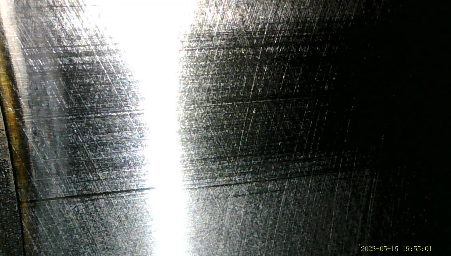

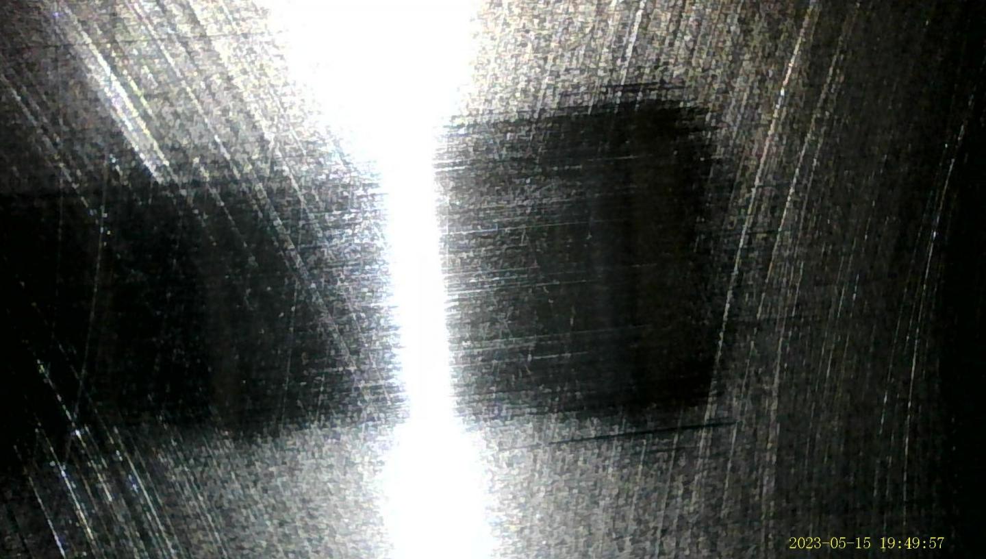

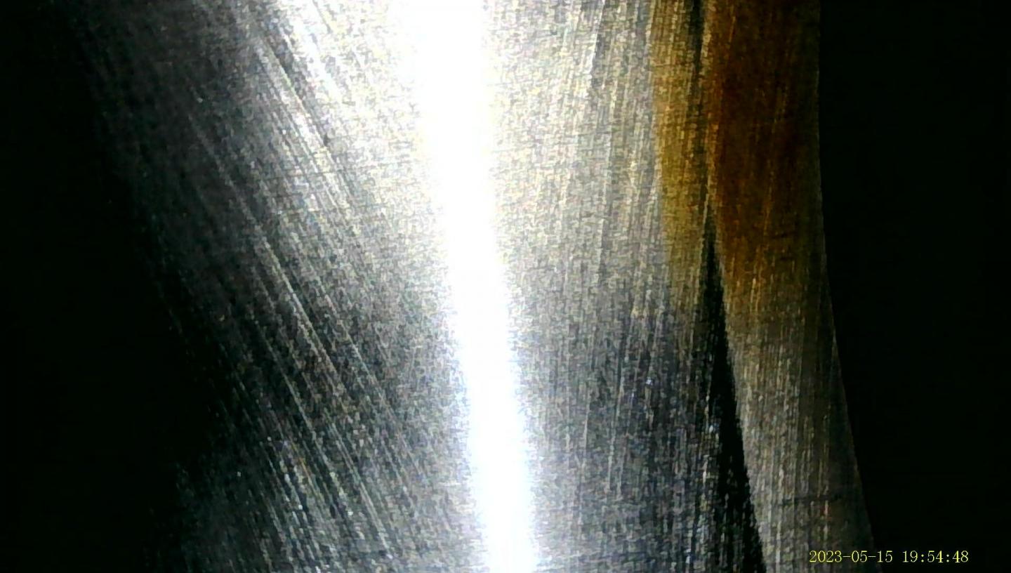

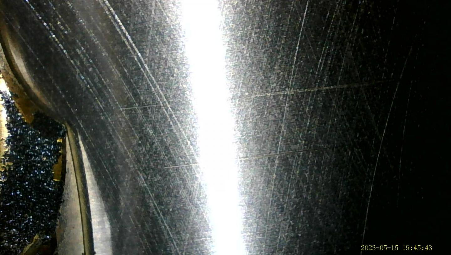

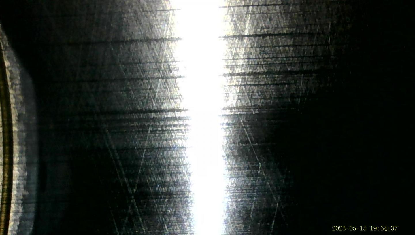

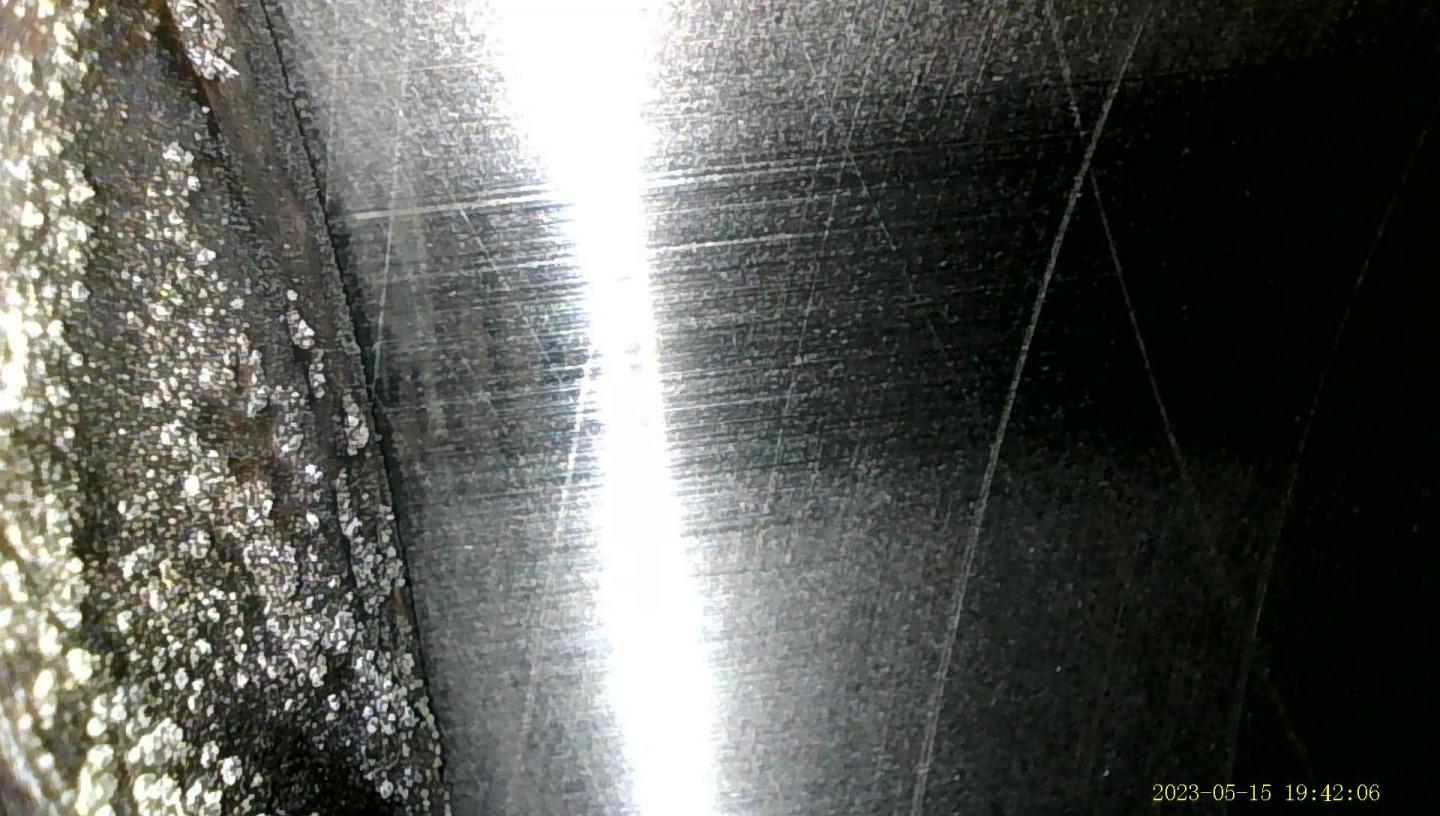

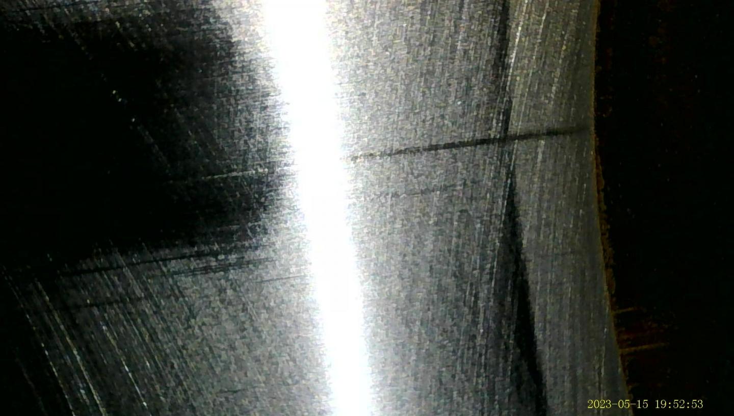

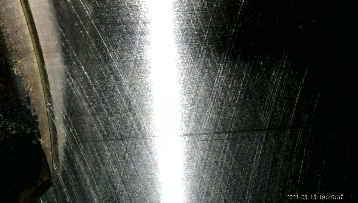

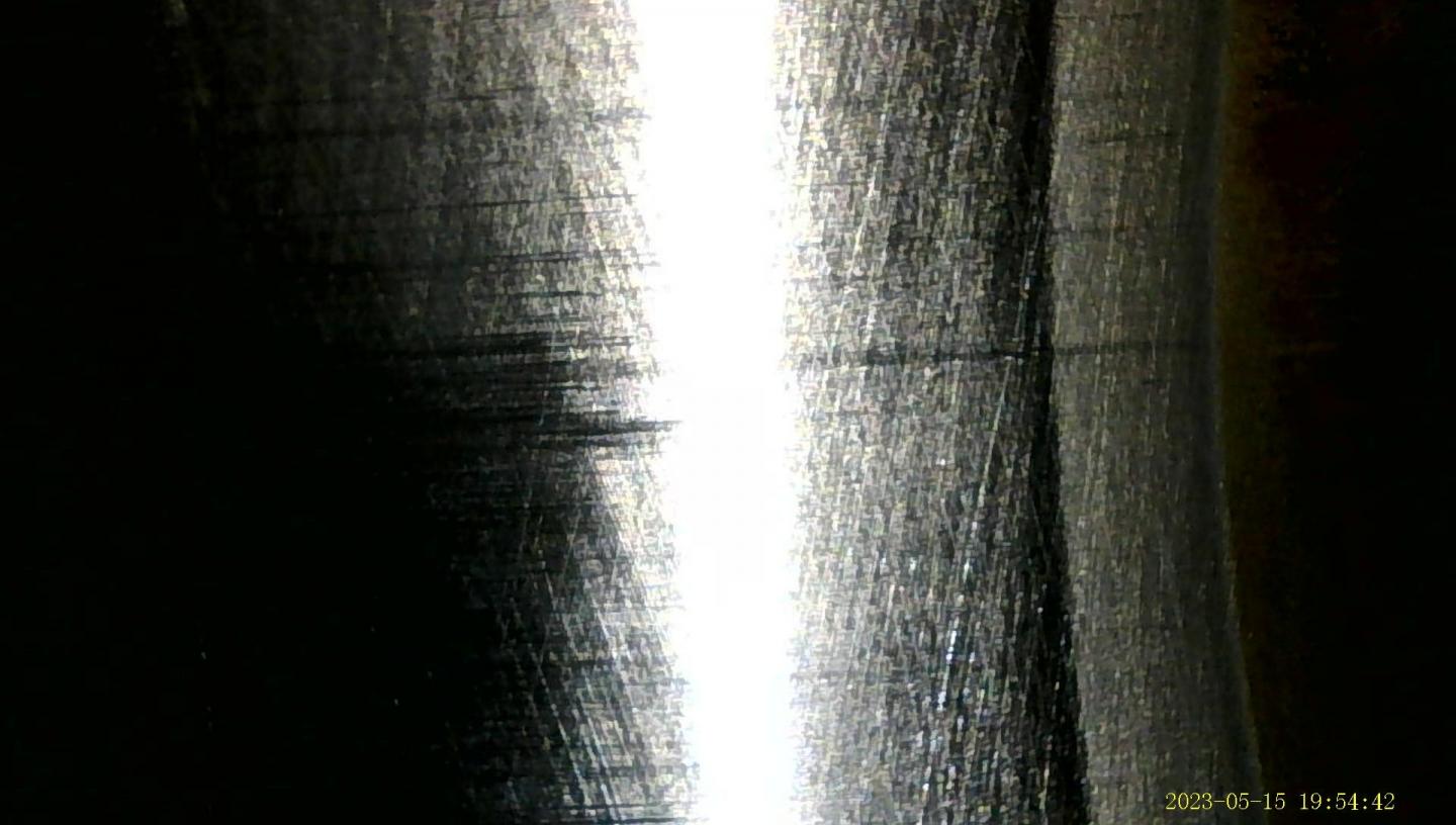

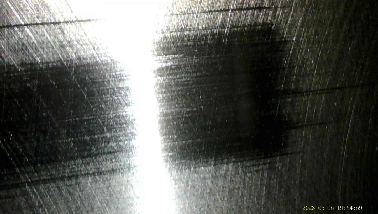

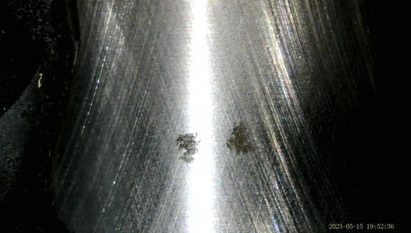

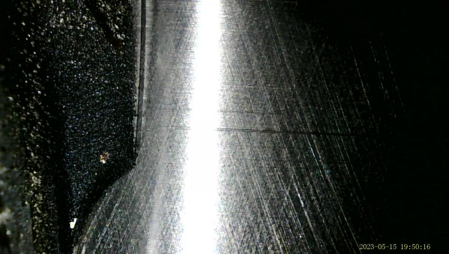

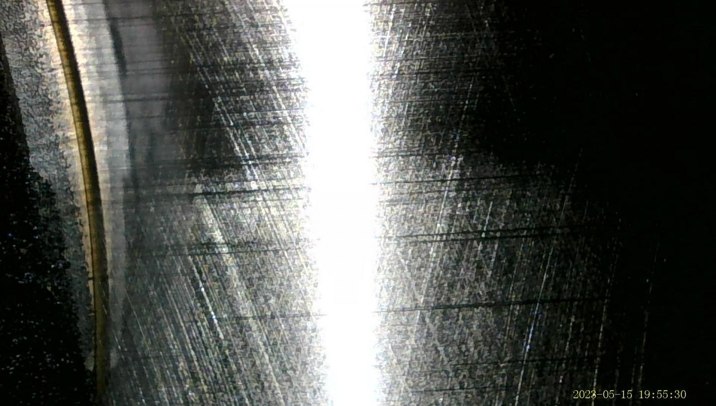

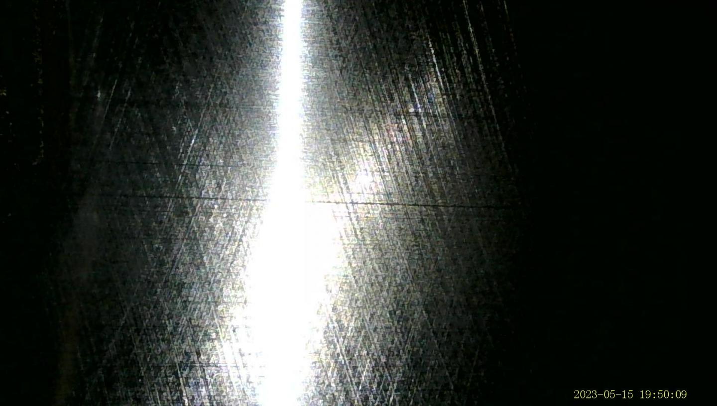

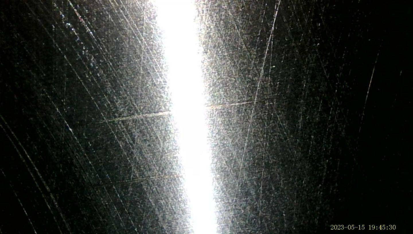

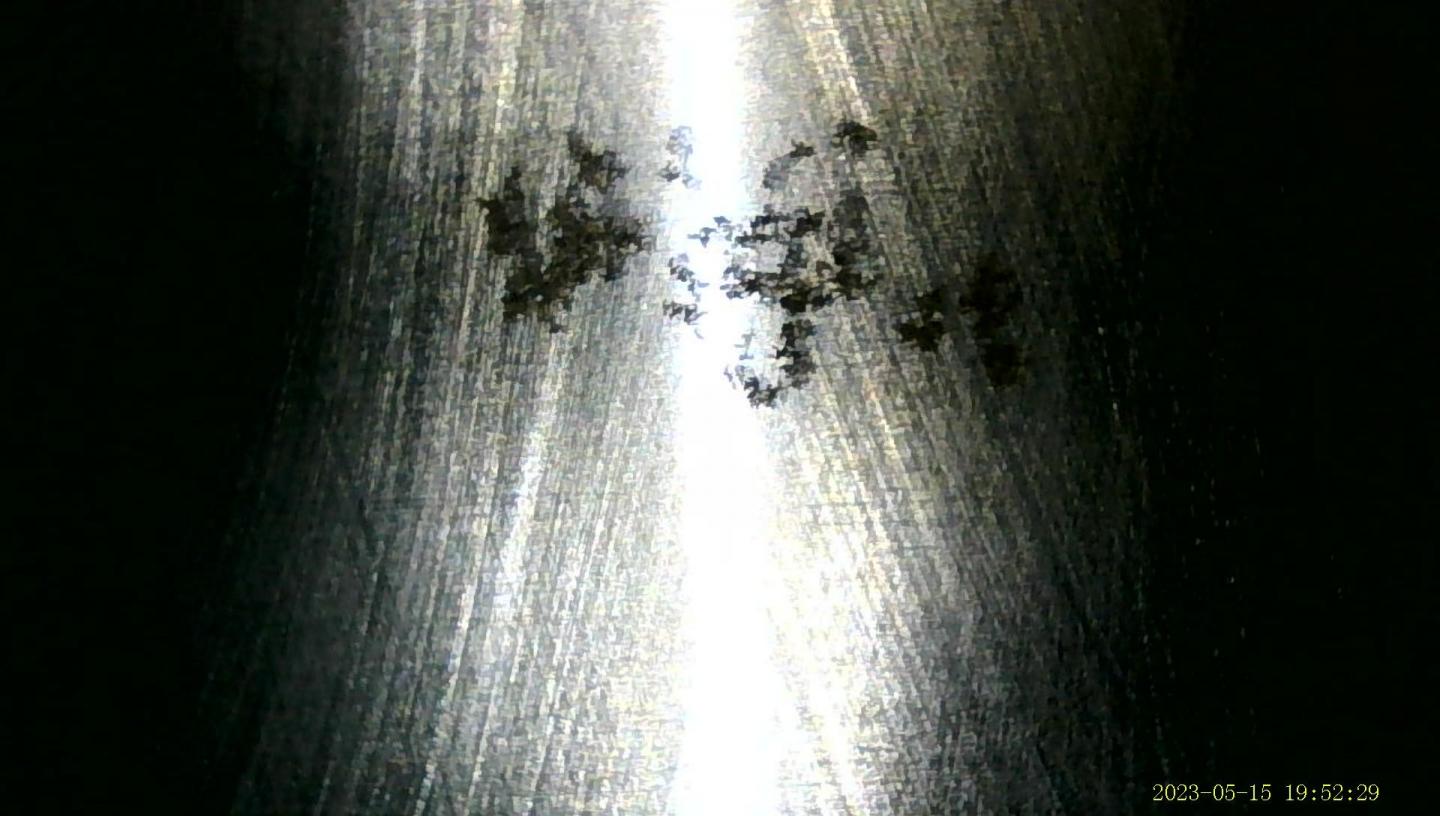

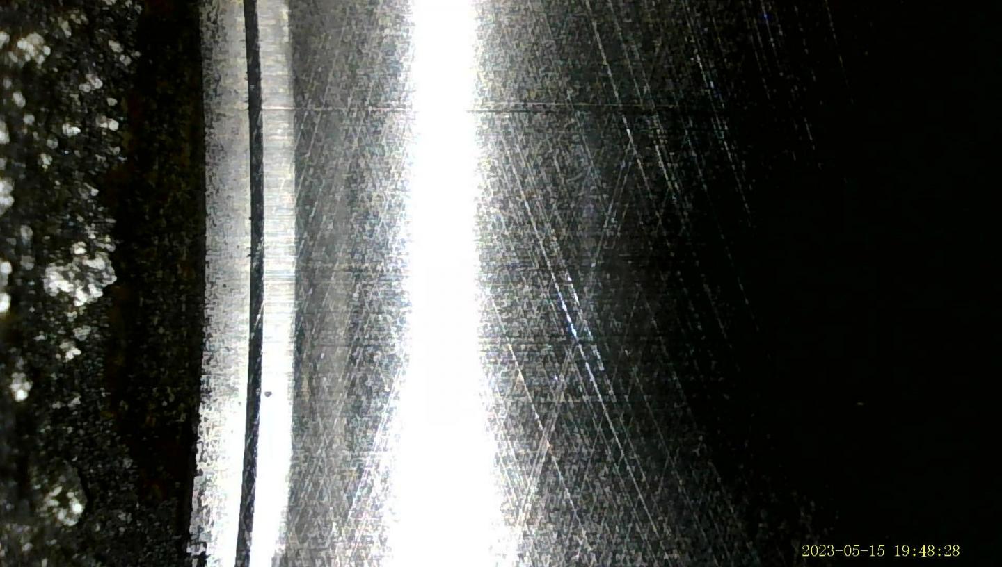

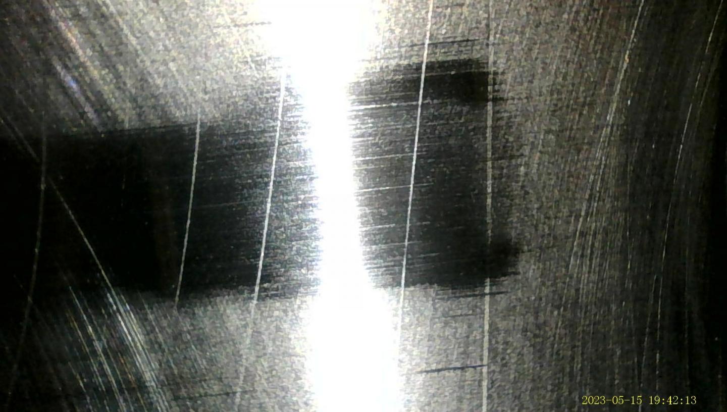

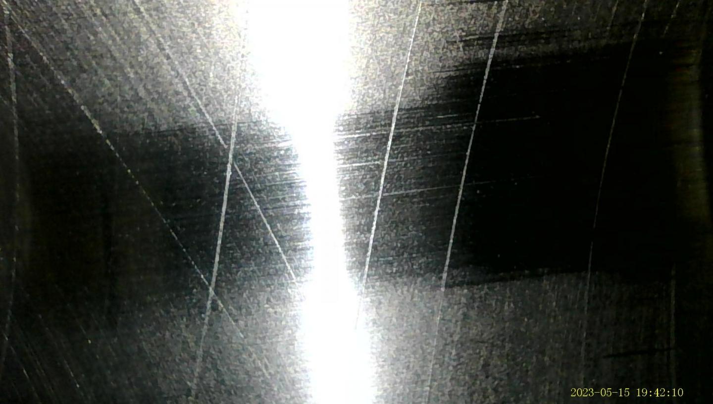

                    Just got the bore scope, I’m seeing some things, and what I’m seeing definitely doesn’t seem normal…
                    I will post pictures soon once I go to the store to get an SD card for the bore scope.

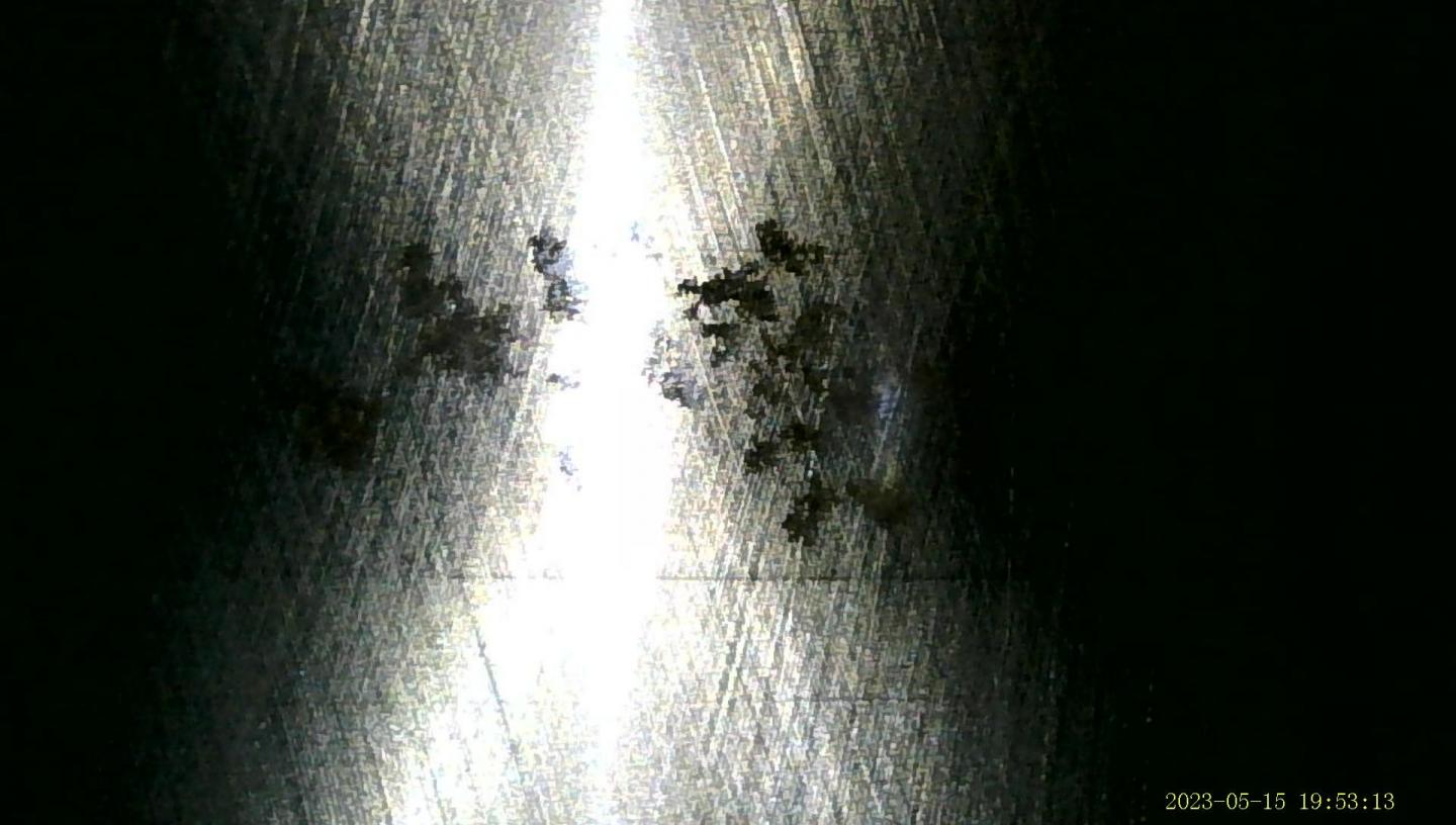

                      Ok, here it is. All the pictures are labeled which cylinder they belong to. Cylinders 1,4,5, and 6 all seem to have these wide dark spots of marking, while the other cylinders have small vertical scratch like markings. It is hard for me to tell whether those vertical markings are normal, or if they are problems during ring assembly.
                      Cylinder 5 is by far the worst, and even has what looks like multiple spots of corrosion on the cylinder wall. This alone was pretty disturbing for me to find.
                      George Hill what do you think about these marks? mind shedding some light on if this is acceptable work by lang?
                      EDIT: looks like the file names didnt upload:
                      Cylinder 1: pics 1-3
                      Cylinder 2: pics 4-5
                      Cylinder 3: pics 6-7
                      Cylinder 4: pics 8-10
                      Cylinder 5: pics 11-15
                      Cylinder 6: pics 16-21​
                        Yeah, you might want to have Lang take a look at those pictures. There are a few S54 disassembly videos on youtube that show a stock used block. On those engines, there are some small wear marks towards the top of the cylinders, but no vertical marks like the ones in your pictures.
                        Skip to 58:00
                          Skip to 58:00
                          I agree, I think he should see these, however I just kinda want to have idea first of what I’m actually looking at.
                          this is my first time ever really inspecting a cylinder wall, and although these marks do look abnormal, I just simply am not educated enough to know if they are acceptable or not. The corrosion is pretty much not ok with me. But as far as those wide dark marks go, I just dont know if those are some normal operations or not.
