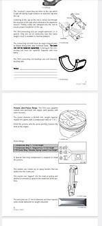

    Yeah forged pistons need to have bigger tolerances simply for the expansion so I guess stock tolerances aren't that relevant in that case. Specs could help someone else though.
    Found the specs

    The bore is 87mm and the stock pistons are 86.965mm. I'm still looking for the spec sheet but I have this so far.
