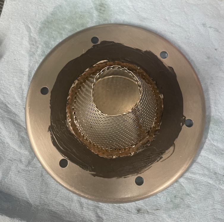

        I think what I did on mine was put a thin layer of Yamabond 4 on each side. Can't go wrong and now it'll never leak!

          Did the same with Corteco EVO300 silicon sealer. Small layer on each side and faced the ridge towards the cover. Going to let it cure for about 24hrs and then refill the oil and test. Appreciate the help.

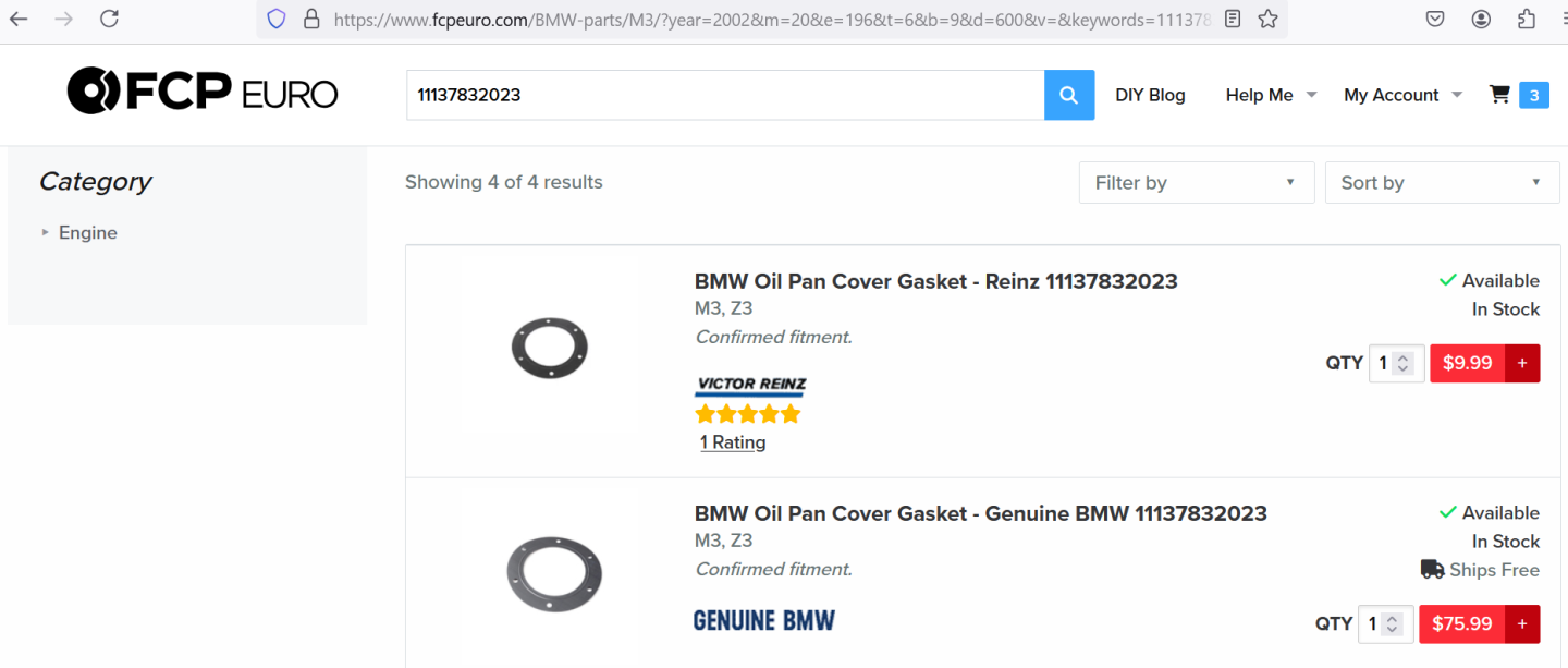

                      What's up with the price difference on the 2?

                        "OEM" tax

                          Yeah pretty common, be sure to figure out if you need the large one or the smaller one, there’s 2 versions.

                            Since this is an easy gasket to get to if it were to leak, the Victor Reinz gasket should be fine.
