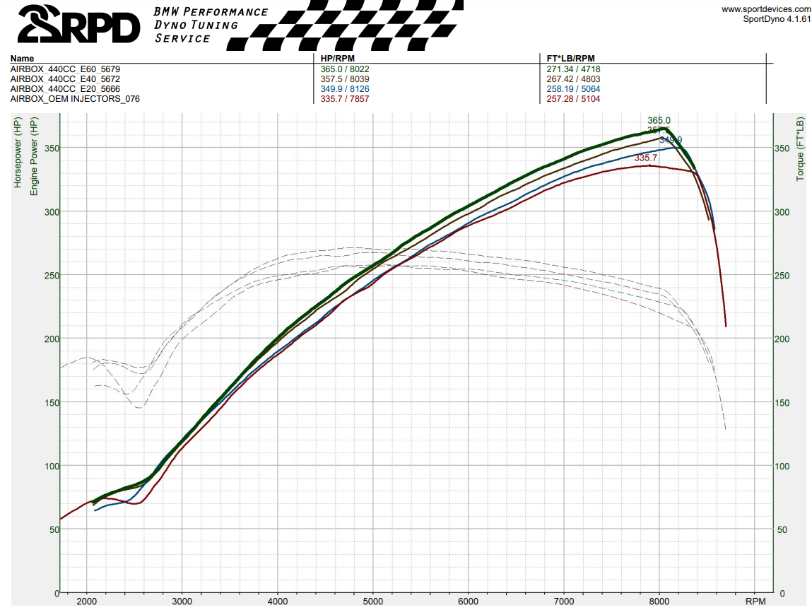

    I've been tuning some flex fuel turbo cars for a while, but we run big injectors. I did a stock injector flex the other day and its way out of injector for ethanol, it actually surprised me how bad it is.
    So heads up if you're stock injectors and ethanol you are way out of duty cycle. (I guess unless you only make like 275whp?)
    anyway heres some data for your consideration, this is a stock engine, high mileage, ebay headers, a turner box, and some muffler.
    It's tuned and makes 330whp. It's been running this way for a few years I think we did the box and tune back in 2021.
    Before we switched to e85 I logged injector time and look at the graph below at 330whp it peaked at 83% duty. For reference most people say 85% is the limit.
    I also uploaded the data here also if you want to look at it yourself, Excel.
    Then re-tuned it on e85 with big injectors and made 365whp. Pretty nice.

      Yeah id say 100%.
      83% duty on e10....
      e30 needs 13.9% more fuel. (you get that from stoich: 12.9/14.7)
      so unless your goal with running e30 is only to make 290 whp (Which we make more than that on completely stock cars with just a tune) youll need more injector. Forget cams and mods.

                Now im curious.. let's double check my data, and sort of weed out the injector clogged theory, with some math.
                Simple question.. What's the required fuel flow on e85 and pump to support 400bhp?
                To calculate the required fuel flow for an engine, we can use BSFC... I'm not a huge fan of this, but since we don't believe logged data lets try it..
                Fuel Flow (in lbs/hr) = Horsepower x Brake Specific Fuel Consumption (BSFC)
                Typical BSFC values:
                • For gasoline (pump gas), it's around 0.5 lbs/hp/hr
                • For E85, it's typically higher due to the higher fuel consumption, about 0.65 lbs/hp/hr
                Let's calculate the required fuel flow for 400 brake horsepower. or 320-340whp depending on your desired loss rate.
                For gasoline:
                Fuel Flow = 400 hp x 0.5 lbs/hp/hr = 200 lbs/hr
                To convert this to cc/min (a more common measurement for fuel injectors), we'll use the fact that 1 lb/hr ≈ 10.5 cc/min. Therefore:
                Fuel Flow = 200 lbs/hr x 10.5 cc/min = 2100 cc/min (350cc/injector)
                For E85:
                Fuel Flow = 400 hp x 0.65 lbs/hp/hr = 260 lbs/hr
                And converting to cc/min:
                Fuel Flow = 260 lbs/hr x 10.5 cc/min = 2730 cc/min (455cc/injector)
                So... we know the factory e46 injector is 268cc @ 3bar...
                Let's calculate the new flow rate at 5 bar.. here's the math:
                New Flow Rate = Old Flow Rate * sqrt(New Pressure / Old Pressure)
                New Flow Rate = 268 cc/min * sqrt(5 bar / 3 bar) = 345cc/min
                345 cc/min at 5 bar of pressure.
                In summation:
                The s54 injector flows roughly 345cc, and calculated fuel needed for 400bhp (320-340whp) on gasoline is 350cc per injector. This calculation paired with the collected dyno data above I believe is enough to stop guessing. The factory injectors aren't enough or your car needs a retune because its suboptimal.
                One last calculation, we know to run 400bhp on e85 we need 455cc/min injectors.
                How much power can we make on e85 and e40 with stock injectors?
                We will ignore the fact that we would hope to make more hp on e85...
                Total fuel flow = 345cc/injector x 6 injectors =2070cc
                And converting to lb/hr:
                Fuel Flow = 2070cc/min / 10.5 cc/min = 197lb/hr
                Lets calculate power for e85:
                Hp = 197lb/hr / 0.65 lbs/hp/hr = 303bhp
                Lets calculate power for e30:
                Hp = 197lb/hr / 0.62 lbs/hp/hr = 317bhp​
                So... yep... the dyno data and my statements are spot on to the standardized math... Someone else run a testo log on a dyno and post the hp, rpm, and injector opening times.

                    440cc @ 3 bar or 560cc @ 5 bar.
