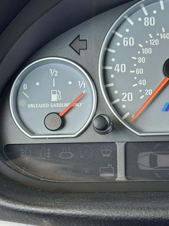

    I have bee.n running the secondary fuel pump for past two months and I must say it works great 👌 no more fuel starvation on long sweepers and best part no need to refuel as often can even run below quarter tank now, but I’m stuck on one thing, the fuel gauge reading is not accurate, the highest it will read is (see picture) when tank is full
    I have tried clocking the fuel pump several times different directions and this is the highest fuel gauge ever reads this is what I’m at now

      I am having the opposite problem after I had a BMW performance shop install - the level doesn't go below 1/4 tank. Ran out of fuel at the track.
      My local shop just said that the sensor becomes quirky.
        Having the same issue, tried clocking the pump multiple times, same result.
          I followed BW's directions and have the same issue.
            Same. Very annoying.

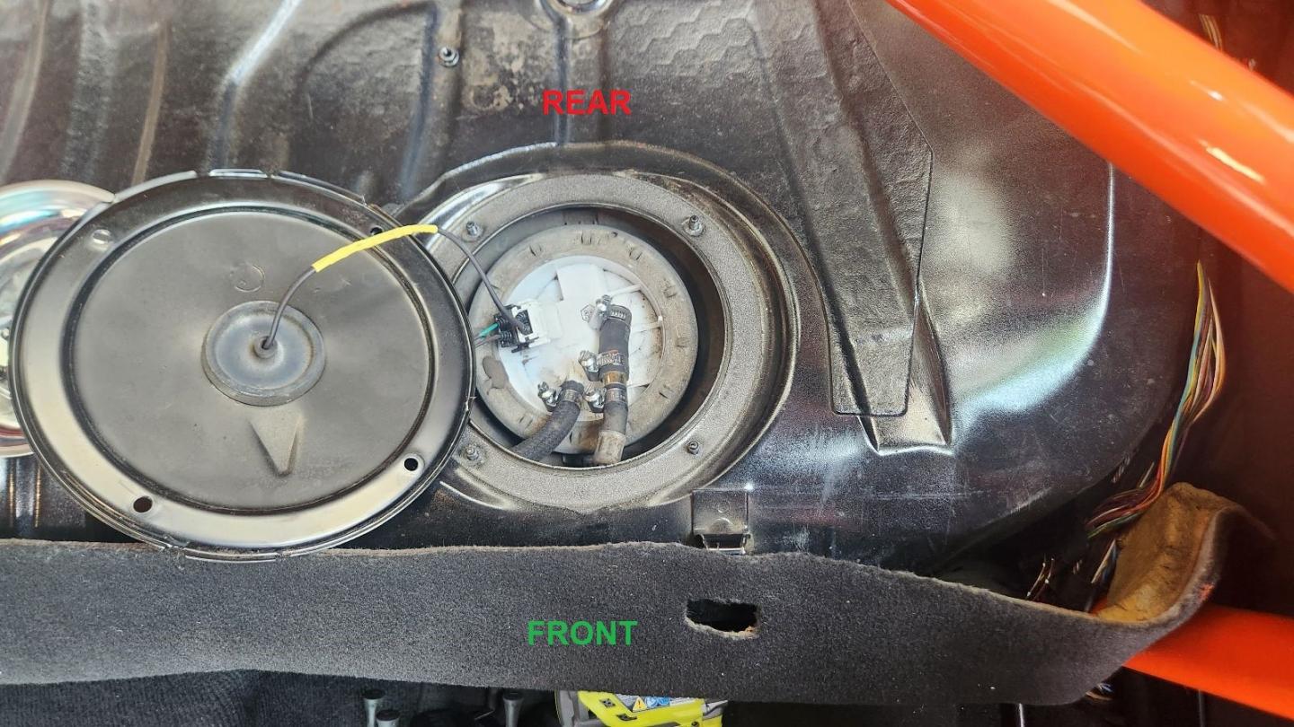

                        This is the orientation of the new fuel pump, which seems to be the same as BW and buildjournal. I am assuming that the fuel sensor signal comes from this new unit.

                        My shop ordered the kit, so I did not see what the new wiring to the black connector looks like (kit includes a black connector with 2 green wires), but in the BW and buildjournal pics, the black connector should have 2 green wires, not black and green.

                        Are you willing to take a picture of both your fuel pumps to see the orientation/position of the E46 (passenger side) and E36 (driver side) pumps?
                            Next time I take out the seats ill snap a pic. I can't get to that area with the seats in the car as I have a roll bar and an X brace.

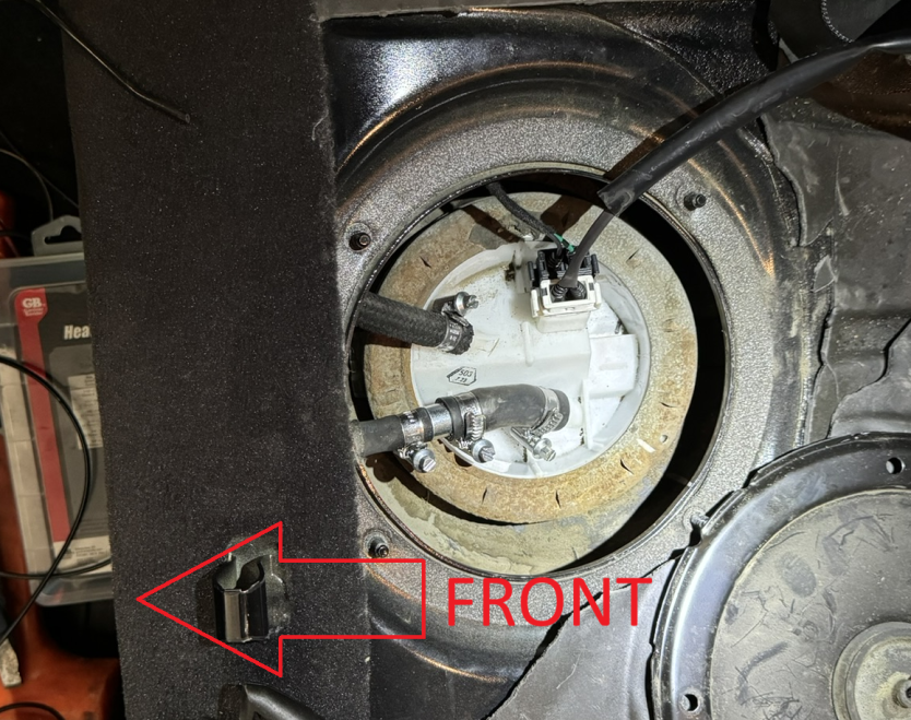

                              Just reporting in another data point: I installed the kit per the instructions and the fuel gauge seems to work correctly. Full reads full, and I ran it down to 1/4 tank indicated with no starvation issues. I attached a scan of my instructions in case it is useful.
                              Orientation:
