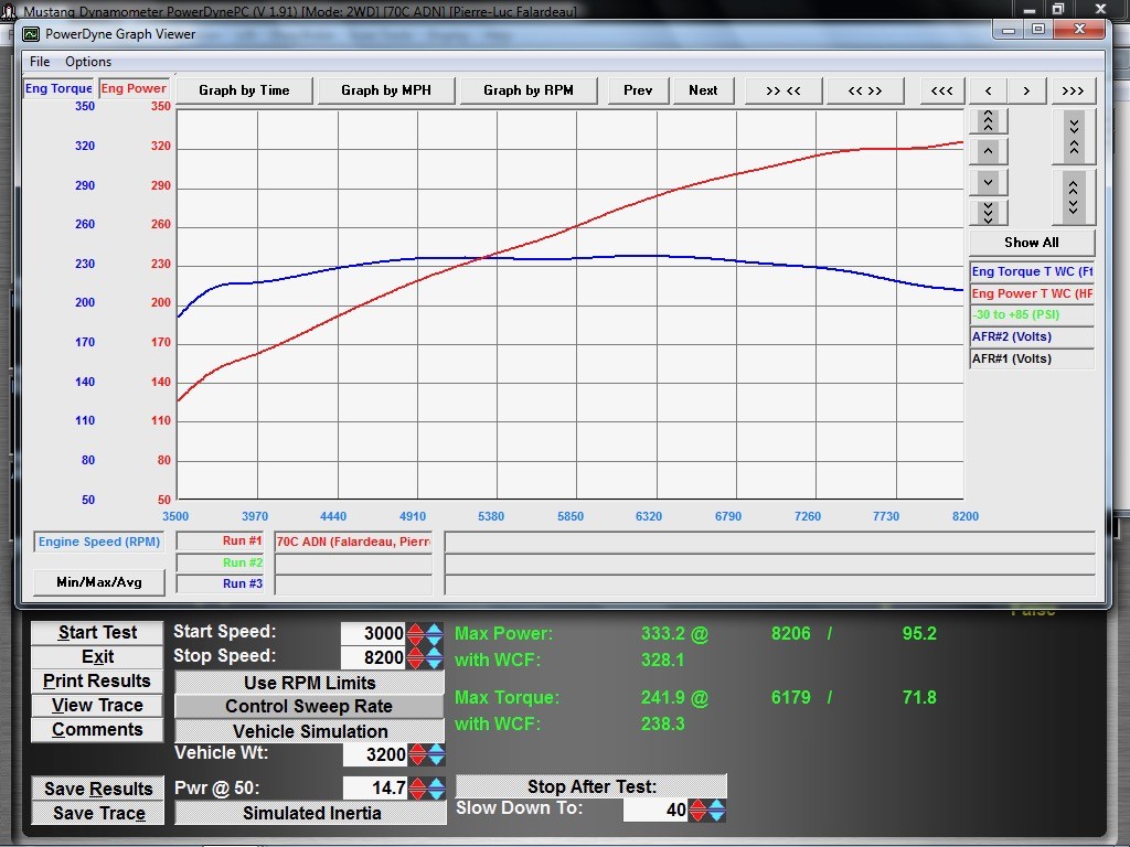

                      Ok so here are some news about my friend’s car I had 2 months ago. His tuner worked on the tune after my feedback. What I didn’t knew is it was just a base map to get the car working with the CSL airbox but nothing more. So last month he spent some times tuning it for real!
                      My friend went to do some dyno runs with the car couple days ago. The car has a Turner CSL airbox, Euro headers, Euro cats section1, single 3’’ Supersprint straight section 2 and a SS Sport muffler. And an Alpha-N tune. Here are the numbers, seems like a healthy engine to me
