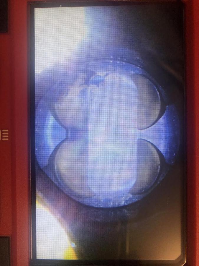

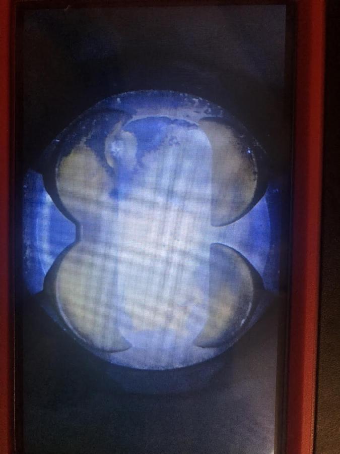

    So obviously, cylinder 4 being low compression is not good. I am absolutely baffled at what caused this because I baby the car, hardly redline the damn thing, and drive it basically like a grandpa and only rarely. I started to think it was possibly my injectors when it was missing, which may have caused too much or too little fuel.
    But now I am not sure what happened. I guess best case scenario at this point would be an issue with the head, like a bent valve or seal somewhere, but I really have no clue what to expect.

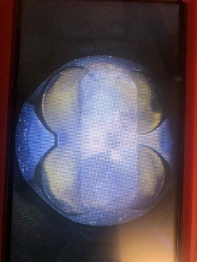

    I peaked into the cylinders and found cylinder 3 damp with what seems like fuel, which adds up because the plug was also wet with fuel. Cylinder 4, piston looked dry like the rest. I was not able to get my boroscope to see the cylinder walls, so I'll try that next.

    Cylinder1:

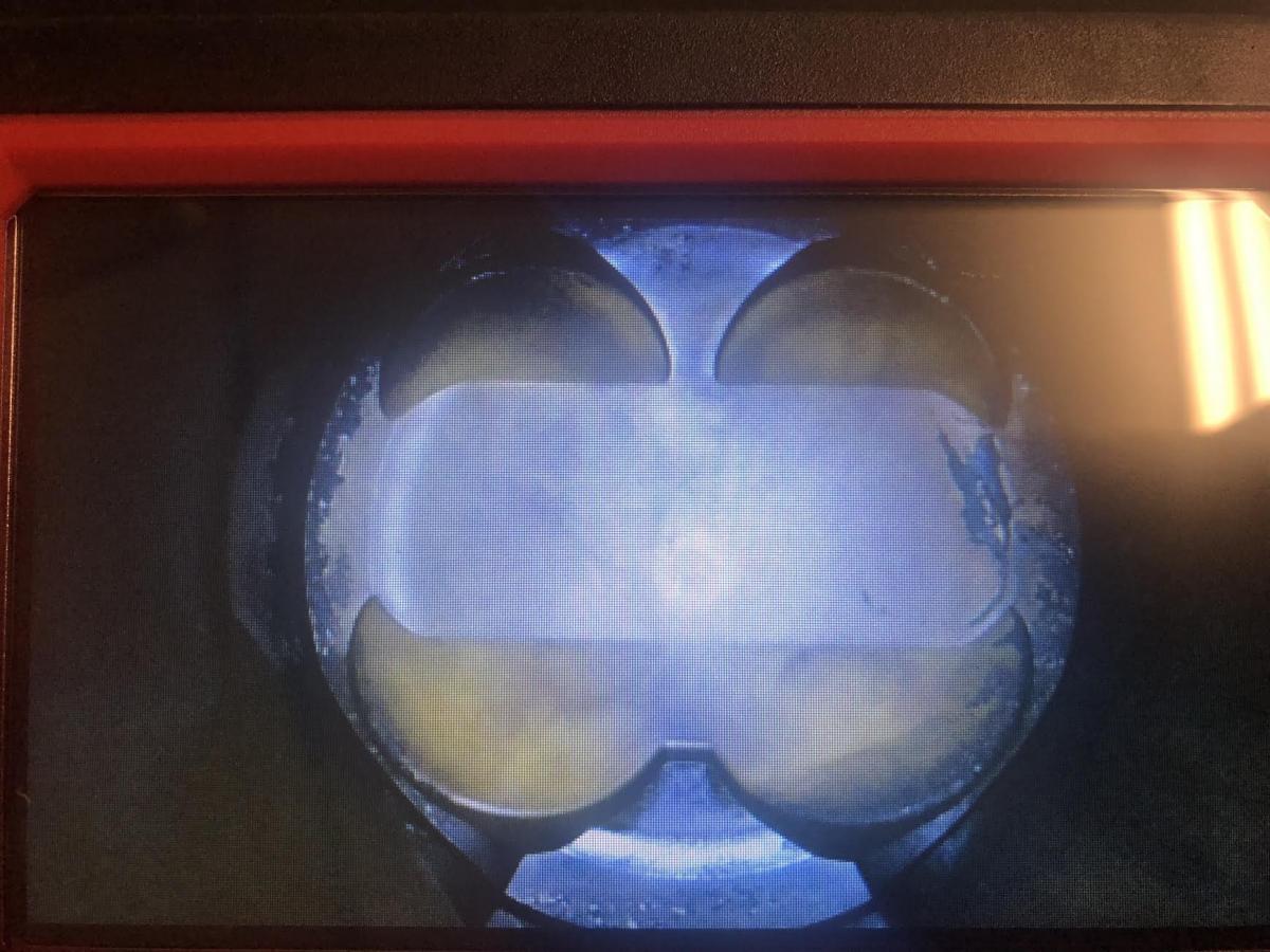

    Cylinder 2:

    Cylinder 3: (wet with fuel)

    Cylinder 4: ​​ cylinder with low compression

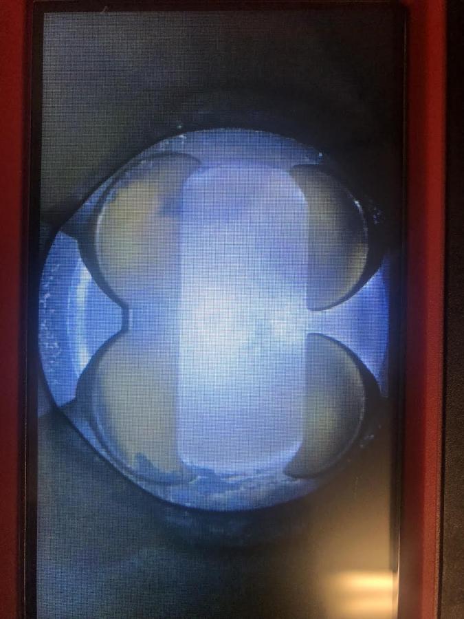

    Cylinder 5:

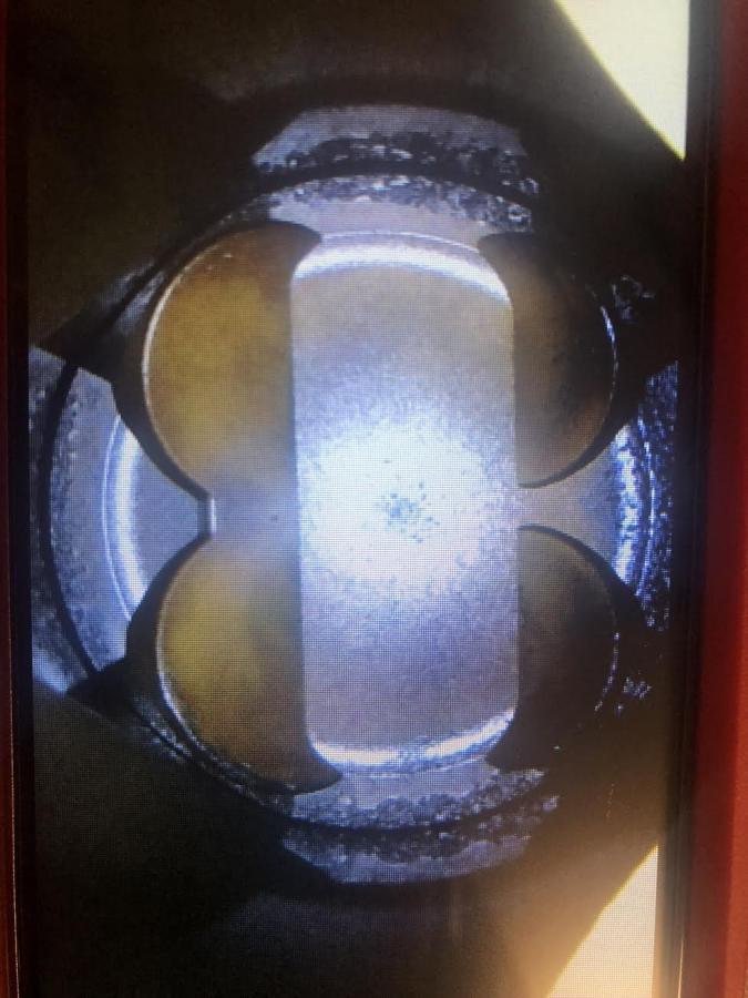

    Cylinder 6:

              I wouldn't worry about Blogs low compression, as engine was running perfect one month before. I think low compression was due to wash-down by raw fuel from misfire. Add a spoon of oil in Blogs and run compression again.

                agree with this. If that cylinder’s oil coating was washed away it wipes out compression.
                I wouldn’t overly worry until you’ve tried this oil test.
                  My buddy recently restored compression to a cylinder on a S85 with transmission oil, cylinder had been washed by a leaky injector.
                  It most definitely can work.

                    Don’t quite understand though, cylinder 3 is the one wet with fuel, cylinder 4 was normal. My misfire was on 3. Low compression on 4.
                    So you guys are suggesting add a spoon of engine oil to each cylinder and re-do the compression test? I was under the impression that if I re-do the compression test with oil added to that cylinder and it goes up, that would indicate a bad piston ring. Is this not the case?
                    I suppose all of this could be traced back to a bad injector I would presume, and perhaps caused by the car sitting with ~6 month old fuel.
                    Current:
                      Also, would you suggest adding the cold oil to a cold motor and do a cold compression test or do this warm?
                      Current:
                        Ok, yes, that makes sense what you said. I read that wrong.
                        it’s definitely still worth trying the oil trick. I’d do it at whatever temp you had the engine before so you an apples to apples comparison.
                        The caveat is that if you have a failing injector on cylinder 3 I’d get that replaced before starting again. Sadly, they’re like $450 a pop at the dealer now.
                        but you don’t need to go tempting fate with a leaky injector.
