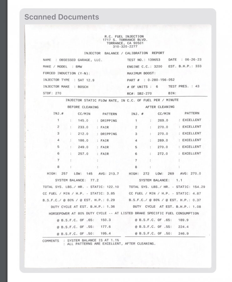

          An update on my Injector testing... here were the results. Any thoughts on how this corroborates with the symptoms in this thread? Cylinder 1 and 3 were dripping, the rest were in "fair" condition. Cylinder 4 was the one that had low compression...still kinda doesn't add up.
          Does anyone know if the ECU averages out the fuel injection across all 6 cylinders or is it read per cylinder?

          Current:
            #35
            It probably averages per bank just a guess though
              #36
              That could make sense, in that it compensates for other cylinders the ones that were dripping or spraying too much.
              Current:
                #37
                It’s read per bank. There’s only two oxygen sensors. One for the front bank and one for the rear. Changes are made per those sets of cylinders.
