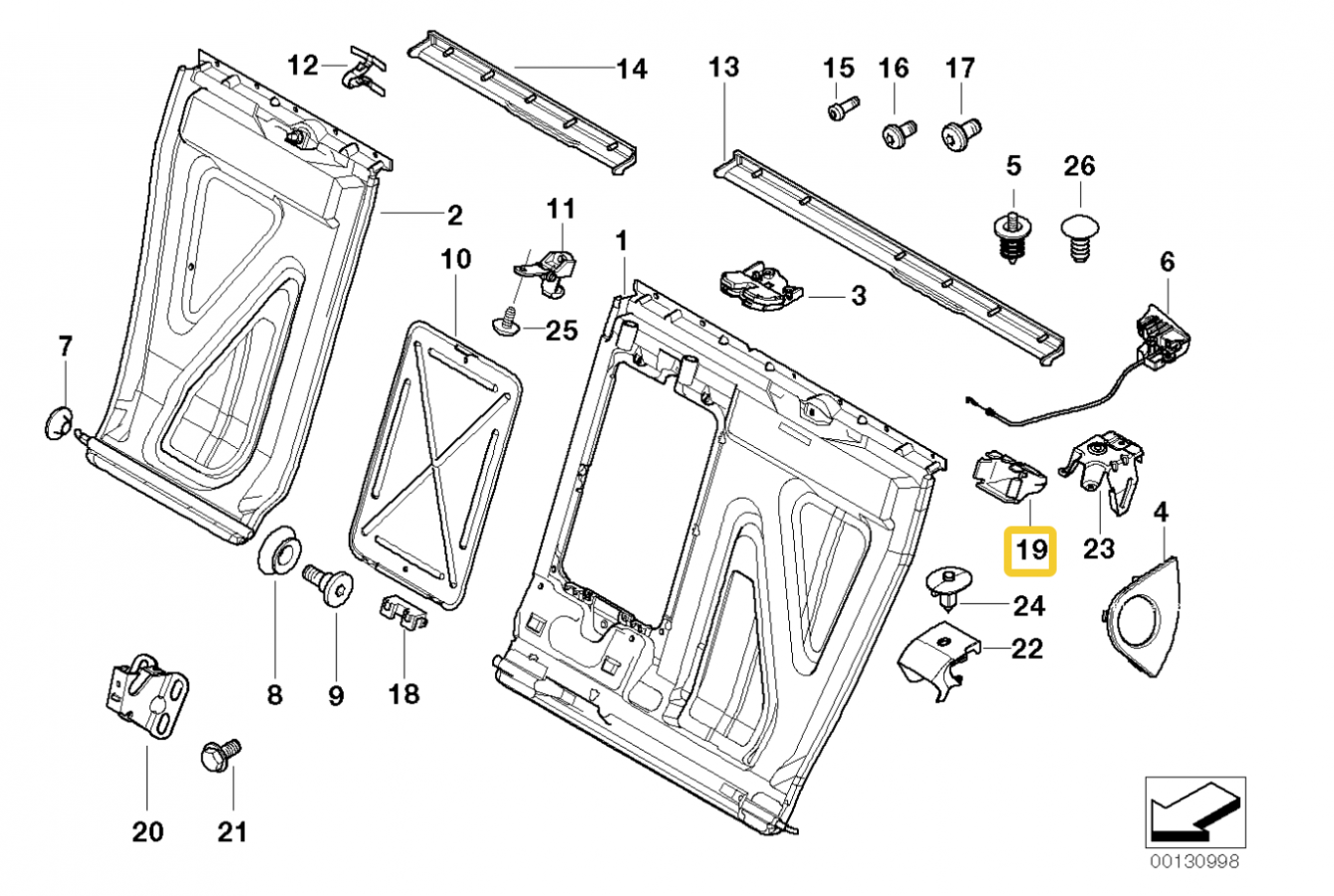

            Is the part number for that clip 52208099555 ?​ Asking for a friend.... πŸ˜…

                  Yes, but that's a pack of them. The individual piece is 52207157536
