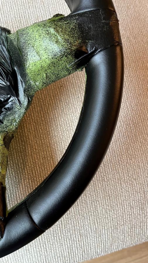

    This won’t be an actual DIY, rather to document that I will give it a go and redye my steering wheel, which is in good condition except for one area where I screwed it by using a magic eraser. This is at the 4-5 o clock on the wheel.
    This the area I rubbed color off​
    Click image for larger version  Name:	IMG_0072.jpg Views:	0 Size:	93.1 KB ID:	223158

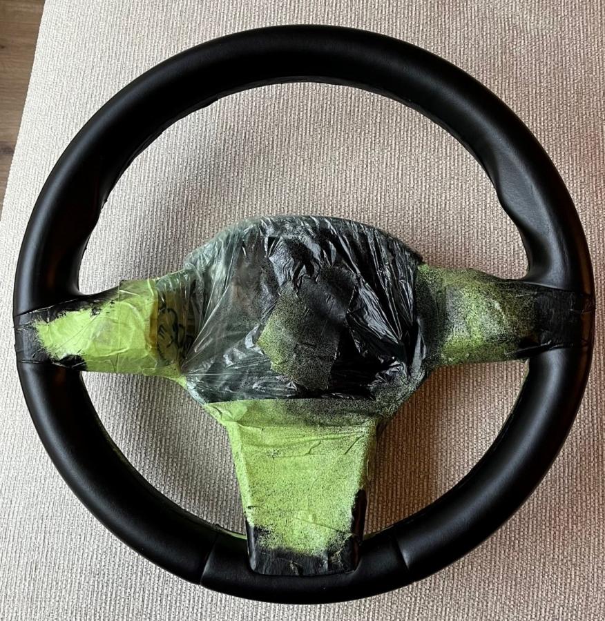

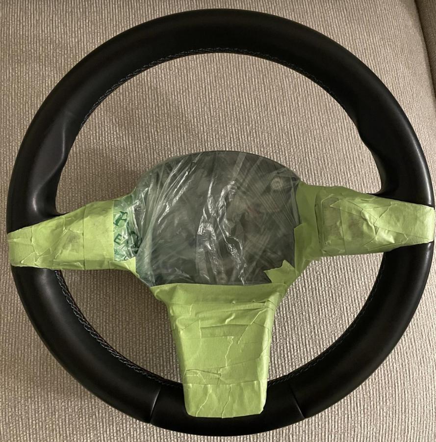

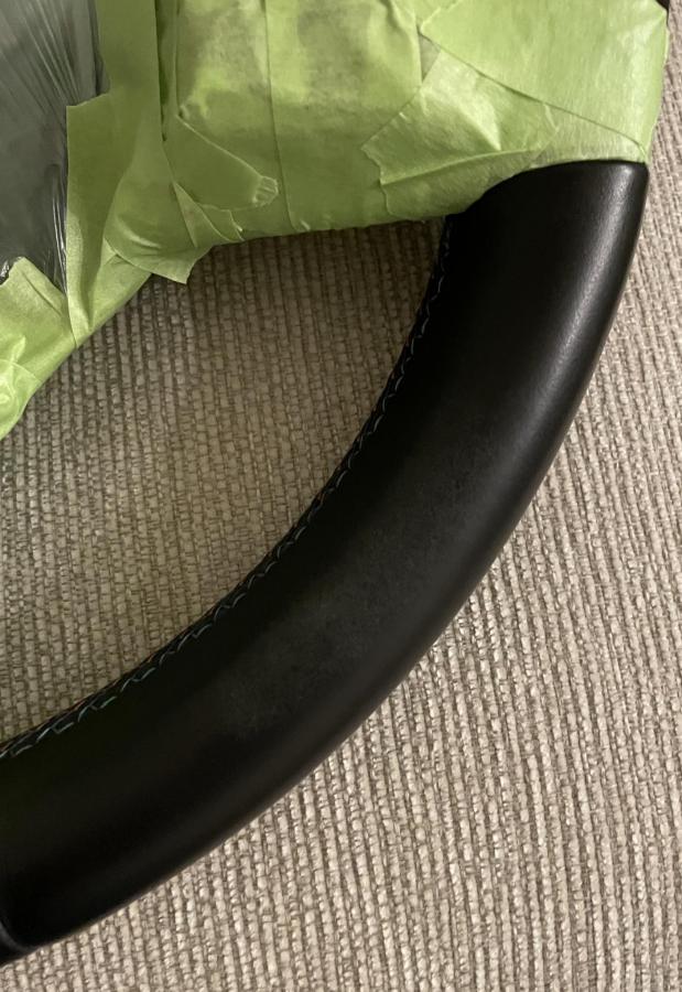

    The wheel is now masked for:
    Cleaning
    Sanding
    Cleaning
    Painting
    Clear coating​
    Click image for larger version  Name:	IMG_0071.jpg Views:	0 Size:	149.6 KB ID:	223159

          My wheel was actually a 9 but I was too aggressive cleaning and screwed it. So I don’t have to sand it.
            I have cleaned the wheel using the following method
            So far...
            0. mask all the areas you don't want to dye on, I used my finger nail to get the tape in all spaces between the switches and rim. my wheel trims are new, and do not want to screw them. Since I want to preserve the tri-color stitching, I will be masking this as best as I can.
            1. used dish washer and sponge to agitate all dirt and dried with paper towel
            2. Using isopropyl alcohol I wiped the wheel, this will removed a bit of dye, as the paper gets black, however, if cleaned again with dish washer and dry, nothing comes off.
            3 I repeat the two steps above twice
            Next...
            4. clean the wheel with the prep solution, which is a water based solvent, this is coming from magic mender.
            reserved for pictures
            5. mix dye with the crosslinker, one crosslinker bottle is good for 5oz of paint, so I will only use half of it with half the paint. the other half will be for the top coat.
            6. spray on thin coats, I plan on doing 2-3 coats, and use a hair drier between layers to expedite the process.
            7. mix top coat with the crosslinker, here I will rinse the container and clear the sprayer, I may juts get another sprayer to avoid screwing things up.
            reserved for photos
            8. spray on thin coats
            reserved for pictures​

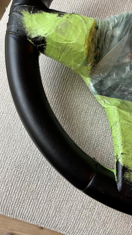

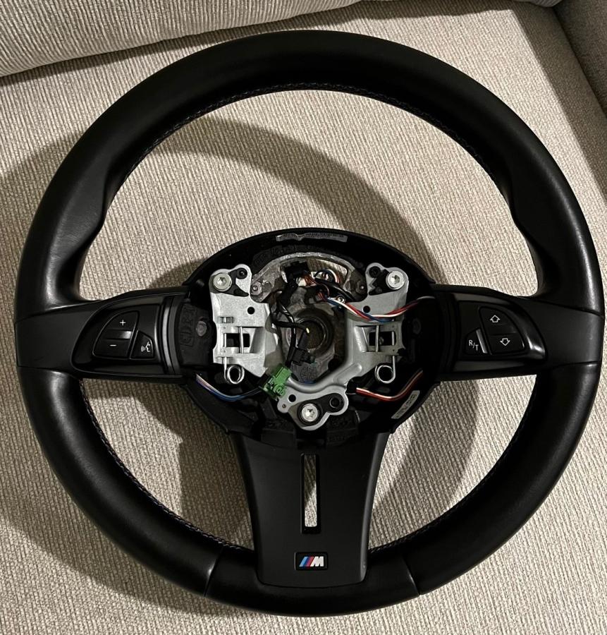

              This is how the wheel came up. it is not perfect, but better. I think the two main things I would have liked to be different are the color, a bit "blacker" than OE, and the shin, I should have selected matt.

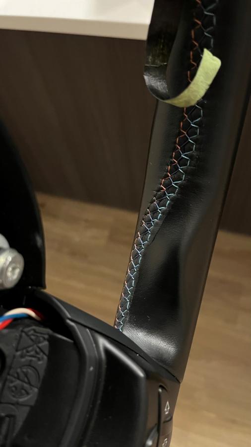

              And a few close ups
              I am not sure I will leave it as is, since I want a 9/10 status for most things, and these wheel are still available, i may end up buying a new wheel, so this will be up for sale for anyone that is interested.
              BTW, the switch trims are new, so the wheel as is is very nice, just not perfect.
              These wheels fit E46, but you would need the cruise control stalk to retain that feature​ as the Z4M wheel doesn't have the CC button on it.
