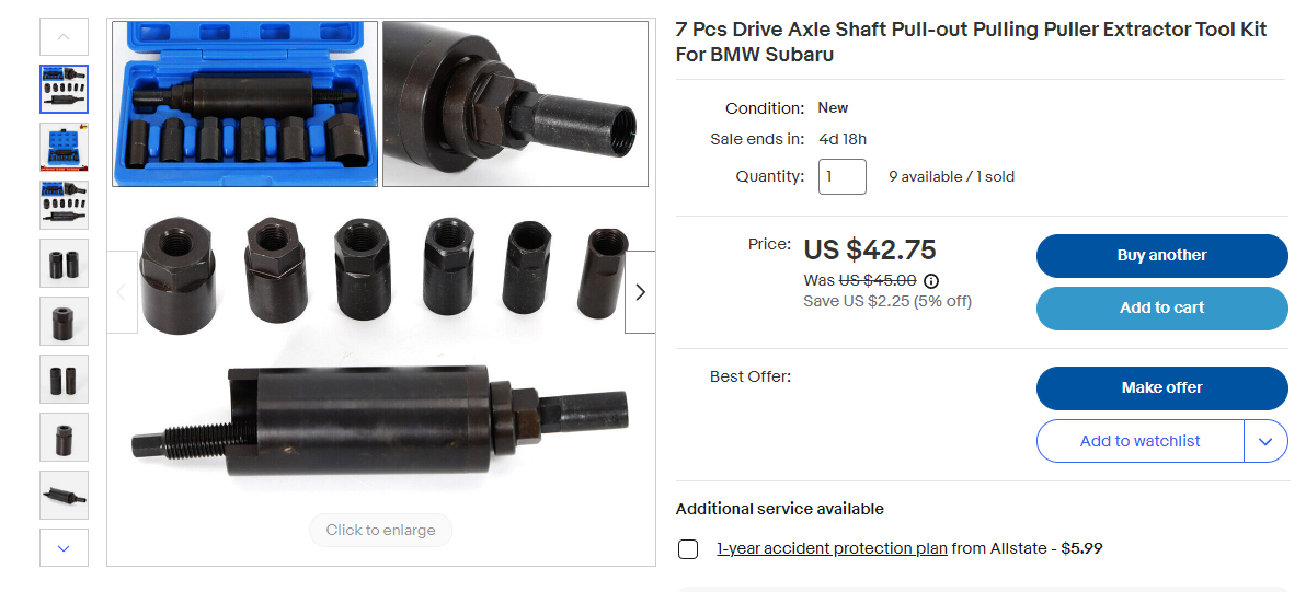

        I did axle work on my e46 and f80 over the last month. Both the jobs would have been nearly impossible with muscle or a hammer. Just save yourself the hassle and order a shaft pull tool. 40$~ on ebay. Will save you lots of annoyance.
