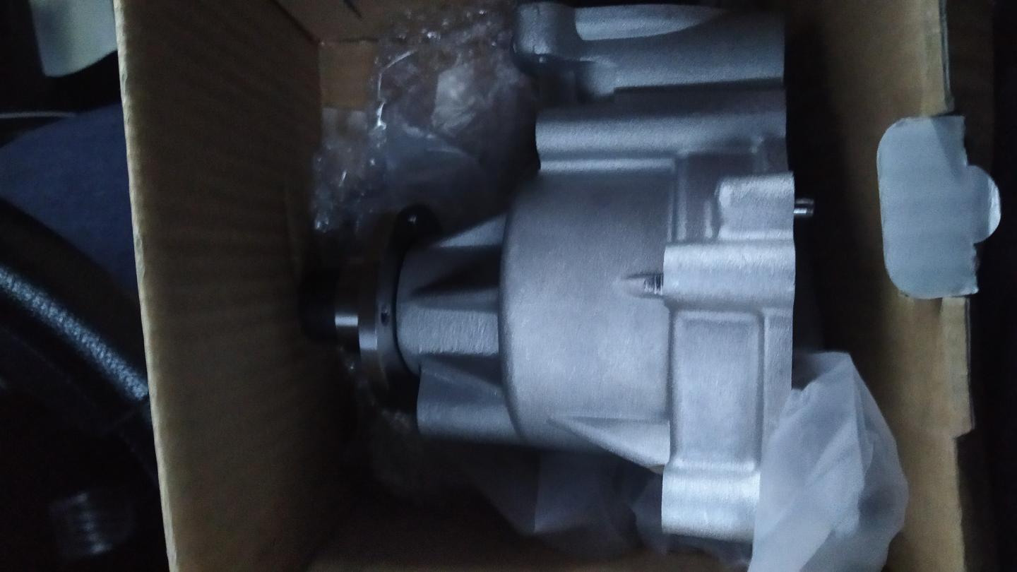

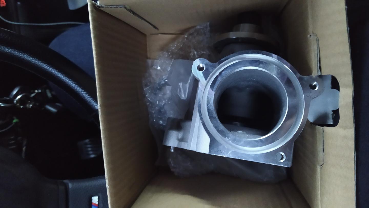

        Also is mishimoto even good? honestly atm i don't even know, i installed mishimoto electric fan with it's relay kit, along with new water pump and new thermostat and when i do good 2 pulls it's almost getting to overheating temps but i use heater or full blast on to keep temps down, my engine is healthy NA, headgasket is ok, thermostat is borgwarner brand but water pump is not oem, it's made in Spain so idk about quality of it, probably i should have waited for oem pump... since i removed my fan clutch and renewed my cooling system it got even worse than it was before, im trying to determing which part is causing overheating, if it's not oem pump or mishimoto.
        i would appreciate to know your thoughts on this
        side notes: i do run TMS 3 pulley kit which comes with bigger water pump pulley which i guess also has some effect on pump performance, i also have front aux fan which seems to be not working even tho i turn AC it's always off, turning AC in traffic also tends to raise temps as well
