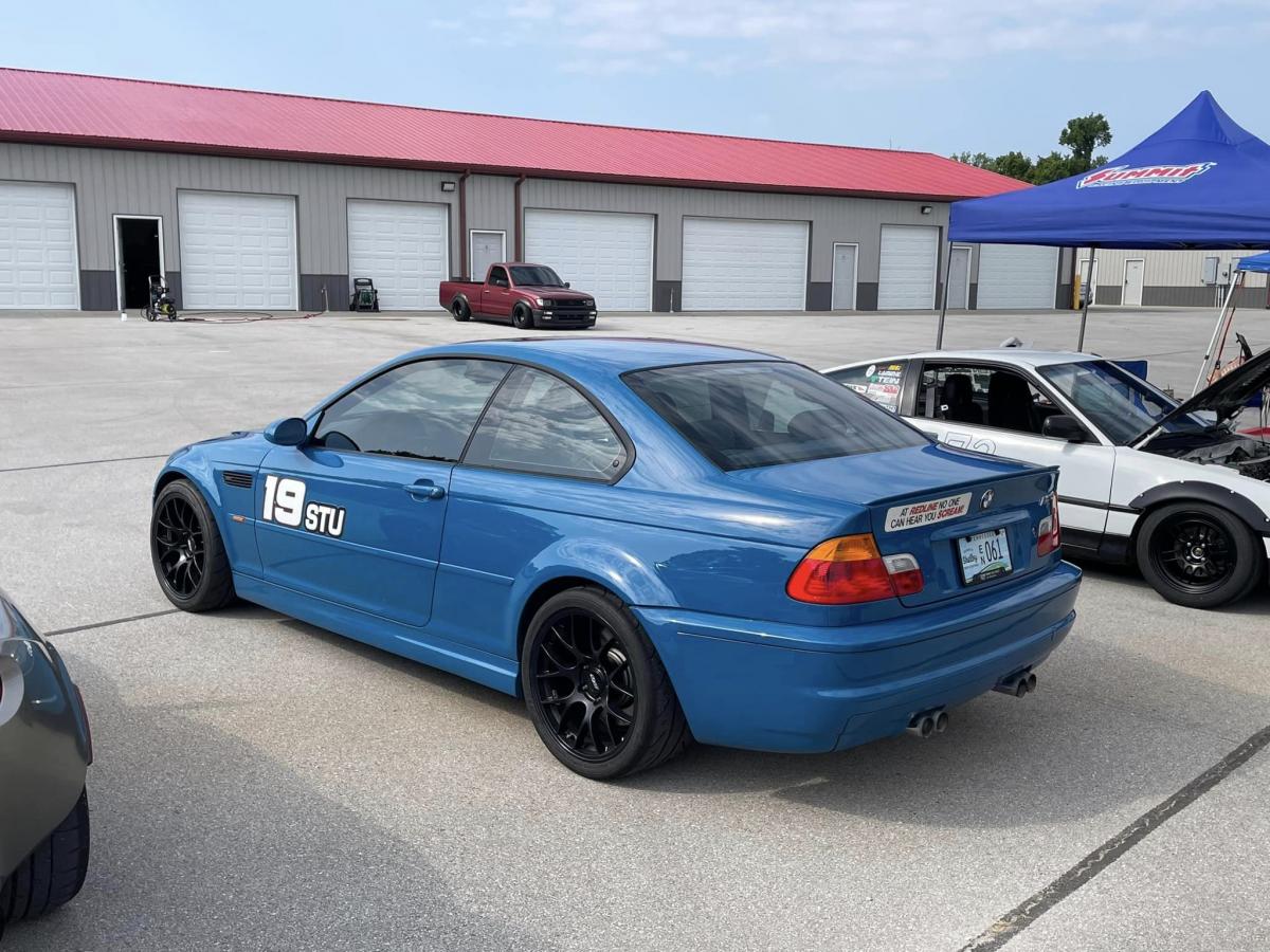

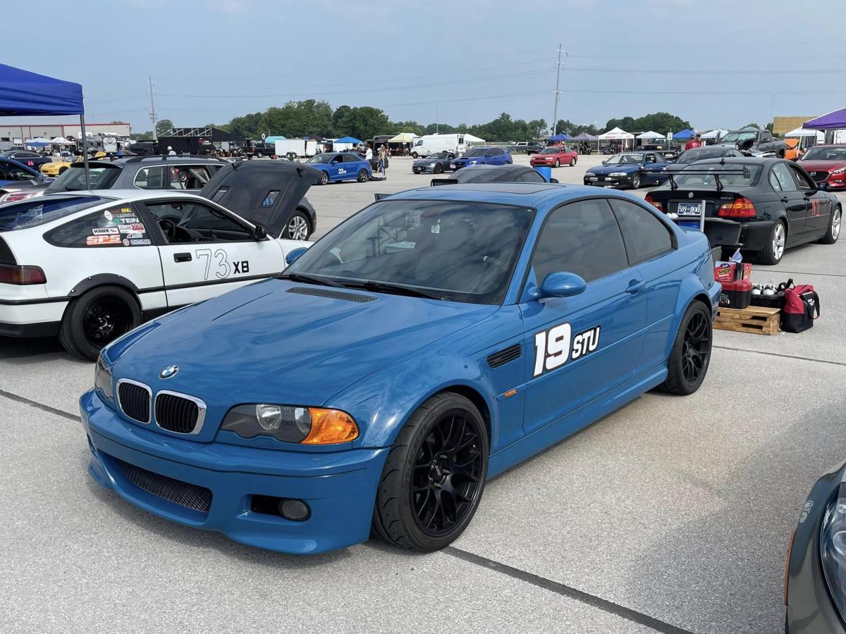

    Here is mine on Dinan/Konis, with dinan fixed front camber plates, and 18x9.5 +35 square EC-7s with 15mm spacers in the rear. These are 25" tires (255/35/18 front + 285/30/18 rear) so the gap you see is closed up with more normal rubber (factory sizing is 26"). Personally, I think the drop is perfect and I wouldn't want it any lower.

      What camber are you running up front with those plates?
        -2.8 degrees. They can add an additional -0.5 to the standard range of adjustment. Prior to installing these I was at -2.3 with pins pulled.
          Thanks so much. This helps alot.

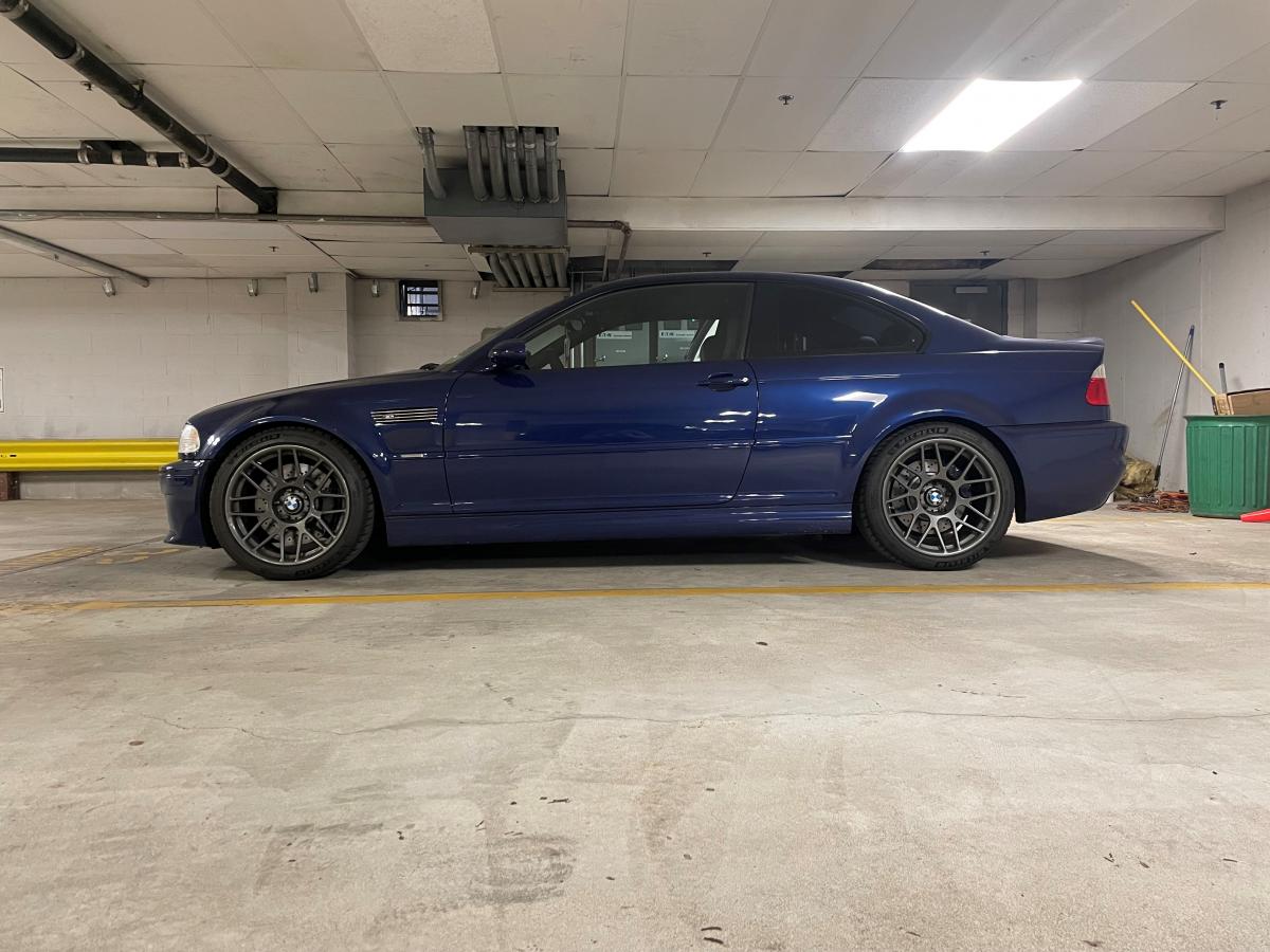

            I was not running ARC8's but BBS's on Dinan/Koni. It's a subtle drop that just slightly closes that fender gap.
              Here you go, Dinan Spings, TCK Koni and Apex Arc8s 18x9F and 18x10R.
              Click image for larger version  Name:	1.jpg Views:	0 Size:	130.5 KB ID:	225089
