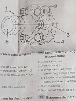

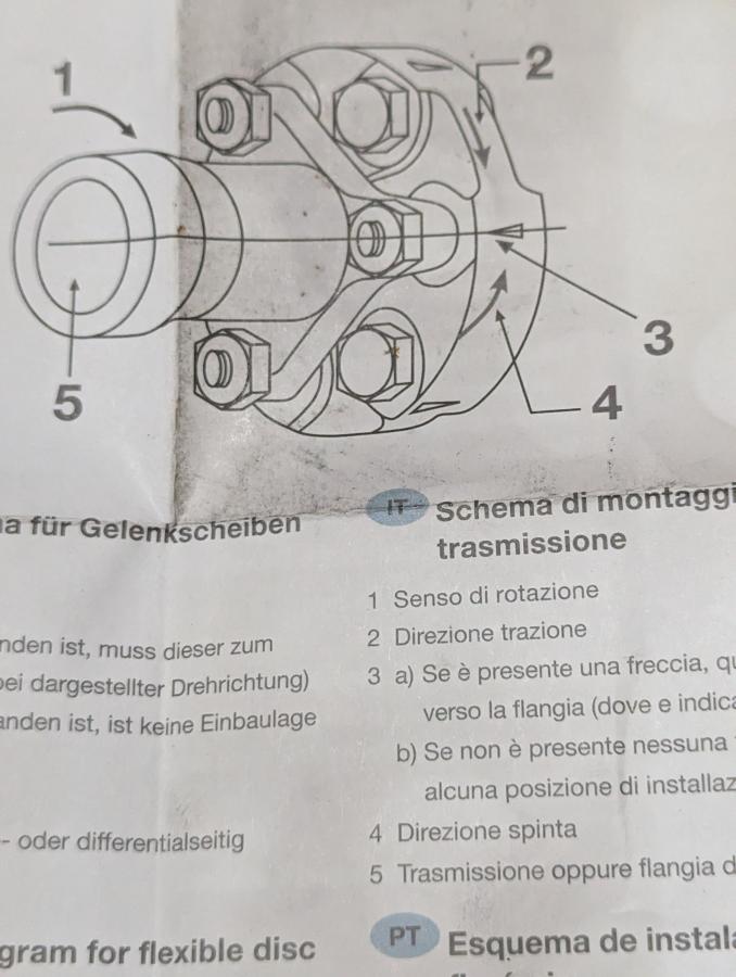

    The instructions that came on my Febi Guibo says to align the arrows with the flange and the bolt should insert from the opposite side. The nut should be on the flange side. At the end, 3 of the 6 nuts and bolts should be in opposite directions. Looking to get confirmation.

      The arrows should point to a flange...bolts can only go in one way.
        Comment on the disc, there is no front/back to the disc, but make sure the arrows line up with flanges, so that when transmission output flange is turning ccw (facing toward front bumper) and transfering energy into the disc, it is compressing the thicker/meatier part of the disc between the holes that attaches to the driveshaft.

          Just for reference:
