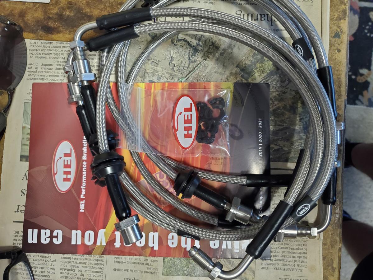

                  #38
                  HEL

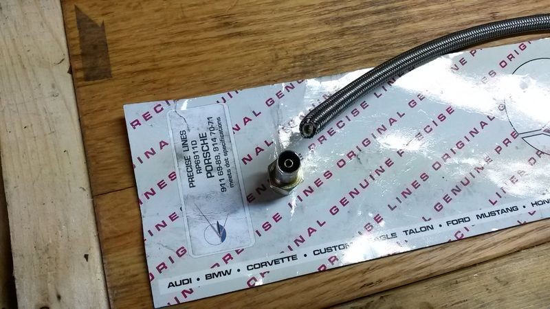

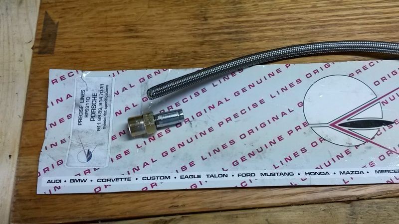

                    I agree! There is some downright sketchy Ace Hardware crap out there.
                    QFT - Visual evidence of shit generic lines from one of the typical parts vendors for my 911. I had installed them and while bleeding this fitting blew off. Bad crimp - I had been careful while installing (didn't twist the line, drop a caliper connected, etc.). Speaking with a few folks I wasn't the first to experience this. I immediately got some goodridge lines and the quality difference was obvious.
