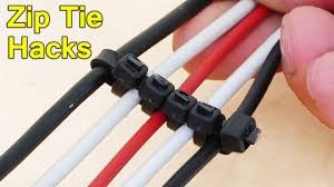

                        I'd go stock too. If for no other reason than they are designed to clear wheels, struts, swaybars and all other potential areas where they could otherwise rub. Rubbing = eventual holes in the lines. I unfortunately learned that lesson the hard way on the race track.
                        Whenever I go aftermarket lines (because BBK), I now always double zip tie to prevent rubbing and completely isolate the line. I then check and recheck suspension articulation, turning the front wheels to full lock, etc. to make sure nothing is rubbing.
                        By double zip tie, I mean something like this pic below. This is 5 zip ties rather than just 2, but you get the idea.
