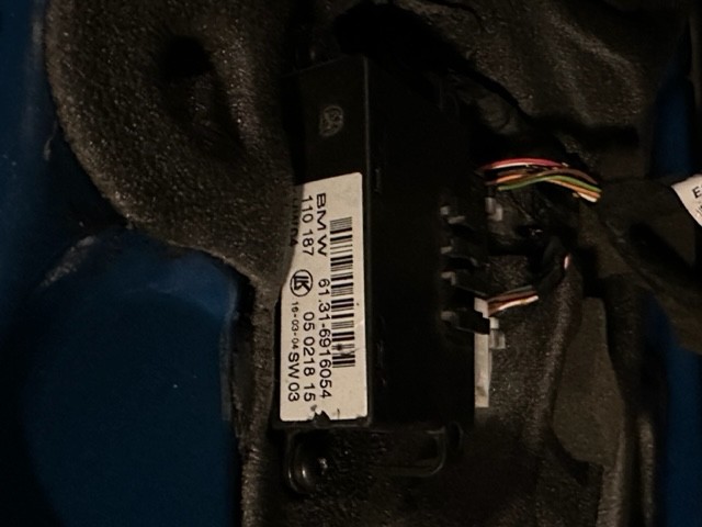

              New switch arrived today. Testing that later. If that doesn't solve the problem, I intend to buy a replacement module that fits inside the door panel. I had taken a picture of this the other day and can confirm the part number. Photo attached.

                  Is there a second module under the passenger door panel? It seemed like there was only the one.
                  Yes, there is another one on the passenger door.

                      Are you familiar with what the module does?
                      My reading suggests it’s the memory module. I don’t have an issue pressing the memory button on my seat and getting to mirrors to return to their saved positions, so I’m not going to mess with these at present.
                        In my 325 wagon, I had problems with both mirror tilt (in reverse) and the direction the mirror would move with the joystick. Seat memory was OK. Replacing both modules fixed the problem. In my case, the mirror actuator was good with the replacement mirror.
