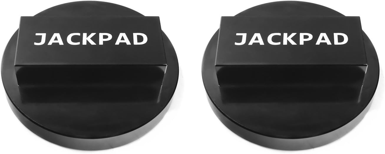

                              I picked up these to use with my floor jack. Seems to help?
