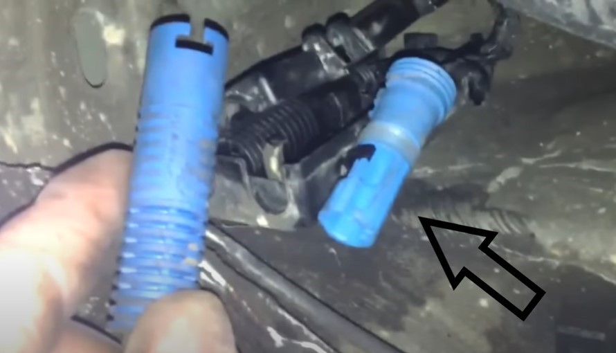

    My 21 year old M3's ABS connectors that are part of the car's wiring harness are (as you can imagine) brittle. Attempting to replace my RF wheel sensor and I must have squeezed too hard and crushed the female connector that inserts into the ABS sensor pigtail. I looked at Realoem.com but didn't see any replacement connectors. Hoping a member here can help.
    If anyone has removed their harness and is interested in parting pieces of it out, I would be interested in purchasing the ABS connector with as much wire attached as possible. I am assuming if one is brittle, they all are so ideally I'd like to obtain the connectors from all four corners of the car.
    As an alternative, if anyone knows the part number of the female connector itself I can go that route and re-pin the new connector. Here is a picture for reference - however not from my car.
    Click image for larger version  Name:	ABS .jpg Views:	0 Size:	60.3 KB ID:	227022
    Thanks in advance for your help.
    Mark
    What build date is your car? Connectors are different between cars with MK20 and cars with MK60 DSC systems.
    If you have an MK60, you'll need 61131392246 for all four corners.
    If you have an MK20, I think you'll need 61131392248 for the front and 61131392246 for the rear. Not 100% sure on this one, but I do know that front is 3 pole and rear is 2, so part numbers sound about right. Should be easy to check though, the connectors themselves have the last seven digits of the part number written on them somewhere. Note that what's printed on there might be an older part number that has since been superceded so look at the part number history on realoem to match them up.
      Appreciate the response. I have the MK60 and the sensors have 2 poles. 61131392246 looks to be the correct p/n.
