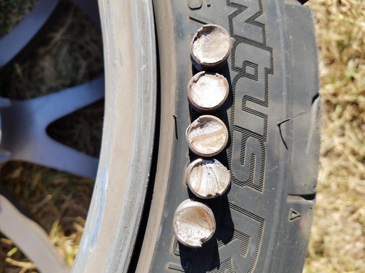

    Just had a Bimmerworld 37mm extended lug bolt fail on me after originally being installed at the beginning of 2022. Went to torque my lugs after a project, and only a few pounds into it, one totally let go.
    Car is tracked several times a month, had ~15 events in this time span, but I never torque hot lugs. I do use my impact when putting the wheels on, but just to zip down until the impact hits one time, then I torque to spec once on the ground.
    Looking to figure out if this is related to something I'm doing, I had a bad lug, or what. Is using my impact to even that one click excessive? Anything else I'm missing? I understand folks replace lug bolts or studs every two years, which was my plan, but I'm guessing I should up that to every one year. For some reason I thought lug bolts would be more reliable than studs, but this seems on par with the stud game, removing "reliability" from the "pros" column of bolts for me.

            Either it is a bad bolt or the spacer is not sitting flush. The inner rear hub can contact those 12mm spacers at the hub centric portion and cause the spacer to not sit flush.
              Check the mounting surface on the wheels too, make sure they are still true to shape.

                Paper test is passing on the spacer to wheel interface on all wheels as well as the spacer to hub (well brake disc). I'm leaning towards bad bolt but don't have any real way to confirm that suspicion.

                    What does a close-up of the failed lug face look like?
