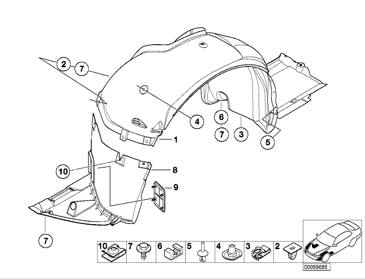

The limiters wouldn't really work here as the rubbing only happens on track. Street driving is fine. Its when the left side is fully loaded compression brings the fender into the tire.
You mention the liner came loose. I also see you’ve got aero (canard, etc.?).
I’m curious about why it came loose in the first place…does anyone using aero reinforce that portion of the body trim? Use different or additional fasteners?
The push pin rivets, while durable, might not be the best way to pinch the trim pieces together. From what I can tell there’s a fair amount of flexibility in that lower corner as a whole.
