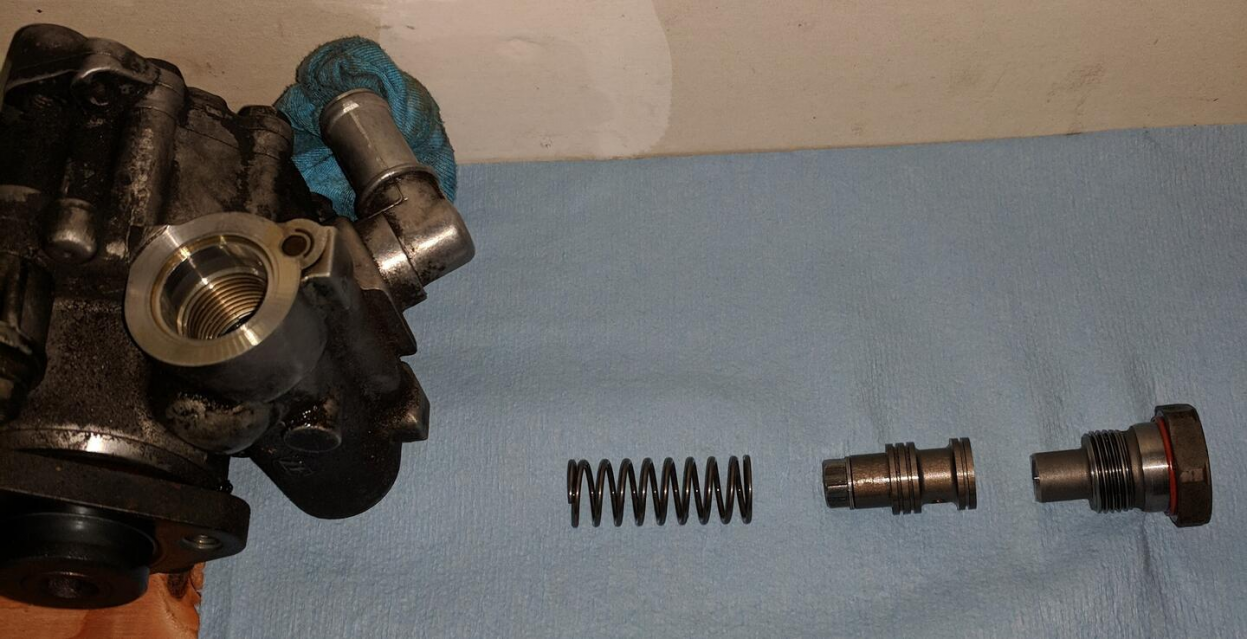

                          I think the pump noise and hot issue is due to the relief valve is stuck and build up too high pressure.
                            I think the pump oil pressure regulator is jammed and built up too high pressure.
                            Follow these steps to remove the regulator and no need to fish out the larger spring below it.

                            Remove the 27 mm hex plug on the pump output.
                            You will need to use an impact or a vise to secure the pump if you’re doing this off the car.
                            Step 3
                            Use a magnetic pick-up to remove the pressure regulator and the spring behind it.
                            Step 4
                            Secure the pressure regulator in a collet vise and remove the 11 mm hex plug. Be careful not to lose the small ball or spring hidden behind it, or any shims that may be on the plug.
                            My instruction: clean the small hole on the 11mm hex plug, ball, small spring, and the inside of the 27mm plug. ​
