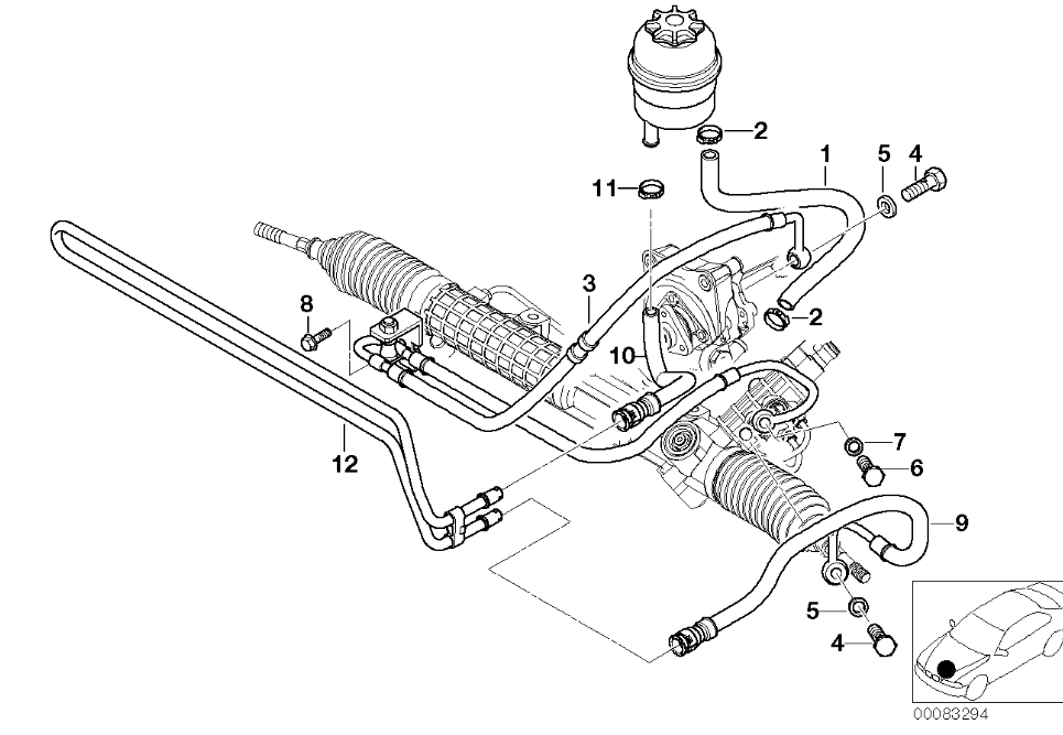

      Originally posted by Jersey_M3 View Post
      "There's a check valve in one of the banjo bolts, maybe try replacing that?"
      you sir deserve a medal. This was indeed the issue. Car is fully put back together now..
      Why a blocking banjo bolt can cause the pump to got hot and making noise, as long as the pump's regulator is working? IOW, none of the metal pipes that clogged can cause the normal pump to be hot.
      Can you point to the said banjo bolt or post a pic?
